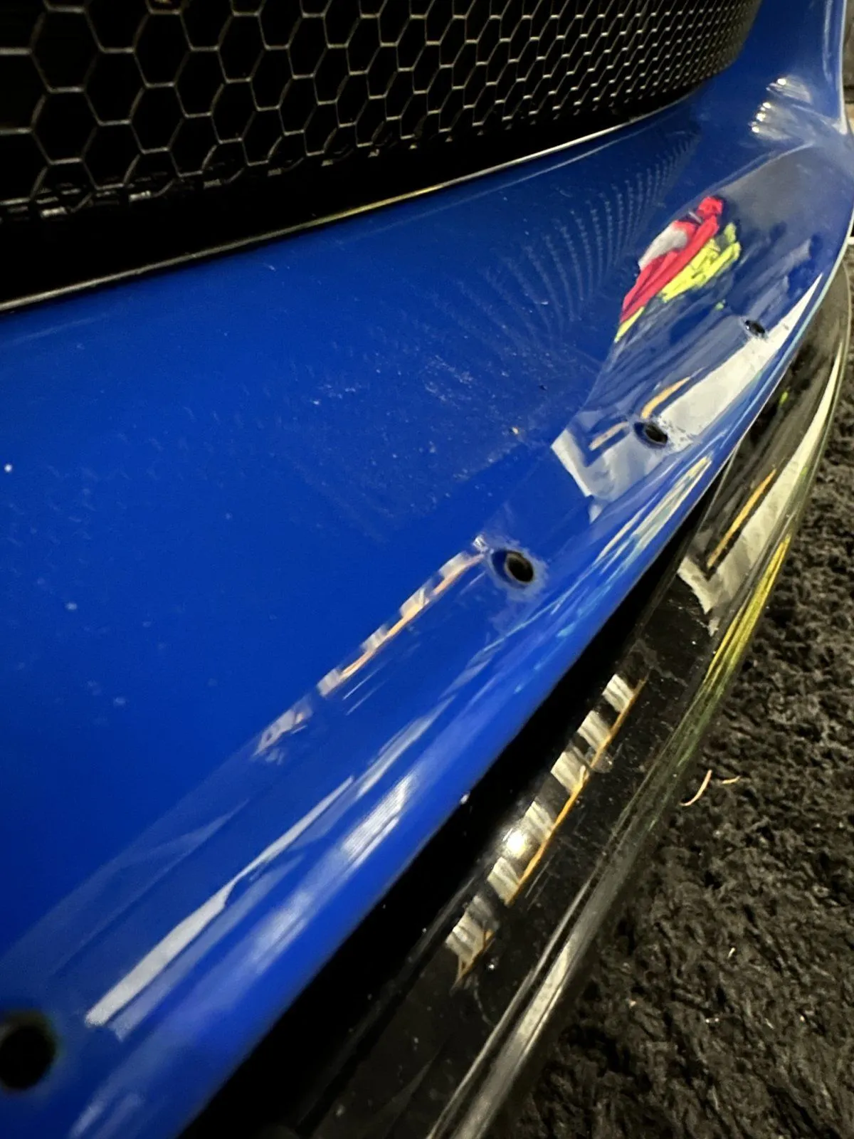

I’ve searched but (surprisingly) can’t find a thread for this. Has anybody seen a USA spec front license plate mount on the Emira? Do they drill into the bumper or not? I’m wondering if a tow eye plate mount would be a decent alternative (see below). Looks like it would probably block one of the forward parking sensors. It would look pretty terrible but could be easily removed and shouldn’t damage the car. If I missed a previous thread please point me there.

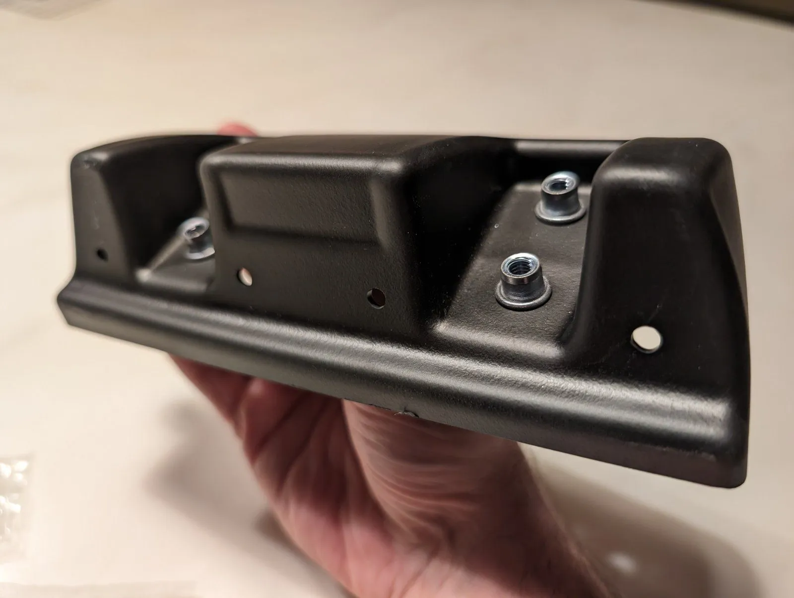

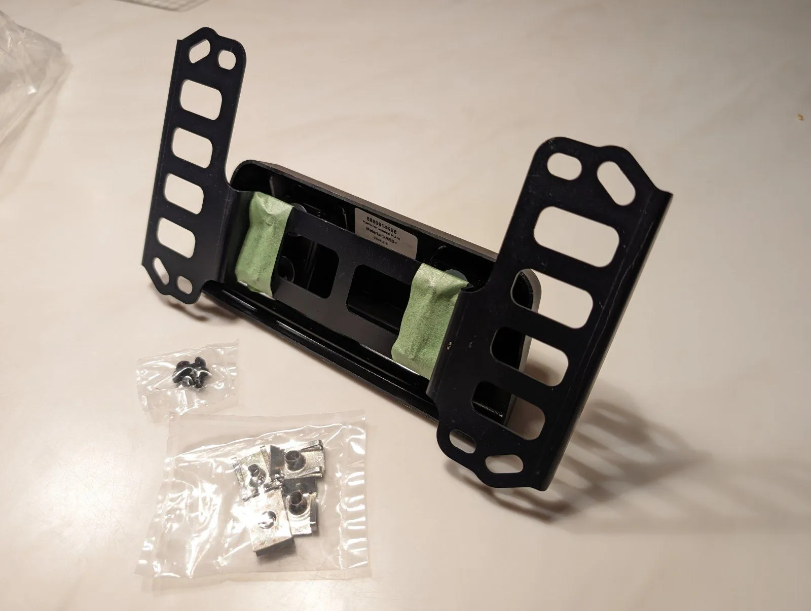

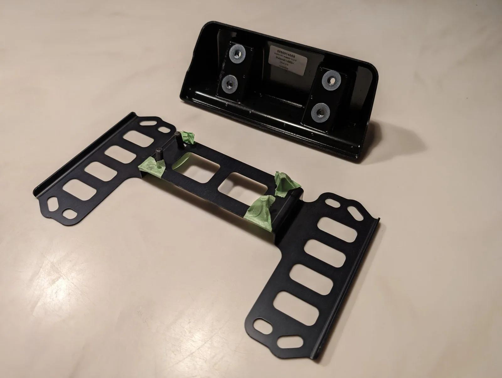

The front plate holder is two pieces, an ABS plastic mount that is screwed into the plastic of the lower bumper with 4 coarse thread screws (creates permanent holes), and a metal carrier plate that attaches to the mount with 4 bolts.
The two parts:
In "position". Tape is holding loose bolts in place to speed up assembly.
The bottom of the plastic mount showing the contour that matches the bumper shape, along with the 4 holes used to screw into the bumper plastic:
Hope this helps.
The two parts:
Hope this helps.
Super helpful, thanks! Can you tell me if it will screw into my beautiful Atlantis blue paint or just into the black skid guard/splitter? I could live with it screwing into the black part.
Right into the paint.
Someone needs to come up with a good mount that sandwiches between the bumper and the lower black lip. Or failing that, a well thought out tow hook mount that doesn't interfere with the parking sensor.
