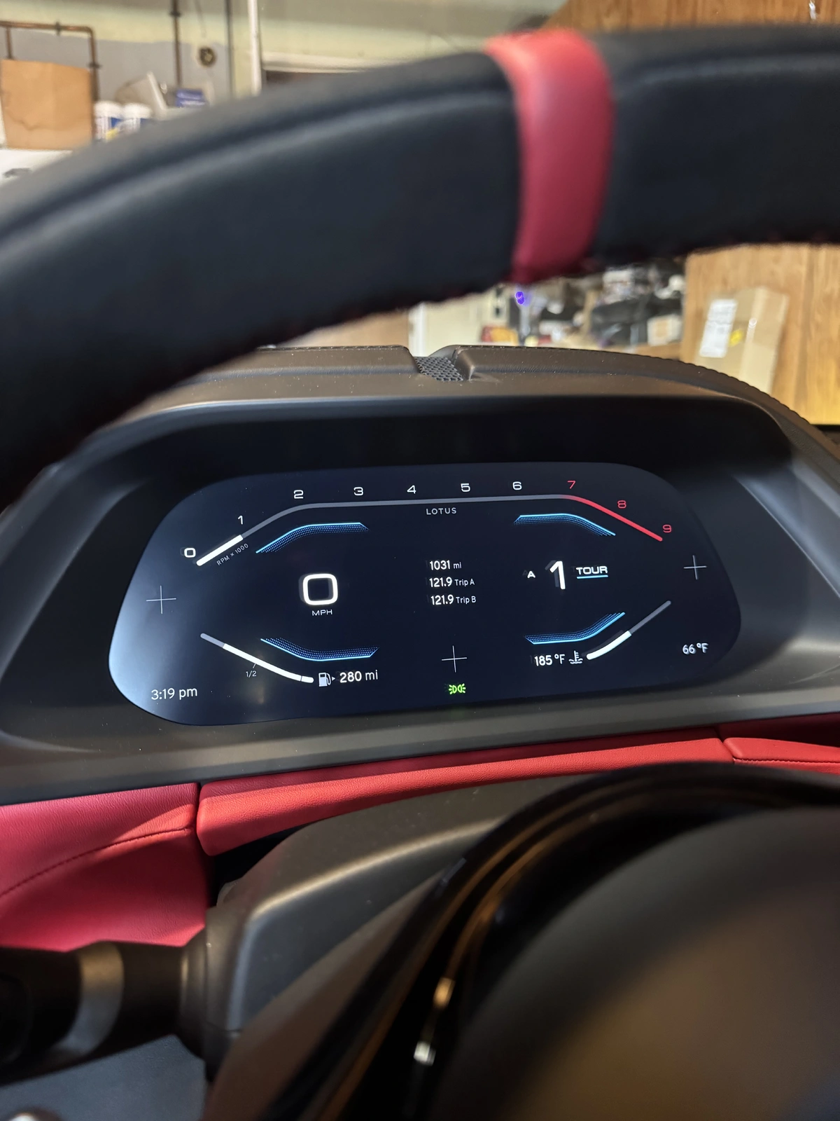

Finally broke 1K miles on the i4. Nice to see 280 miles left in the tank after 120 mile with half & half between tour and sport. That's how much it usually shows in the V6 after a fillup (well maybe a bit over 300 if I've been running in tour for a bit prior). Now that I can go pass 1/2 throttle in sport. It's quite amazing with sport mode keeping the rev up and you have minimal to no turbo lag when you step on it. The i4 touring suspension is definitely stiffer than the V6, It's probably more like a V6 with sport suspension (maybe even stiffer at rear spring is 140Nm/m vs 115Nm/m of the V6).

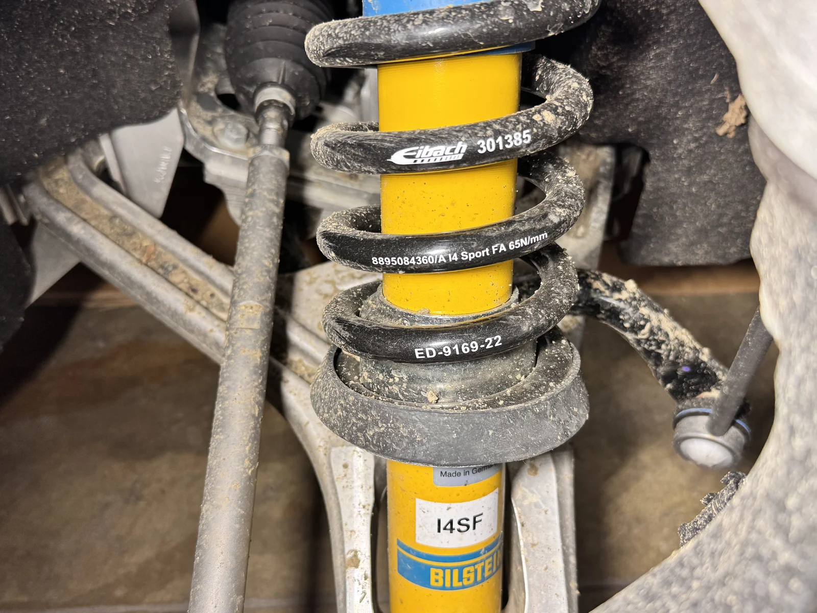

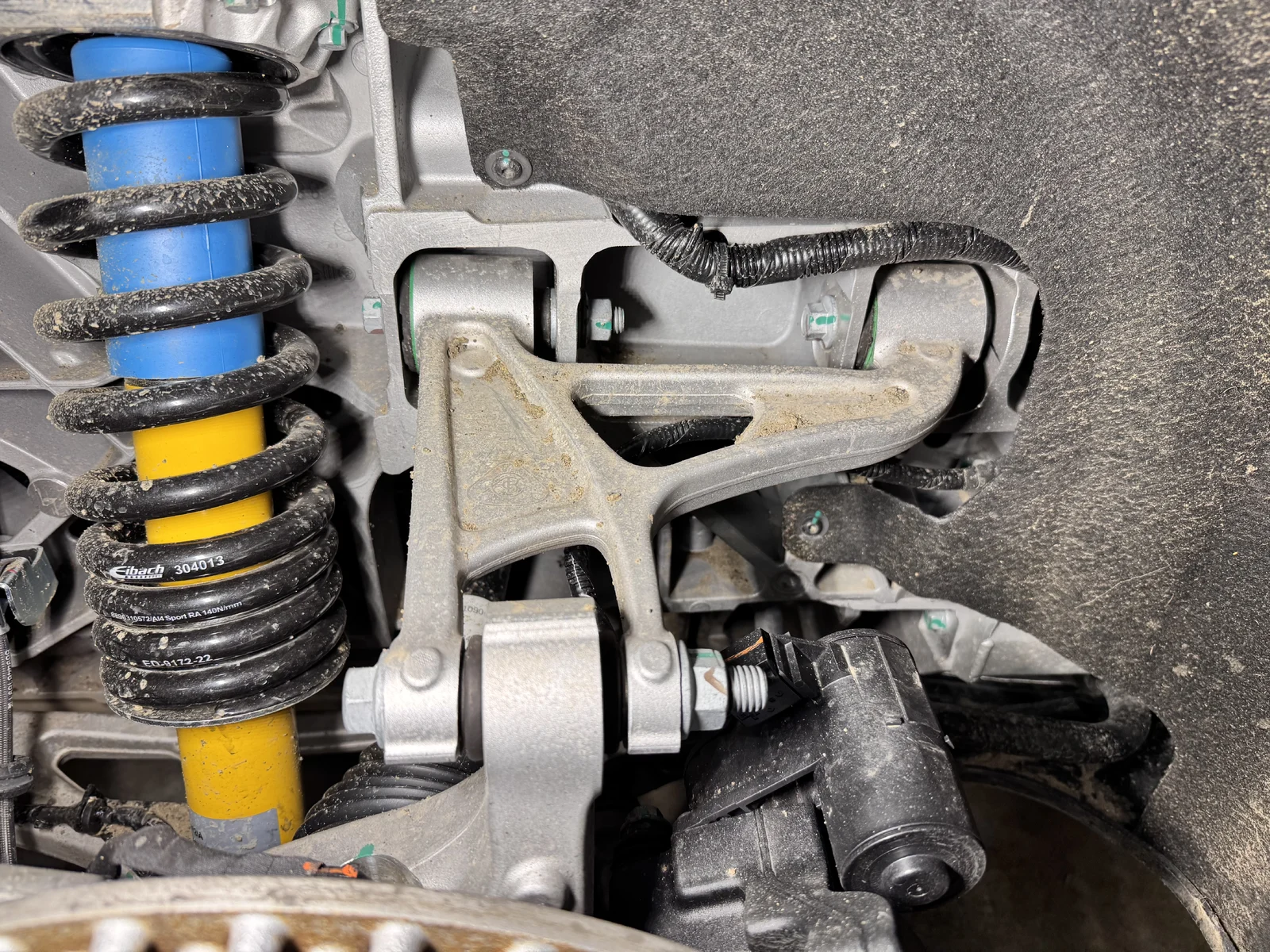

Go drive it again I have had 3 other Emira owner drove the i4 and without me hinting at the different spring rate. They all thought it's more bouncy compared to the V6 tour. both the front and rear spring are different from V6. I don't have pictures of mine but a friend with a i4 sport have taken picture of his
this is compared to the V6 sport's 60Nmm front and 115 Nmm rear. I didn't know that when I drove my V6 to pick up the i4 and I felt the difference right away. These pictures comes much later.

weight different is 12Kg but the M139 does have more weight in front of the rear axle than the V6. The i4 does have shorter A Arms in the rear but there should be minimal impact on spring requirements.
Any time you change weight distribution, and suspension geometry, you are going to feel it. Like you, I've driven both back to back in the same environment and they had different driving characteristics and feel. To me, the I4 was absolutely more nimble, felt lighter on its feet, and overall more balanced. Both were sport suspension cars. I'm simply commenting, because I think the "feeling" difference is more than just spring rate difference.
BTW, the fact that they had to change the spring rates tells you the suspension dynos and suspension sensors that they add for tuning were yielding very different handling characteristics when they were suspension tuning the I4s. no matter how hard they try, they will never be identical simply as a function of physics.
Yea the numbleness definitely comes from the different front rear weight ratio, the i4 rotates faster/better.

If you do go drive them again. the simplest thing is just find a parking lot with speed bumps and go over them at the same speed. The i4 is much stiffer in the rear.
