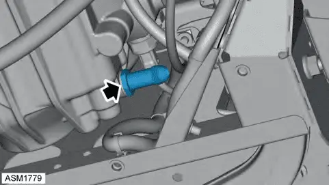

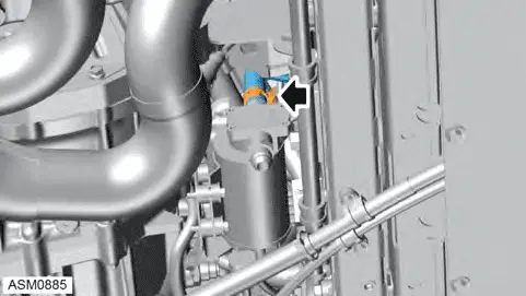

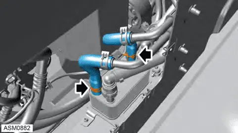

The gearbox has its own external oil cooler (oil-to-water heat exchanger), a dedicated external oil pump, and a check valve with integrated filter where the oil circuit connects to the gearbox.
Oil Cooler:
Oil pump:
Check valve on gearbox, with integrated filter (hose removed in image):
Hope this helps. The coolant side of the trans oil cooler seems like it might be combined with the chargecooler coolant circuit and routed to the dedicated radiator for that in the front right bumper opening, but I don't have explicit evidence in the service manual that says so. I'll have to look at a car and trace the lines to figure that out.
