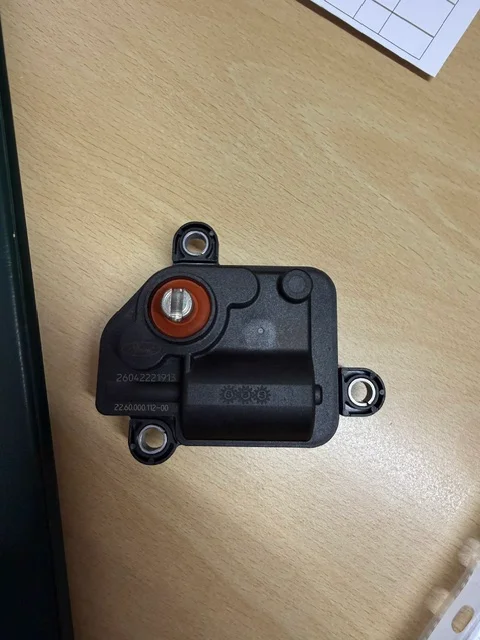

Dealer service advisor told me the valve controller melted (though I don't see it reflect in the work notes).
Work notes indicated Lotus advise them to replace the ASO EXHAUST MUFFLER VALVE ACTUATOR (8902858596).
So it's odd to me he'd say a different part was melted. I'm also under the impression a decat in fact reduces heat in the area to reduce the melting risk.
I've yet to go back to the track after the replacement to see if it was solved though.
