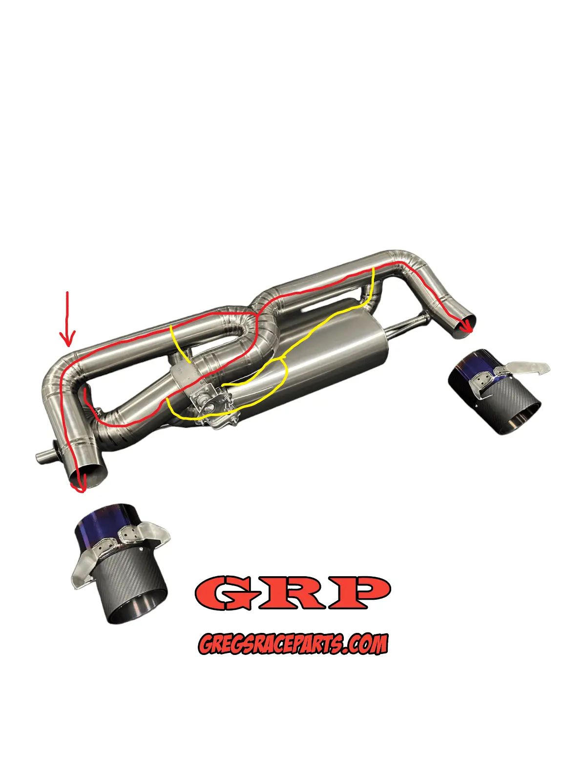

When the valve is open our exhaust exits through both larger free flowing pipes outside of the muffler box -- creating a straight pipe type setup. It sounds pretty killer! Weather has prohibited getting good video clips but hopefully next week we can get the shop car out and get some done.
Here is my quick paint drawing of the exhaust flow --
Red is with valve open
Yellow is with valve closed

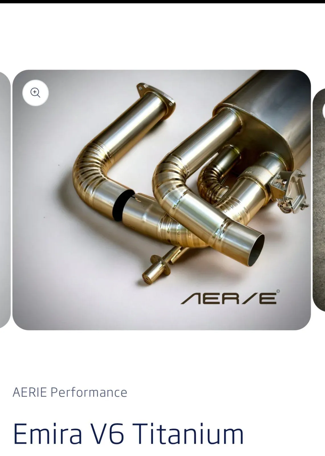

Awesome! Is yours a bigger diameter than the stock or compared to say Milltek?
I think the Aerie is like the stock set up and still goes through the box either way.
Yes, ours is larger diameter tubing for the valve open flow path. Im not sure of the others tubing diameter but probably comparable to the Milltek.
And also correct -- we initially did a couple prototypes that modeled the stock muffler/flow path like the other mentioned above here and they just didnt make hardly any sound difference (all the sound difference came from the cat delete vs the muffler) so opted to change to this new design which we are very happy with.
