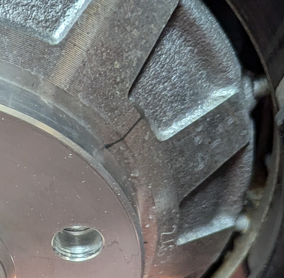

@LuckysDad is that a crack on the rotor hat? or just dirt?

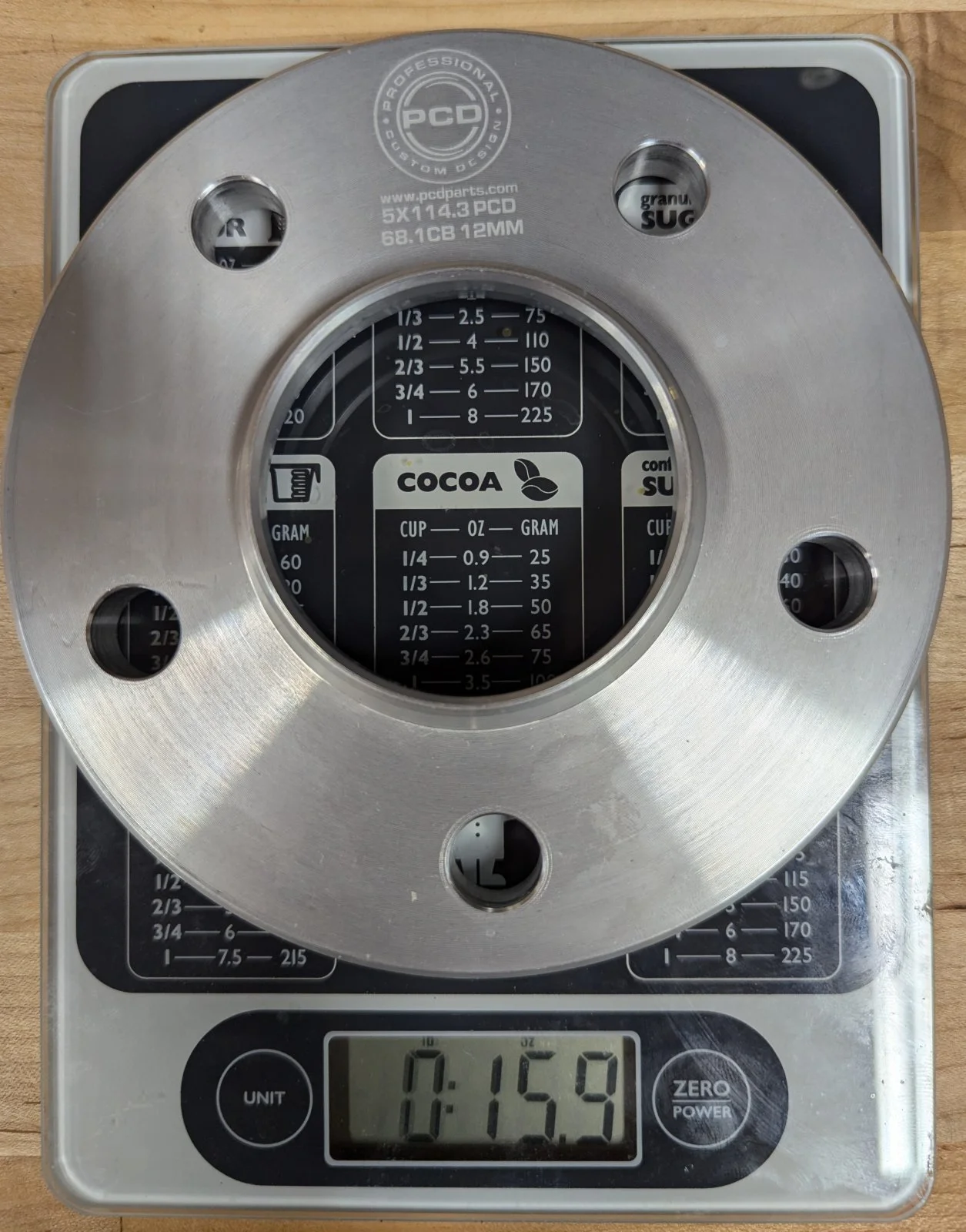

I'm mid install of the 12mm spacers.
Just awaiting the arrival of titanium lug bolts today.View attachment 47794View attachment 47795

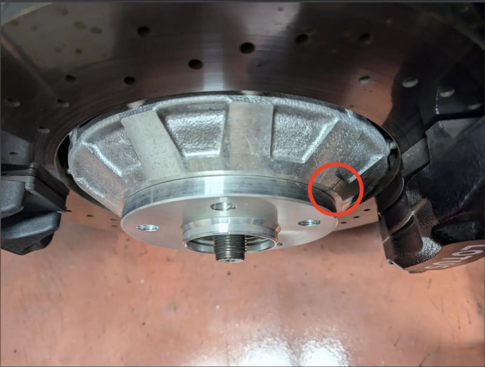

The only thing I am now deliberating on since reading all these post is whether to go flat spacers or concentric with the lip. Can anyone shed any light on differences, availability etc. I have had concentric ones on a previous project which worked well but only due to the fact there was nothing available for the car.
As @Porter mentioned with 10mm spacers you do lose the "spigot" for hanging the wheel on during install so some extra care has to be taken when tightening things up. With that said we have found that is not something a lot of guys have the patience for so we are going to start offering 12mm spacers which have the built in hub spigot for centering everything up and take any guess work out of it.
The other thing that could help with 10mm or any spacers that have no centering hub is using wheel studs instead of bolts, the studs will help center things up much easier but still use a gradual torque down method like Port mentioned.
The Komotec spacers mentioned above are 5mm spacers actually -- they call them 10mm because it adds an overall 10mm to the track width of the car, its a little confusing. Maybe common in Germany to call them by the overall width added instead of individual width added. Those will not/can not have the centered hub built in either, spacers need to be a minimum of 12mm to have that for these cars. So that picture they use is not of the actual product.

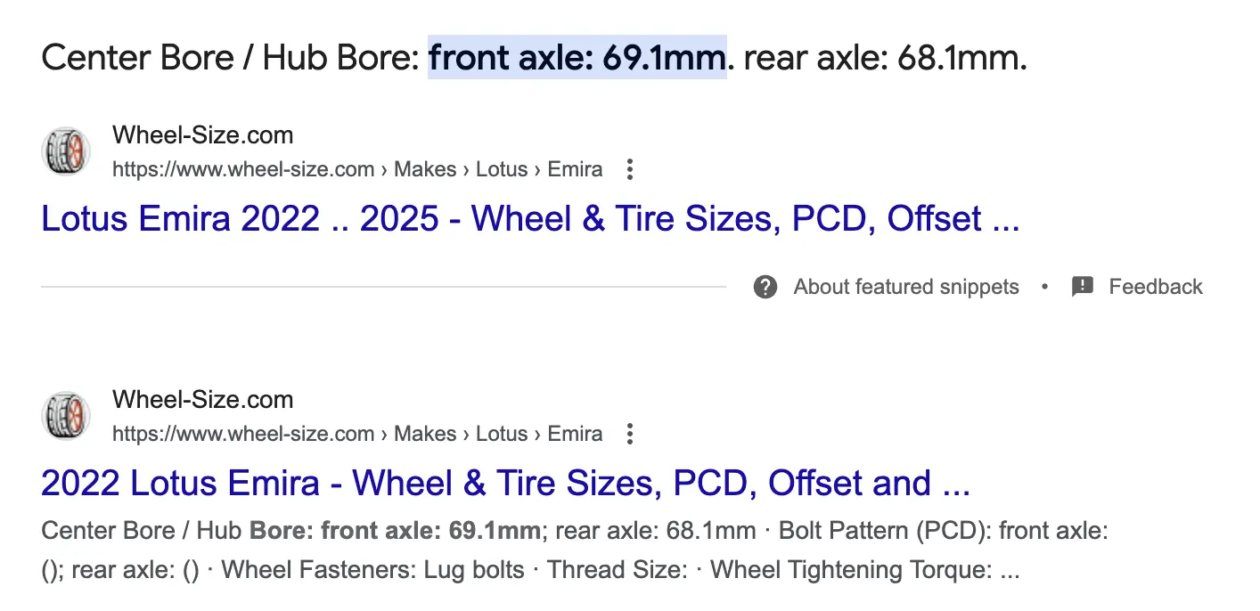

Those will work fine for you and they ship from your country -- the confusion comes from google search initial result for "lotus emira center bore" resulting in this incorrect information:
PCD is probably seeing those results of a typo and saying they don't have any in stock.
