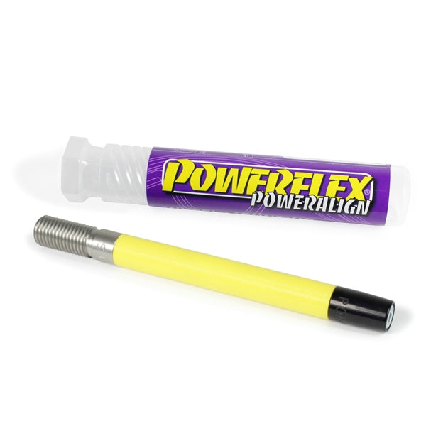

Also know that the Emira uses lug bolts so the wheels are a bit more of a pita than normal. You can get cheater line up bolt things. I don't remember what they are called but they are helpful and easy to keep in your trunk bag. Worth it if you are doing wheel removals often.
GRP (Greg's Race Parts) sells a "Powerflex Wheel Install Guide Pin" for the Emira, which is a pin/guide making it easier to locate and line up the lugs, when changing tires (read the GRP description on the link below):
There are many others available on Amazon (search "wheel alignment pin"), of various lengths, and far cheaper. The GRP version has a coating on it, to better ensure it doesn't cause rim damage when contacting the rim, unlike others w/o any such coating. Some people put electrical tape over the non-coated ones, as a DIY solution. Some like to buy a second one, shorter in length, to use 2 at the same time. I've got the GRP one, plus a shorter one from Amazon, since I plan to swap tires/rims for track use. Only really needed if changing tires frequently as indicated by RoryBellows; up to you to decide if the convenience justifies the price.
