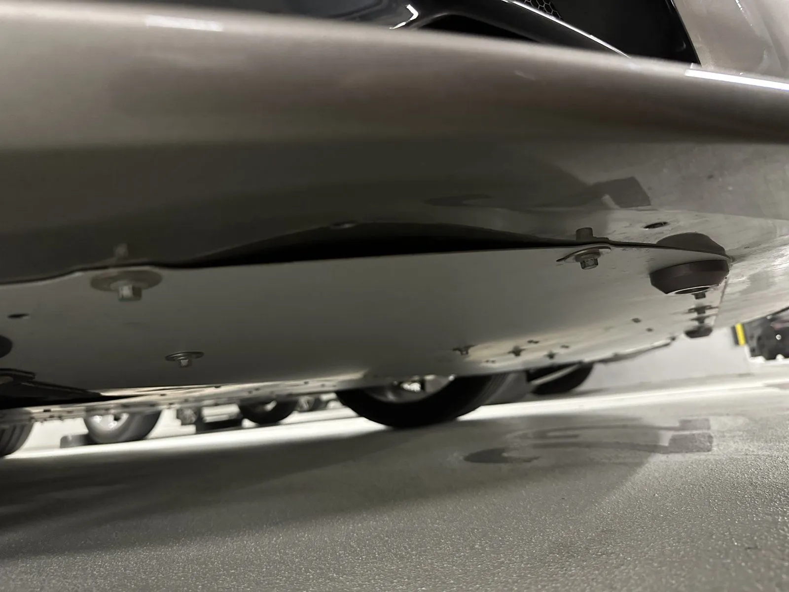

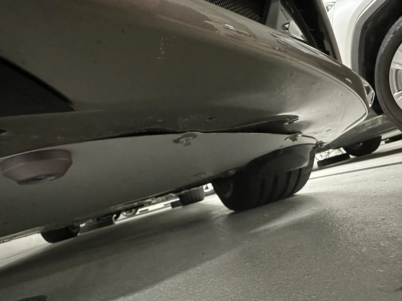

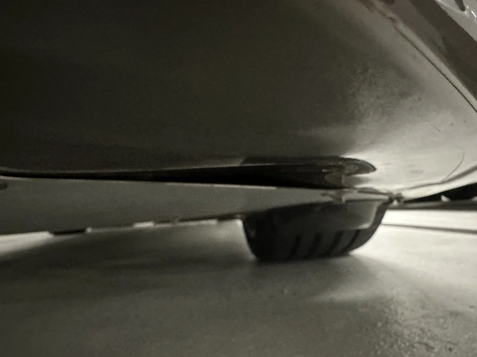

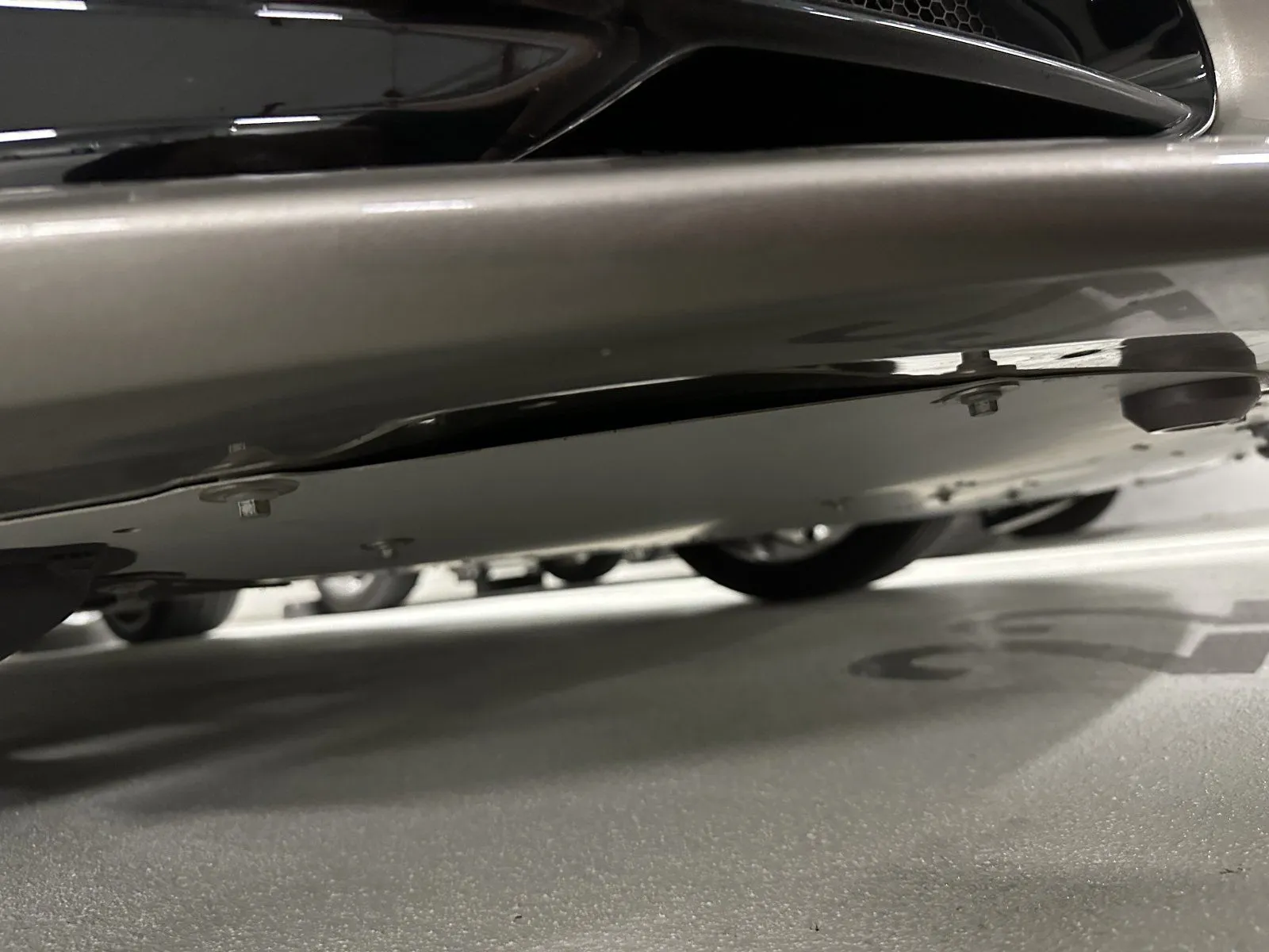

Hi all
My fairly new (4 weeks) Emira was put on a platform yesterday for a wash and I noticed distortion / denty gaps between the front panel and the undercarriage / underside panels.
Is this normal? Assume not, as gravel / dust etc. would be kicked up into the gaps and accumulate on the inside??
Anyone else seen this on theirs? FYI there are 2 of these on the left and 1 on the right. My immediate reaction is that these are defects, as elsewhere between the body panel and the undercarriage, everything sits flush with no gap whatsoever.
Hoping the experts will chime in. Thanks in advance.

It’s totally normal my dealer tells me. Previous Evora’s had aluminium under tray tucked inside the bumper whereas on the Emira, it’s on the outside with gaps. So I used black silicone to seal the gaps as grit and small stones do get inside. It’s a quality issue or designed on purpose as an additional air scoop. Very little people notice this as it’s underneath the car. Mines not as bad as yours but most Emira’s have gaps.
Who are these very little people, and where do they come from???? :LOL:
I’ve spoken with the dealer and their service team (both of whom have been great so far) and they agree that this is a defect. Apparently they’ve only seen this issue on one other car - on the rest of the 70 or so cars they’ve delivered, the base plate sits tightly flush to the body panel.
They’ve notified HQ/Factory. I will update on here once I hear back.
Another one to add to the list of "things to check on delivery day" along with functional A/C and power steering.
