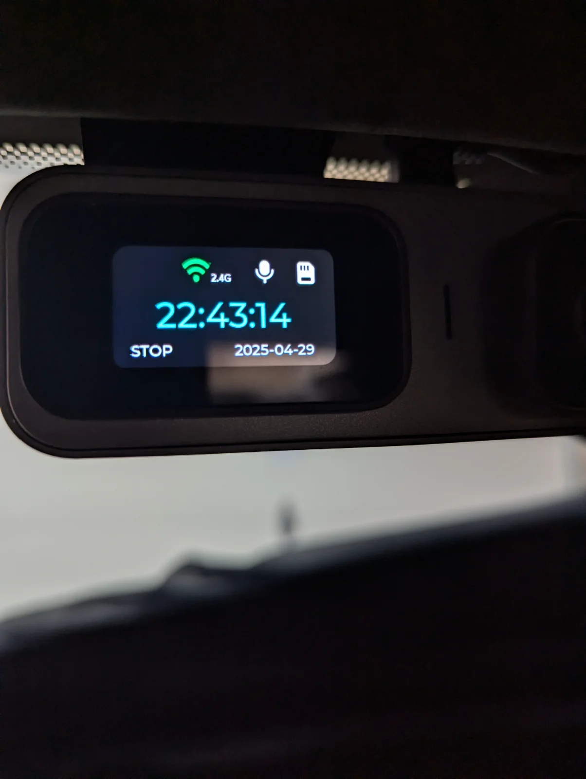

-I didn't want a video screen as I see that as a distraction (this one goes black after a user-selected time)

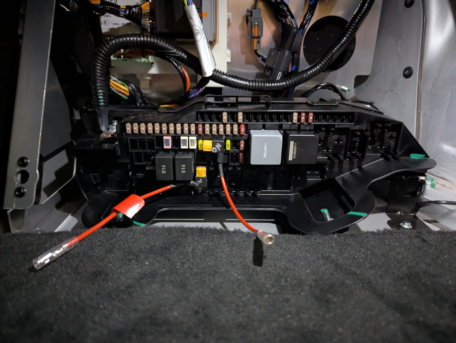

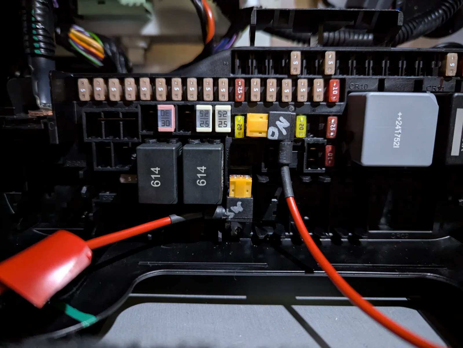

Although I could have powered it from the USB port in the mirror, I wanted 'sentry mode' so it would record when the ignition was off. Every single camera with this feature requires an accessory cable so it can have 'always on' and 'accy on' power leads. This company was AWESOME, emailed them upon receipt of the camera and the accy kit showed up three days later. And the kit is perfect. It includes special modules so that you can pull the accy and always-on power directly from some fuse slots, without interrupting their function or having to do any wire splicing. I used the fuse slots for the passenger seat motor (for always on) and the mirror USB for accy power. It is installed and working great, feel free to PM me if I can help any of you.
