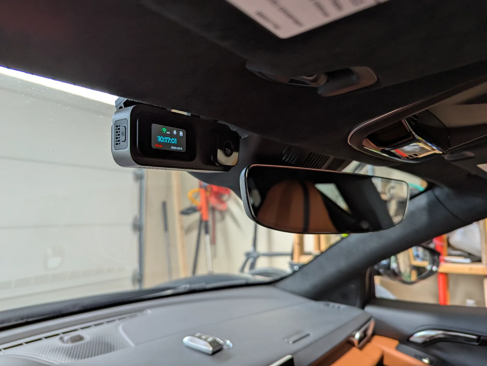

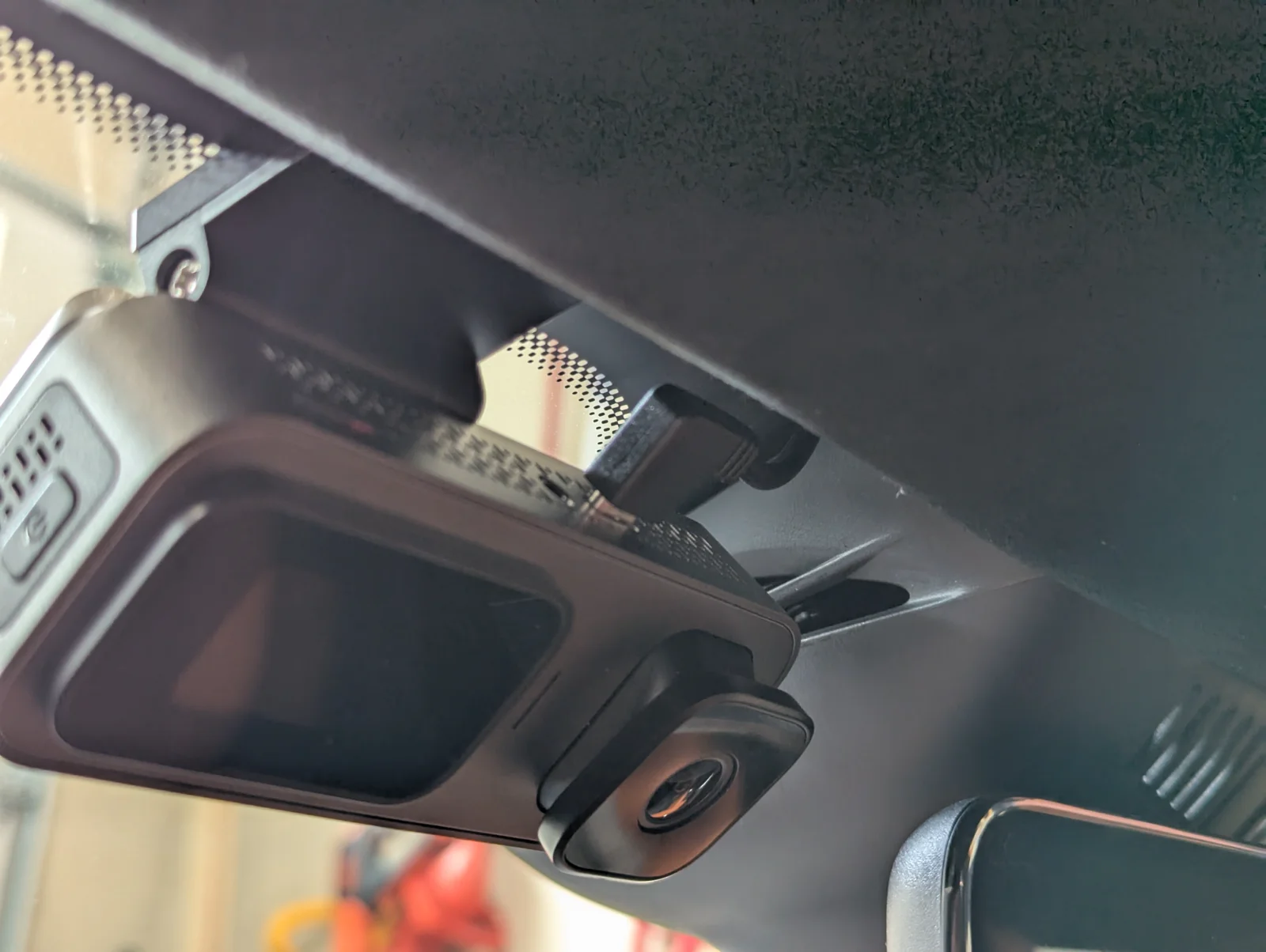

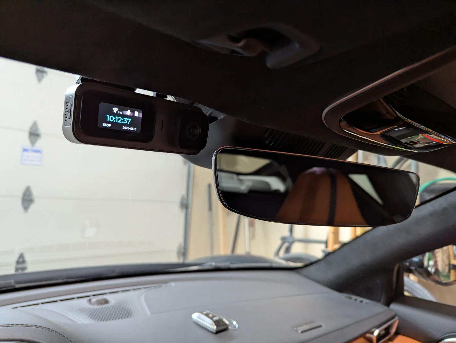

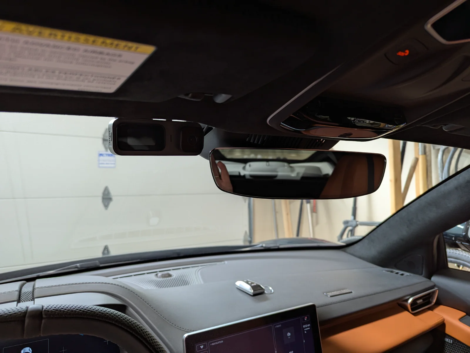

I literally bought seven dash cams until I found the one I wanted. I selected the Anyski 4K and am very happy. Couple reasons I selected this one:
-I didn't want a video screen as I see that as a distraction (this one goes black after a user-selected time)
-I wanted a very slim version so I could mount it on the left side (to get good video in the event of a traffic stop)
-It needed a clean setup (no big cords, adapters, etc)
-The app needed to work well, and the mfr needed to provide good support
-I wanted three channels
-It needed to have sentry mode with battery protection (automatically disable if voltage is too low)

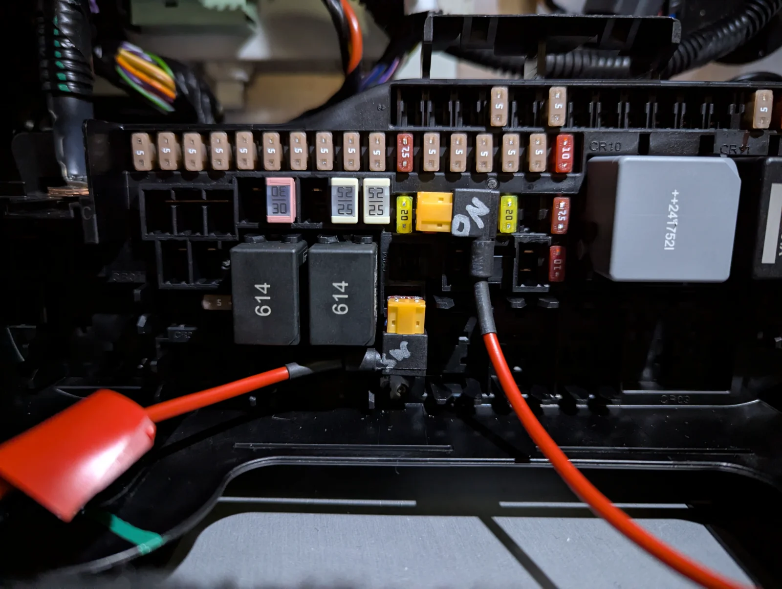

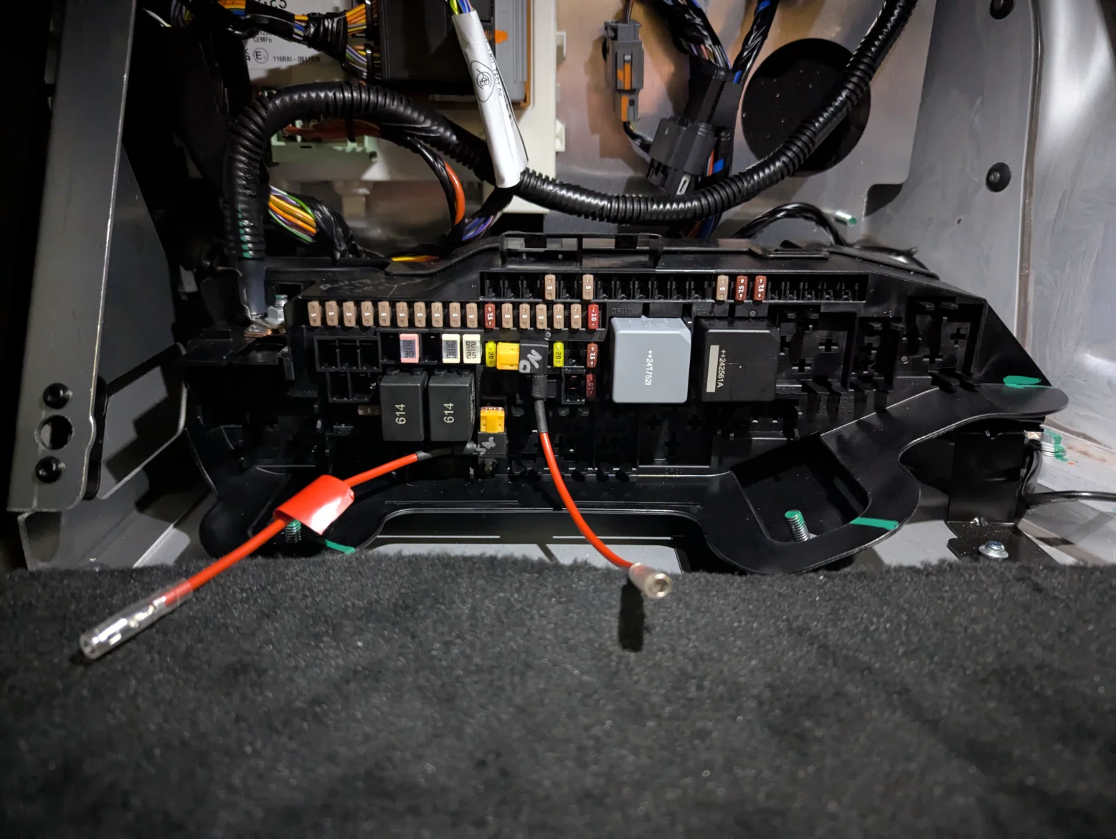

Although I could have powered it from the USB port in the mirror, I wanted 'sentry mode' so it would record when the ignition was off. Every single camera with this feature requires an accessory cable so it can have 'always on' and 'accy on' power leads. This company was AWESOME, emailed them upon receipt of the camera and the accy kit showed up three days later. And the kit is perfect. It includes special modules so that you can pull the accy and always-on power directly from some fuse slots, without interrupting their function or having to do any wire splicing. I used the fuse slots for the passenger seat motor (for always on) and the mirror USB for accy power. It is installed and working great, feel free to PM me if I can help any of you.

Hi I was running a black vue and external battery on my Supra, and want to install it on the emria now, how was the install? What fuses did you tap, also where did you place the external battery?
could you take a wider view picture of the install from the inside and outside. Like to see how much room it takes up.

I have a pinned story on my Instagram that covers the important parts of the install. It's basically the same for the Emira, unless you just want to plug into the usb port in the rearview mirror.

Here are some other pics of the install. By the way, got pulled over last night by a state trooper. Had no idea why he was pulling me over, then he said it was really just an excuse to see the interior (I stopped after the stop line at the previous intersection). Never had that happen in my 30 years of driving. We also chatted for a bit about the color because Verdant Green is just listed as 'green' by the DMV and he was confused because it looked black until he got up to it. I had my 17 year old son with me, turned into a cool story.

Clean install with USB port!
Very helpful, I wanted to know how well a windscreen rear facing camera worked. Looks like it works pretty well & so no need for a rear camera I think which saves me the hassle of running wires through the cabin.

By the way, I found out the passenger seat wire is not always-on. It is linked to the timeout circuit, so if you leave the door open or similar the car will power off everything, including the camera. Better to use a true-always on, then the camera will shut off automatically if it sees too low of a voltage. I'll probably redo mine this weekend and will post where I moved the wire to.
Can anyone tell me where I can get always on power from the footwell fuse box. The seat modual which I had wired to does shut down after a while. Or if door is left open.
Im assuming you want always on power for camera’s sentry mode. One thing to monitor though is the parasitic drain of an always on device. I dont know if you have v6 or i4 but in the AMG i4, there is a ton of parasitic drain and the alternator does not recharge battery until gets down to 70% (flawed but intentional ecoemission AMG design). If you leave your car sitting not on the tender for awhile, with all the parasitic drain, and battery level drops to around 50%, the car wont start.
@Kaz and I run the Antigravity Battery Tracker module attached to the battery and connected to our phones via BT to monitor battery status. Might not be a bad idea to check battery drain levels with always on camera at least in the beginning. I know @Kaz had his camera moved from always on to ACC because of parasitic drain.
Yes, my apologies as I originally recommended this connector, and I also noticed that it is on after ignition is off, but times out after about 15 min. I also need to pull my footwell apart and move my 'always on' connector. Here is the fuse panel from the manual, but I fixed it as the manual shows an incorrect mirrored image. I don't want to touch any SRS wires, so I'll probably leave a door open for 20 mins, then put a meter on each tab and see where I can get 12vdc.
