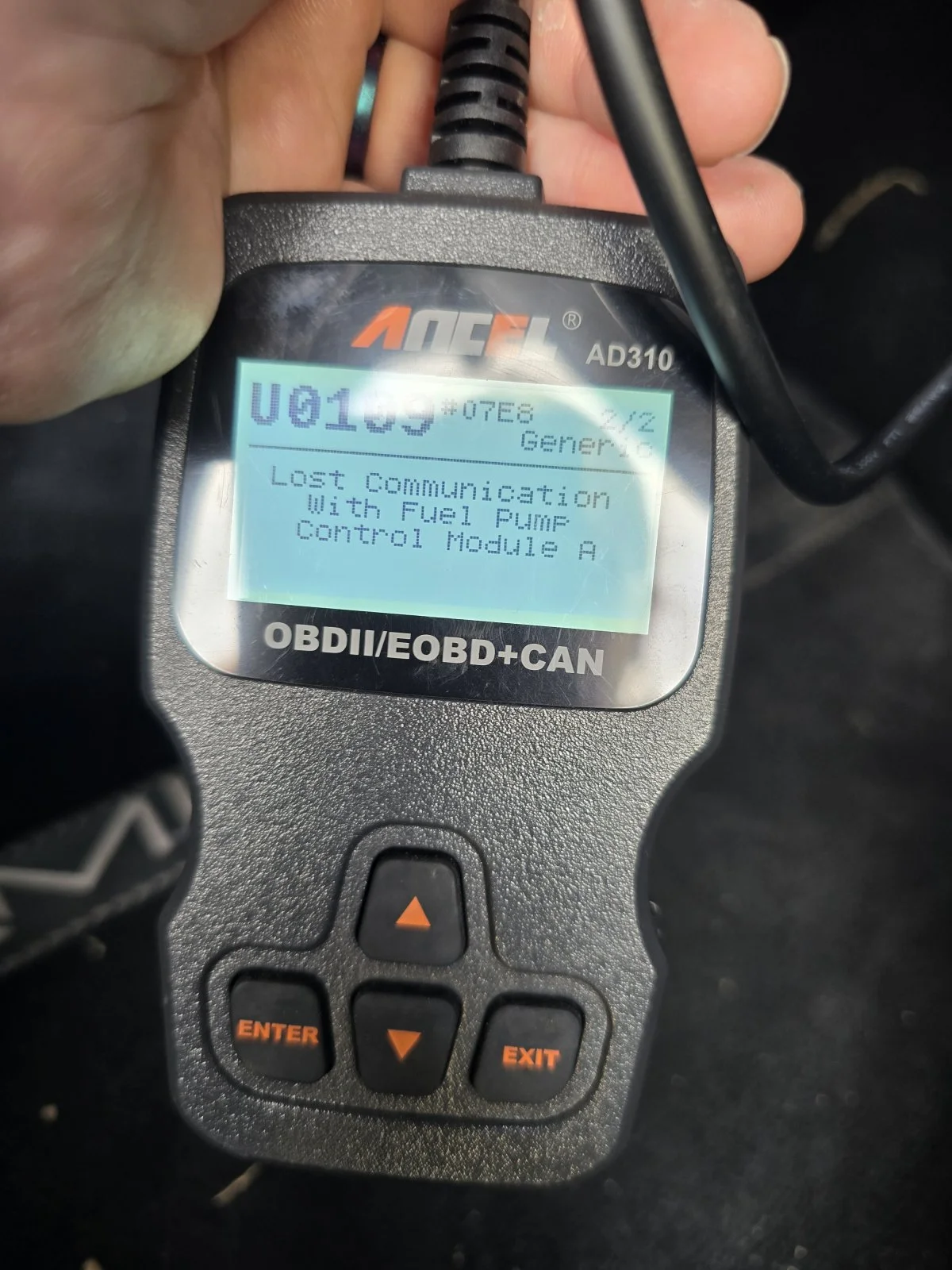

Started perfectly on the second attempt. Interesting it also threw an error code and a check engine light. Plugged the code reader in, see attached.
Car had sat for a week since last start (not on charge and last use was a 55 mile drive) Cleared the codes and now all fine again.

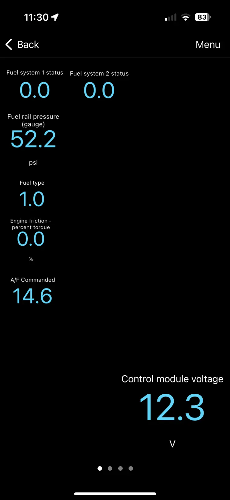

Based on some of the comments in this thread I got to thinking about the fuel pressure and I am by no means an expert so just trying a couple different options to determine what is happening. I use OBD Fusion to monitor the car when I drive. The fuel rail pressure at idle is about 50psi. On start up the readings go up to 90-100psi before coming right back down. Also, not sure how fast the bluetooth OBD reader is, so I could be missing some values as it is not updating quick enough.
The bluetooth adapter I use remains powered on constantly, I typically unplug it to not drain the battery, but I left it in to do some testing. This morning I went out and before opening the doors I connected my app to the OBD reader and the fuel rail pressure was at 32.6psi. I waited for the screens to start up and I did not see it jump up until I started the car and everything was normal. I shut the car off and even several hours later the fuel rail pressure was at 52.2psi.
I have attached some screenshots and I am going to keep testing different scenarios which might take a few days. What I am curious to see is if the car sits for a longer period of time, will that fuel rail pressure drop below 32.6 psi and if it does, when I get in the car does it jump up prior to hitting the start button on its own? For example, does pressing the clutch in or applying your foot on the brake send a signal to the fuel pump? Does waiting for the screens to fully boot give the fuel rail pressure time to rise? If I don't see any of those variables I will see if I can recreate a stuttering start and then look to see what the fuel rail pressure is.
Anyway, sorry for the long post and if you have any ideas or values you think might shed a light on this open to suggestions.

Just a quick update, as I have been monitoring the fuel rail pressure prior to unlocking or opening the car after it has been sitting. The short of it is that there is no rhyme or reason. I just went out of town for a week and upon returning, the fuel rail pressure was in the high 40's and the car started no problem.
Other times I had been monitoring, within a 16-20 hour period, prior to starting up, it read in the mid teens. Seems that when it gets below 30psi or so is when I typically see it have a hard time starting until i turn it off and then it starts up just fine. When this happens and I am reading the fuel pressure, on the the second start it jumps up immediately like it should.
Here is the part that is not good, when I do see a low fuel pressure reading, no matter what I do, unlock, put foot on break, push clutch pedal in, wait for all screens to start, and even press the start button to go into accessory mode has no effect on the fuel pressure. Seems like their is no way to get the car to kick on the high pressure fuel pump without actually starting it.
Never tried this with any of my previous cars, so I am by no means an expert in high pressure fuel pumps and the way they should normally act.
Just thought I would share some of my most recent readings.
