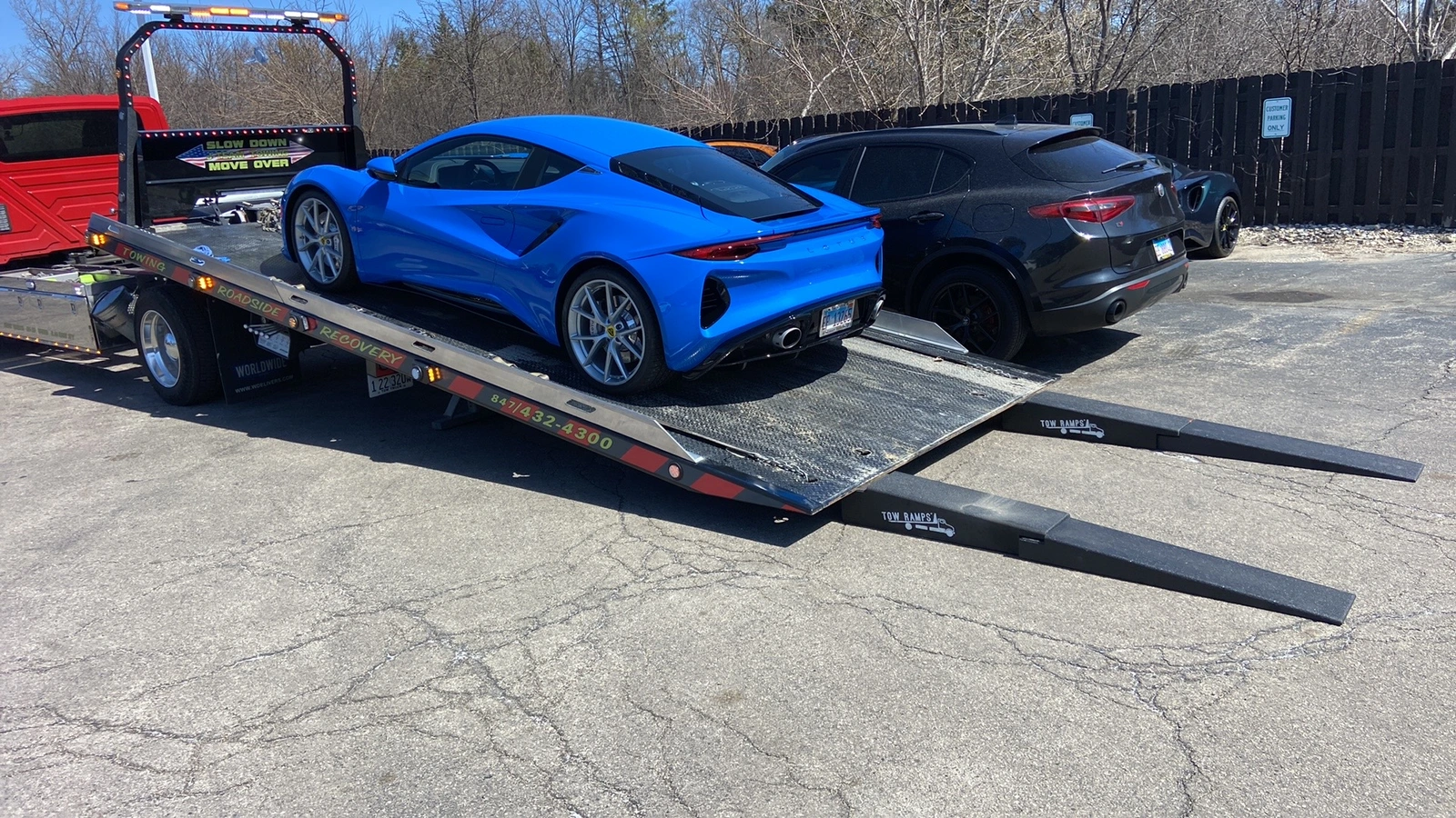

Well, mine’s been sitting all winter on the battery tender and I just went to start it and the clutch pedal went to the floor and remained there until I lifted it up. Can’t engage any gear. The car did start normal without any spike in revs. Time to call the dealer.
Just got dropped off at the dealer so we’ll see what they say. By the way, Lotus Roadside Assistance handled the flatbed tow as a part of our warranty.
