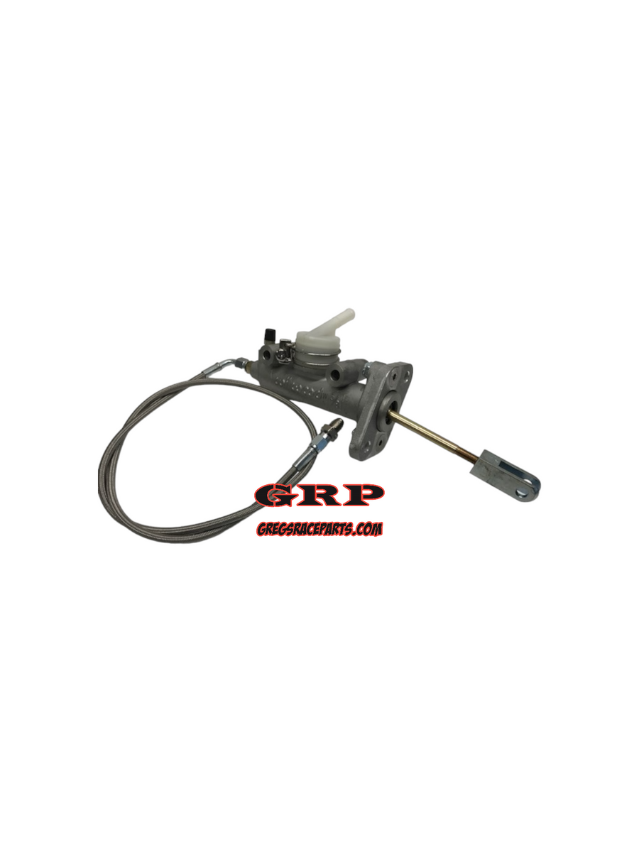

This is apparently a pretty well known issue on Evoras as well -- plastic master cylinder failing.
Thanks for info @GRP

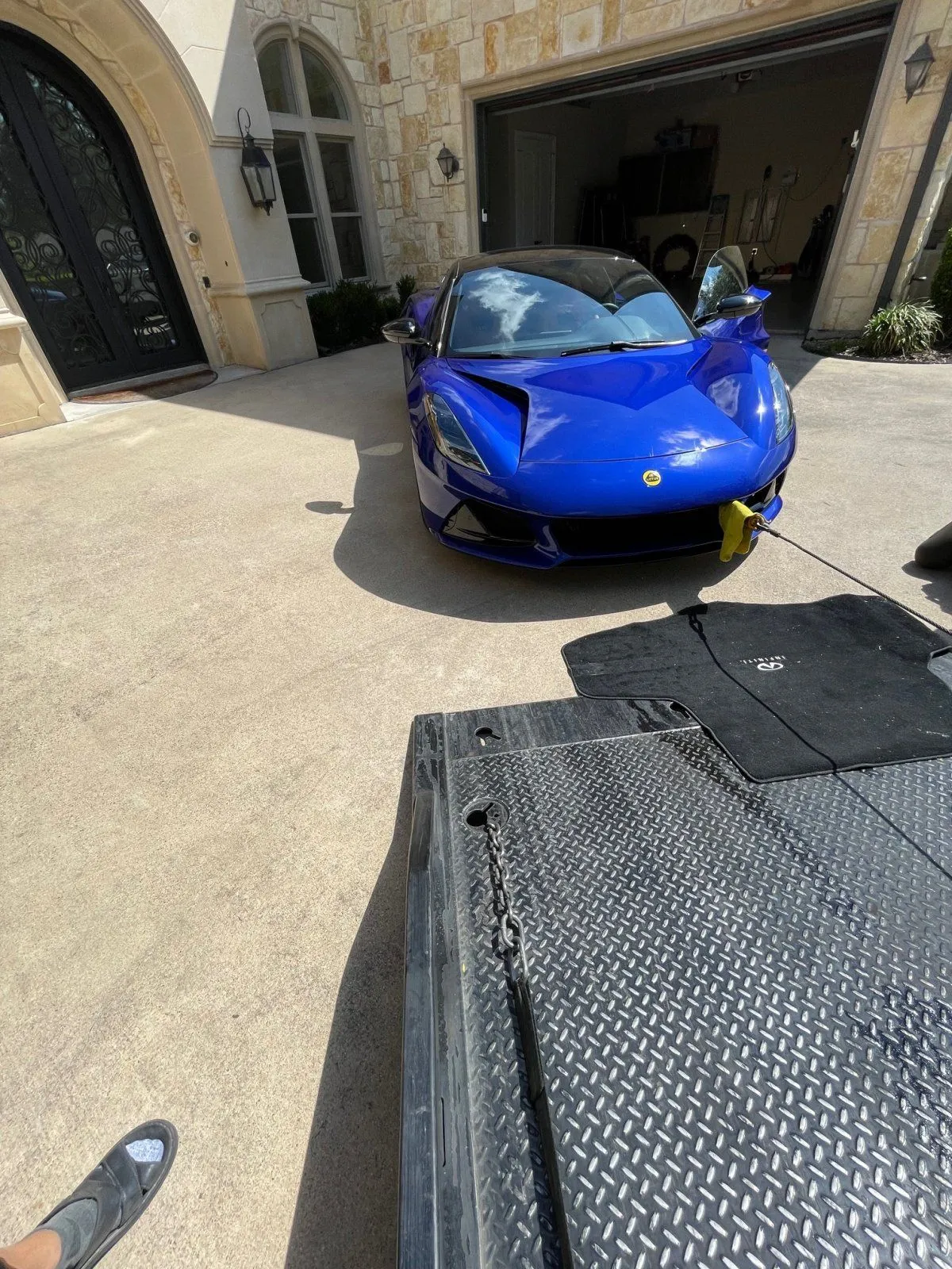

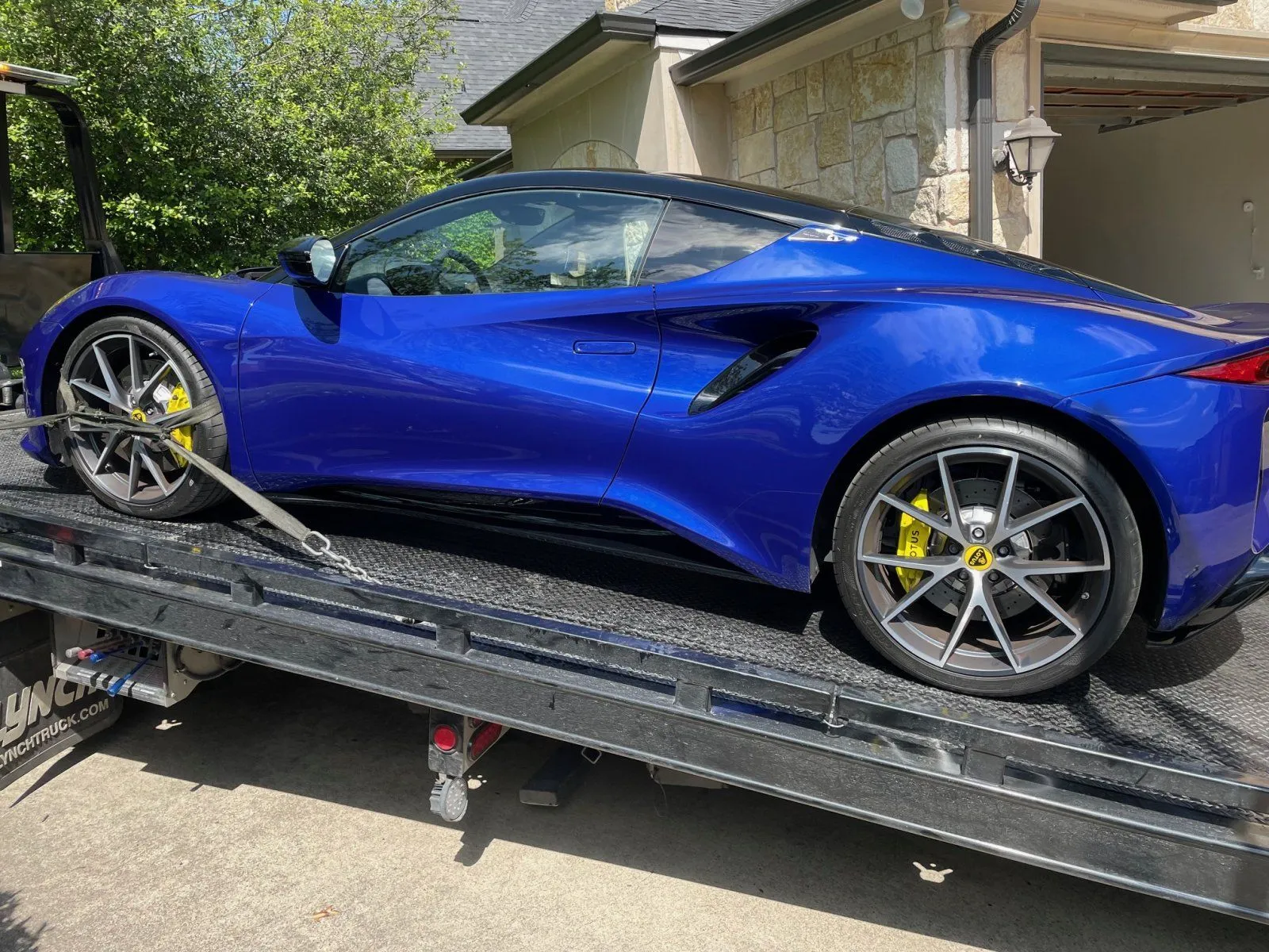

Not the best pic of the Lotus, LOL
My first towing experience in a new car
