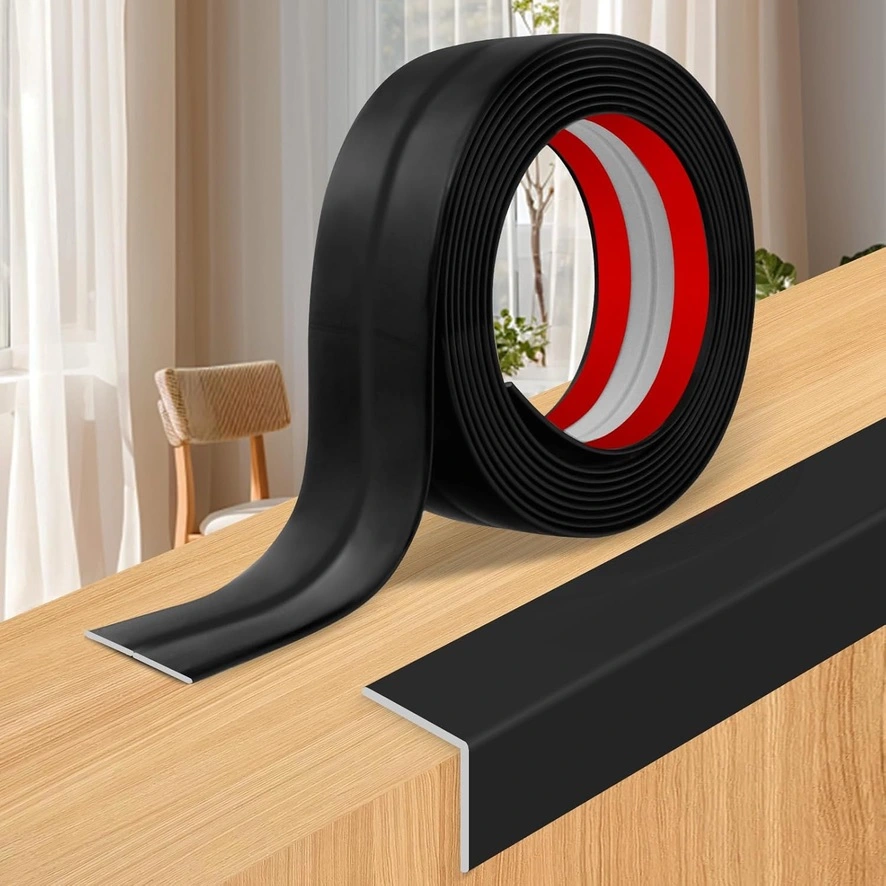

I found this on Amazon Wall Corner Protector and does inside and outside corners..
If the 3M double sticky tape does not do it I will purchase and do believe this will have
enough strength to hold headliner from flexing.....

So yesterday I put the double sticky tape all the way across the rear window to get it to stick to window and headliner
so that it is not flexing..I will purchase this next few days from Amazon and just see how this sticks to rear window and
the rubber holding the headliner to make a inside corner ..
What I maybe should have done is pull rubber to headliner and just sprayed foam between headliner and roof and
problem solved...Just was afraid of mess with foam getting on interior...
