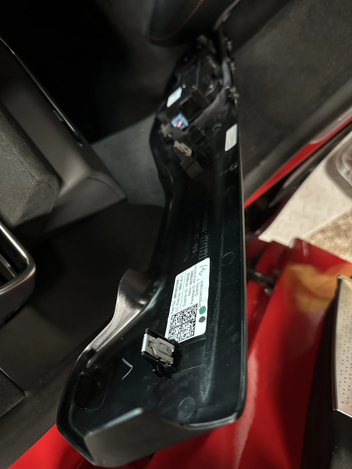

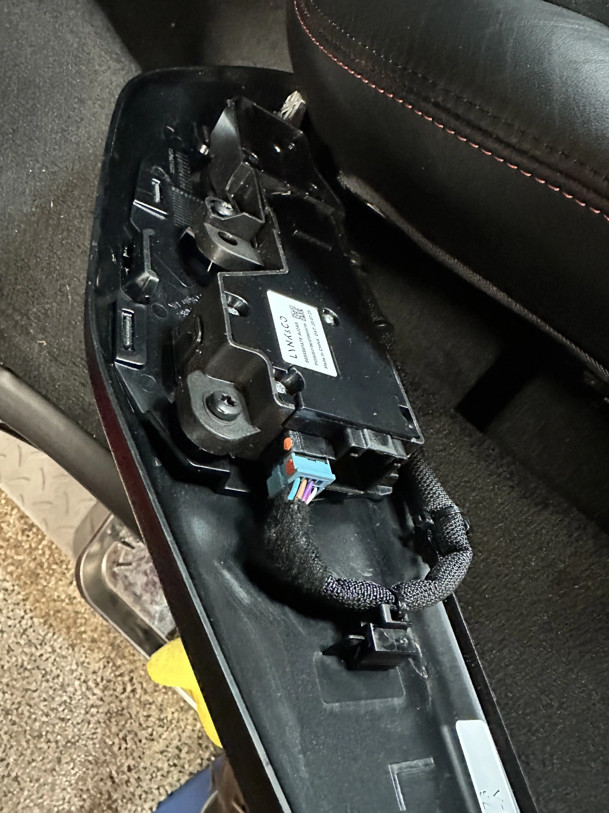

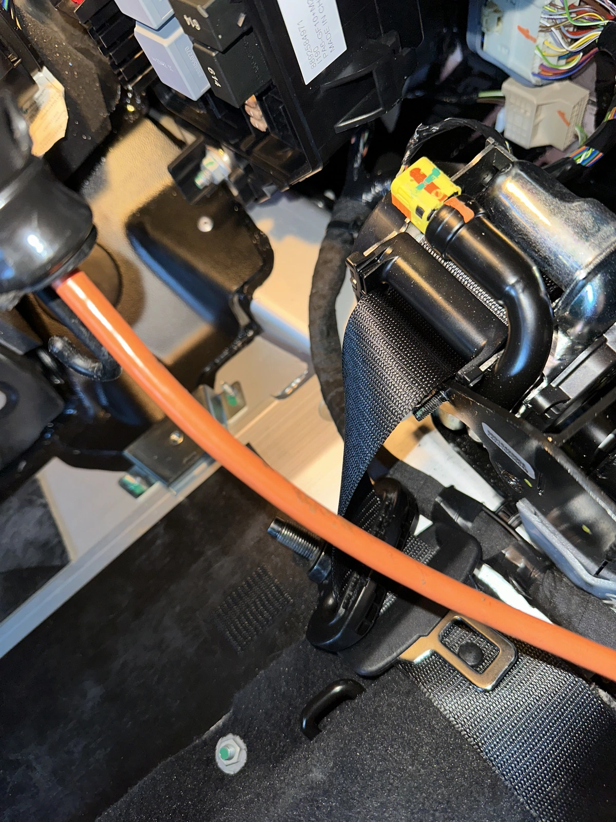

2. Next, remove the lower casing on the side of each seat (closest to the door), to access the bolt that connects the seatbelt to the seat (each side). Photos below show the inside of the casing, to better illustrate how it connects to the seat. There are 3 lower clips. It's not hard to get off: just slowly pry it away from different edges and it'll pop off, one clip at a time.

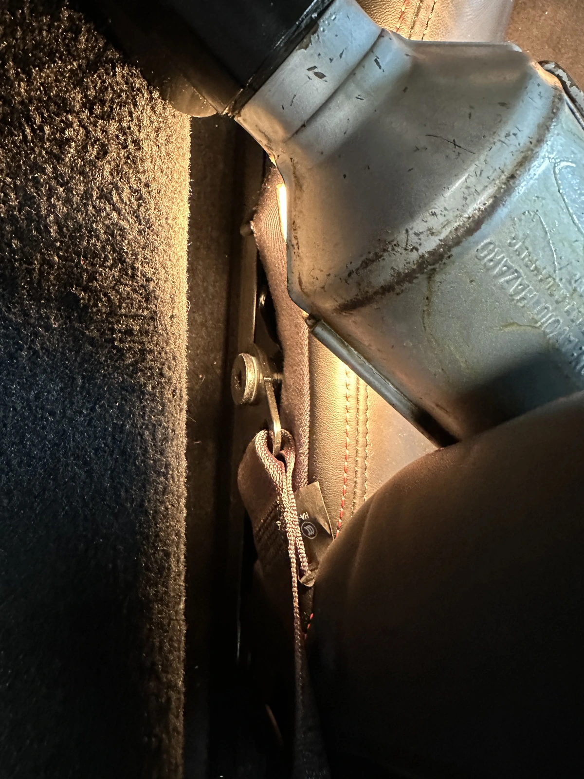

3. Now you'll see the connecting bolt (see photo below) which is in a narrow gap, between the seat edge and the carpeted door sill. There's not a lot of room to work in that space. I was told by a mechanic friend, that car manufacturers often use "loctite" on the threads, to better secure a seatbelt bolt in case of an accident impact, which can make them ++ difficult to remove. He suggested it would be easier to remove the seat, to get to that bolt and disconnect the seatbelt from the seat. You may wish to do that. Instead of removing the seat(s) and through trial and error (trying different tools), I found out:

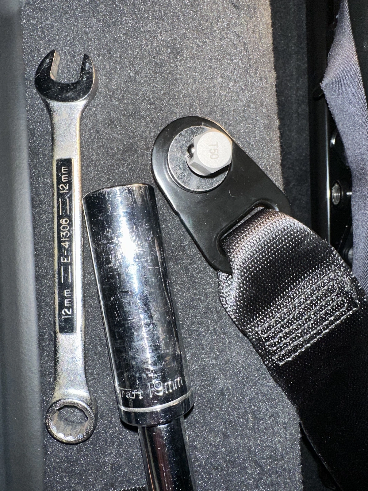

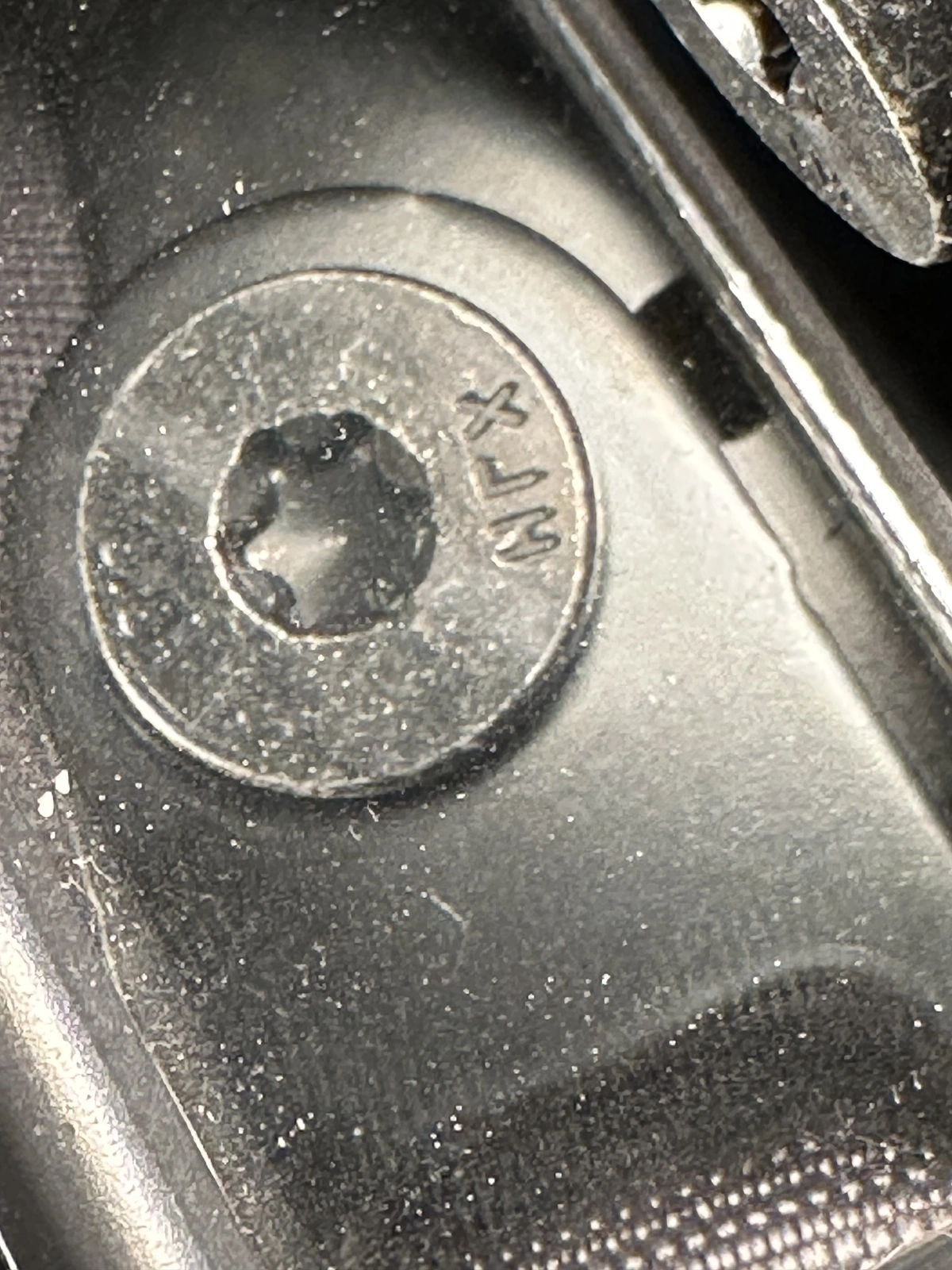

a) the bolt head is a T50 (torx) (see photo below, taken with the help of a mirror);
b) perhaps you can get a small 1/4" ratchet in the gap, fitted with a T50 bit, however I found a "stubby T50 bit" with a hexagonal base (to fit a 12mm wrench head) worked. See photo below for the set of stubby torx bits, including the T50 size. You'll find this torx set on Amazon. There are only 2 of these type of sets I found for sale, so it's not very common (search "stubby torx bits" and keep scrolling until you find one);
c) there was no loctite, so the bolt was easily unthreaded, once you had a T50 in it, plus something to turn the T50 bit;
d) was able to unscrew it, using the 12mm wrench on the hex end of the bit. To get it to move in the beginning and get more "torque", I put a 19mm deep socket, on the end of the 12mm wrench (see photo) for better leverage. I often put a finger on the end of the T50 while turning it with the 12mm, to ensure it remained in place and didn't fall out.

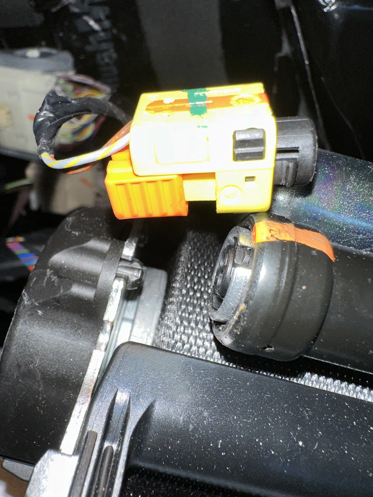

5. One such video showed the different kind of electrical connectors, for the seatbelt retractor mechanism, including something similar to the one in the Emira. The main point of the video, is NOT to try to disconnect it, by pulling on the wired end. Doing so, could pull out a wire or put the inside pins out of alignment, causing a malfunction and/or throwing a code. Take a small/thin flat head screwdriver and wedge it between the 2 sides of the connector, to pop the one side back and away from the rest. Then you can easily pull it apart and off. The first photo below, shows the OEM set-up with the connector in place (untouched). The next photo, shows the lower orange part of the connector wedged out, allowing the removal of the connector from its round base.
6. Remove the one bolt that connects the seatbelt retractor assembly to the vehicle. You'll find a little "L-shaped" guide, on the assembly that matches a slot on the plate on the car, which has the bolt hole. Once you get the bolt out, you move the assembly sideways so it comes out of that "guide", in order to take it out. That same "guide" also makes it easier to line up the bolt hole/bolt, when putting everything back together.
6. Now the fun begins. Remove the entire seatbelt assembly: the "seat bolt end" and the retractor assembly, as one unit.

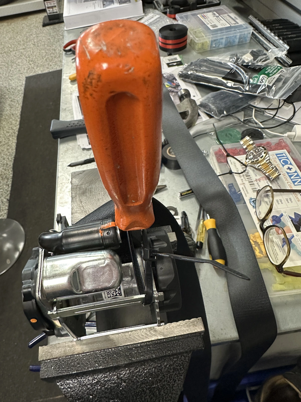

7. Next, unwind the OEM webbing. You can only do this, by keeping the retractor assembly in an upright/balanced position. If it senses it's out of alignment, it'll lock the webbing in place. I found putting it into a bench vise, the easiest way to keep it level and work on it (see photo below). But you don't need a vise; it'll work if you position the retractor assembly, correctly.
8. BEWARE: once most of the OEM webbing is out, the end of it will be connected to the inner metal "spool". With the webbing mostly out but still connected to that spool, the webbing is under tension and the spool will want to pull the webbing back in. YOU MUST BLOCK THE INNER SPOOL OF THE RETRACTOR MECHANISM, SO IT'S HELD IN PLACE AND DOESN'T MOVE, BEFORE REMOVING ALL OF THE OEM WEBBING FROM THE SPOOL. YOU DON'T WANT THE SPOOL TO UNWIND, W/O THE NEW WEBBING IN PLACE, SINCE I'M TOLD IT'S ++++ NEXT TO IMPOSSIBLE, TO GET THE EMPTY SPOOL TO UNWIND TO ITS END AGAIN. The DIY videos I looked at, usually showed a screwdriver jammed in the edge of the spool, to keep it in place. That didn't work 100% for me: I jammed a large screwdriver in, but still got movement. I then used an 8" zip-tie, tied around the screwdriver and retractor mechanism, to pull the screwdriver in tight towards the spool edge and better block movement and prevent the spool from winding up again (see photo below). Note: I suggest taking photos of the OEM set-up, before taking any steps, to ensure you know how it goes back together and you can use those photos as a guide. Anyway, make careful note of: (i) how the OEM web is threaded into the retractor mechanism; (ii) that there's a thin slot on the inner retractor metal spool, where the webbing first goes into; (iii) then from there, it threads into another but wider slot, where the OEM webbing ends, making its final connection to the metal inner retractor spool.
9. With the inner spool properly held in place (ie. screwdriver/zip-tie or whatever works for you), so it doesn't want to "wind back up", you can remove the last of the OEM webbing that's threaded into the spool. Find the wider end slot on the spool and slowly pull the OEM webbing up and out of that slot. You'll find there's a small white solid plastic "tube" that's inside the end of the OEM webbing, making that end of the webbing wider. That wider end fits nicely into the wider slot, securing the webbing to the metal inner spool. Once you pry that end out, you remove the white plastic piece, flatten out the end of the webbing, then pull the OEM webbing completely out of the inner retractor spool. I resisted cutting the OEM webbing to remove it...since that could make your future measurements less accurate (see below). Again, watch how the OEM webbing entered the spool and was attached...and how the OEM webbing was installed, in relation to the hardware attached to that OEM webbing. Pay attention to how the hardware is oriented on the old OEM webbing. Again, consider taking photos, to use later as guides. You're now ready to install the new webbing.

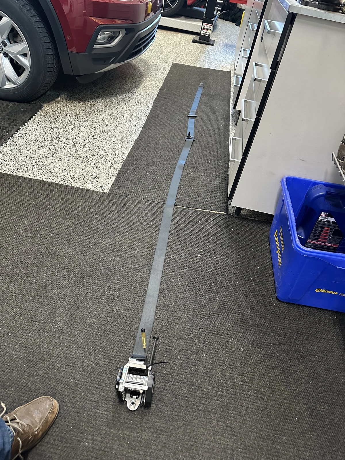

10. Carefully lay out the OEM webbing on the floor, complete with its OEM attached hardware (see photo below). Set the replacement webbing next to it, then cut the new webbing so it's the same length as OEM, giving extra length on the replacement webbing, for areas on the OEM webbing, that are folded/stitched.

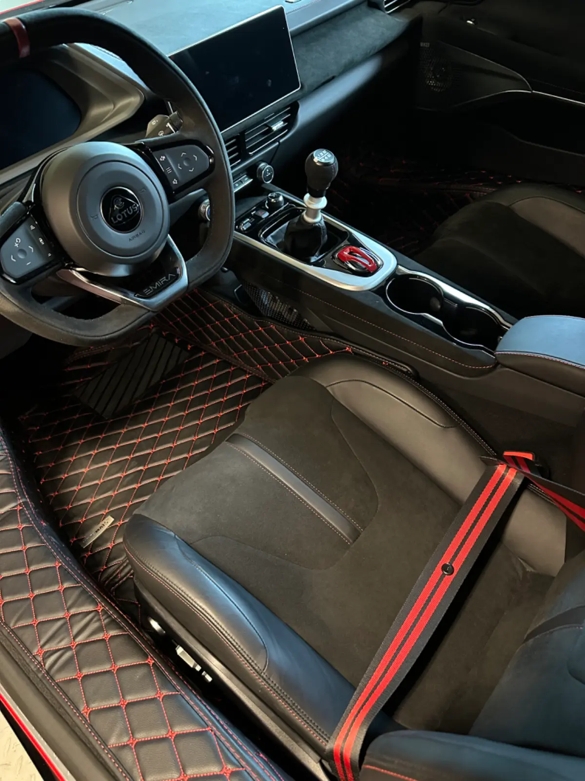

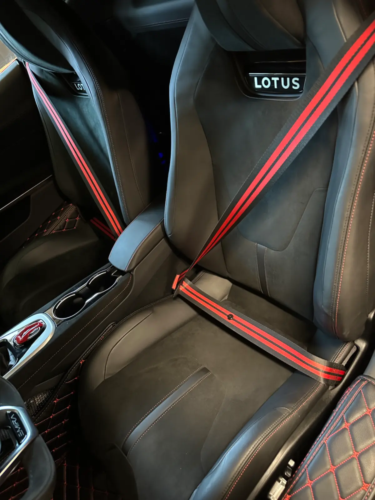

FYI, I purchased my new webbing from "AliExpress" since I wanted something different than simply a solid color. They had a much better selection. See the second last photo above, which shows my replacement webbing (black/dual red stripes) ready to go, in the background. Mine came as one long roll, which I first cut in half...then cut again once measured against each OEM length. Mine also came with new "plastic black buttons" that snap onto the new seatbelt (one each side of the belt), although if you don't get them with your replacement webbing, they can be easily found and my tailor offered me several choices.
