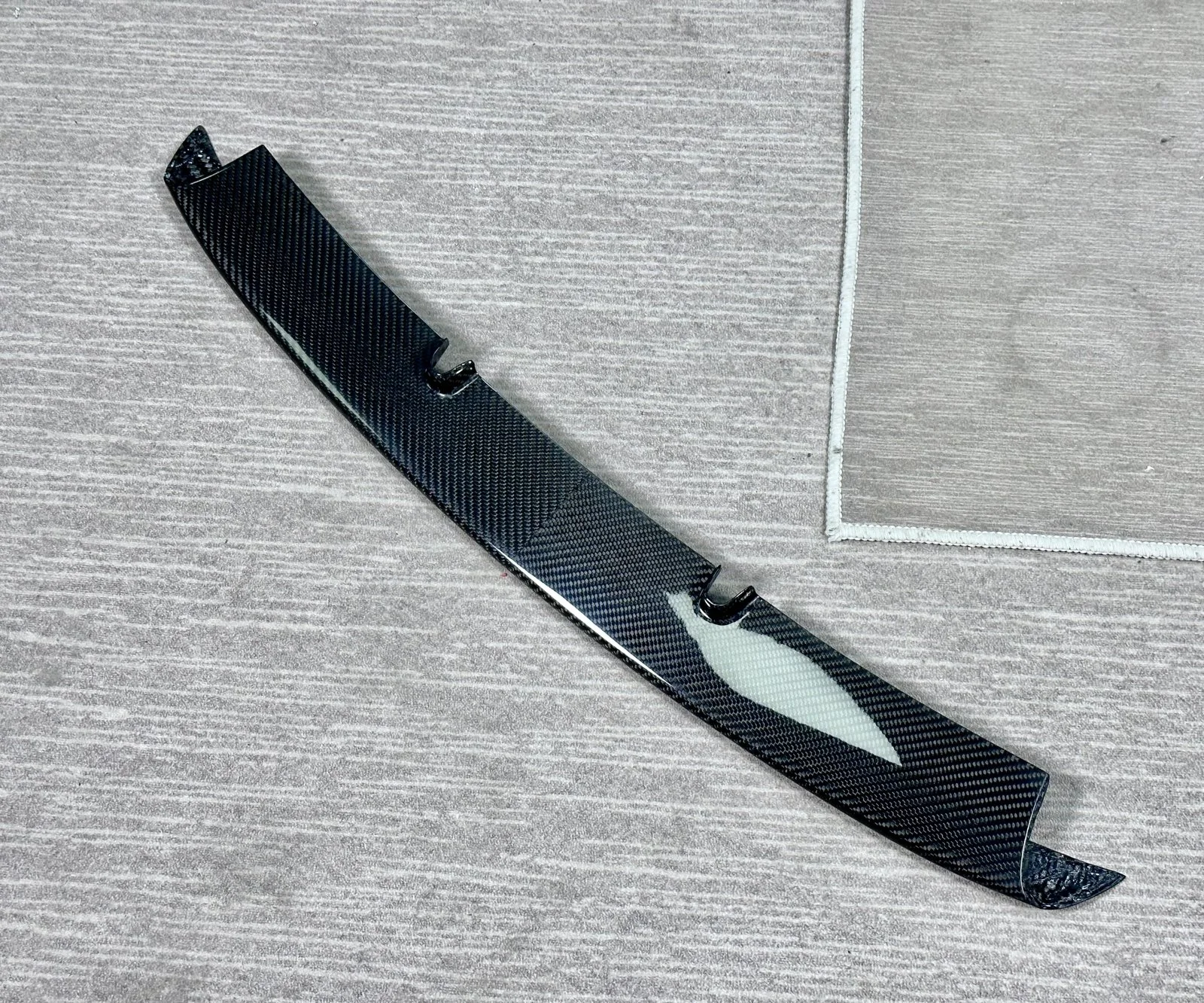

I wouldn’t order this part blindly until I knew the installation procedure. From what I’ve been advised by a Lotus tech, the front bumper removal and re-installation is a 2.75 hr job alone. Yes, nearly 3 hours to remove and replace the front bumper. That is a costly labour amount to replace this one piece, so I would prefer to install this part myself. If Aerie knows how to replace this part without removing the entire front bumper, I’d really like to know.
@Aerie can you please advise us on how to replace this part? Is it simple enough to explain here, or can you provide pictures to show how it is installed? Others are also waiting to hear back, and I’m sure they are holding off on placing an order until we find out what the installation procedure is like.

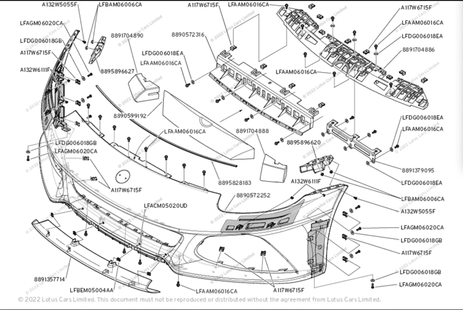

Thanks to @Martylemoo we have this. Looks simple enough.

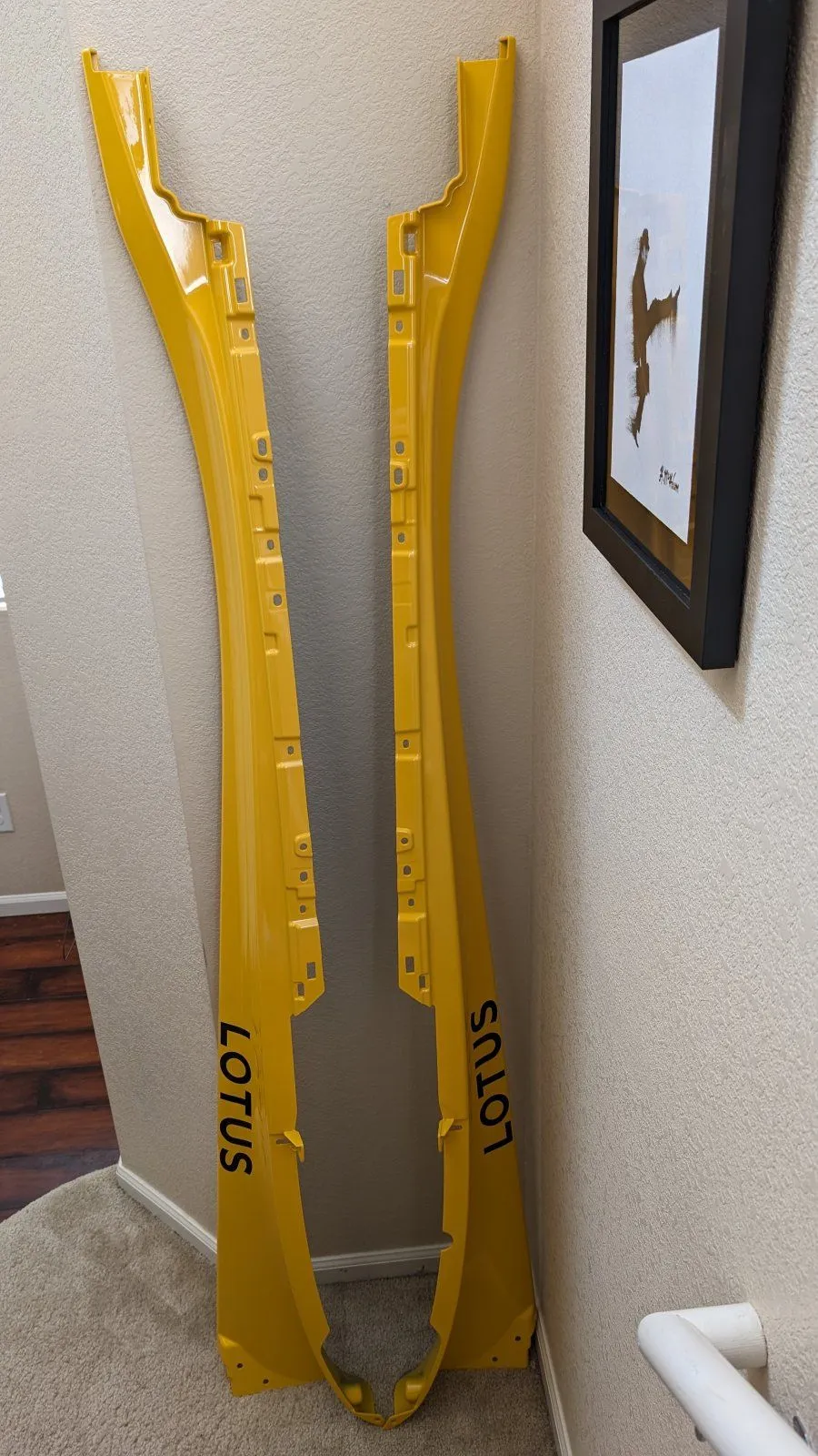

In the service manual these are called upper door sills. They're £800 for the pair and require 15-20 hours of labor to replace. This is because it means removing all the body panels besides the doors and the roof to access them.
It's been reported above that there are CF OEM ones coming, but no word on when.
Here's mine ready to go. Just be sure you want to go through that hassle.

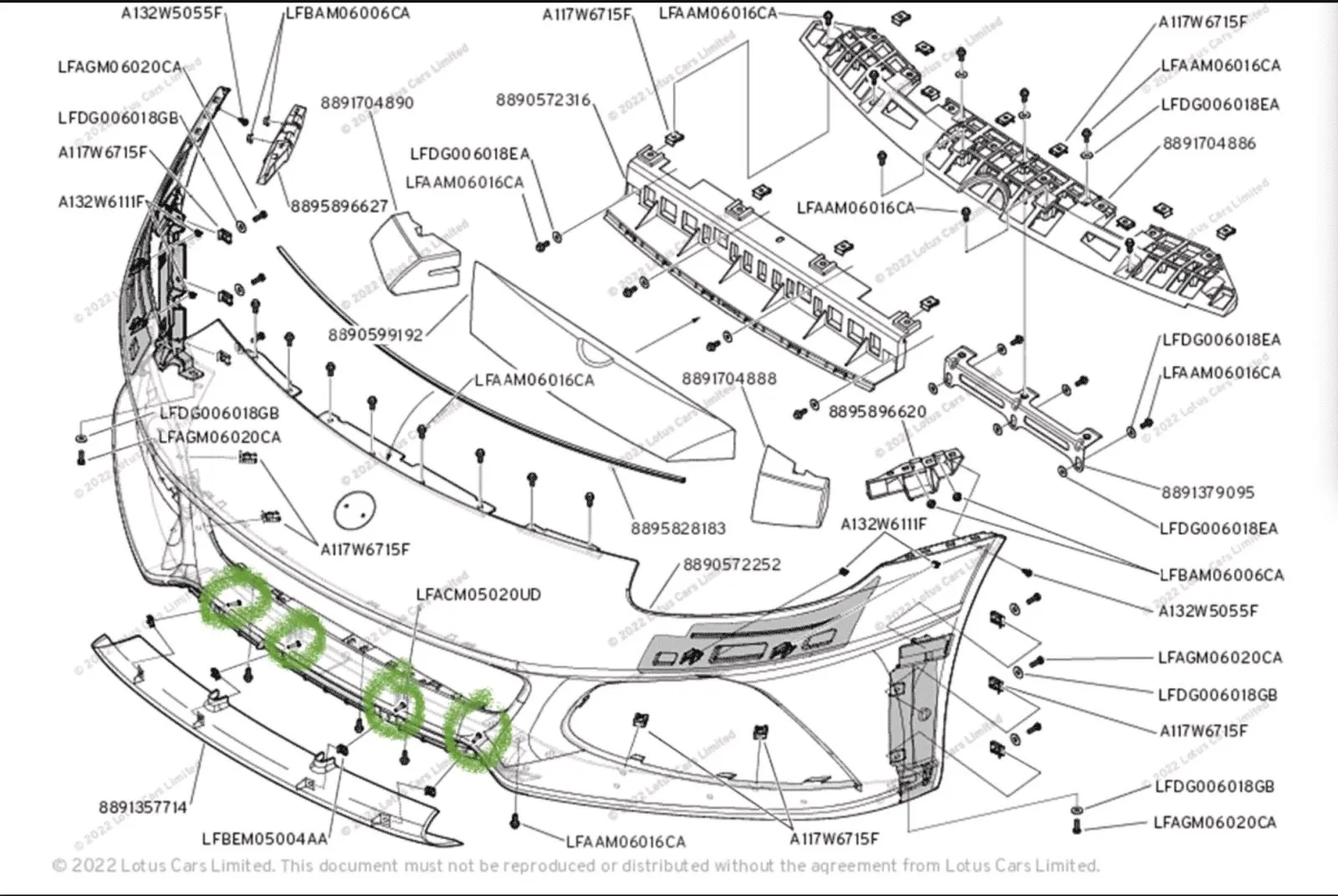

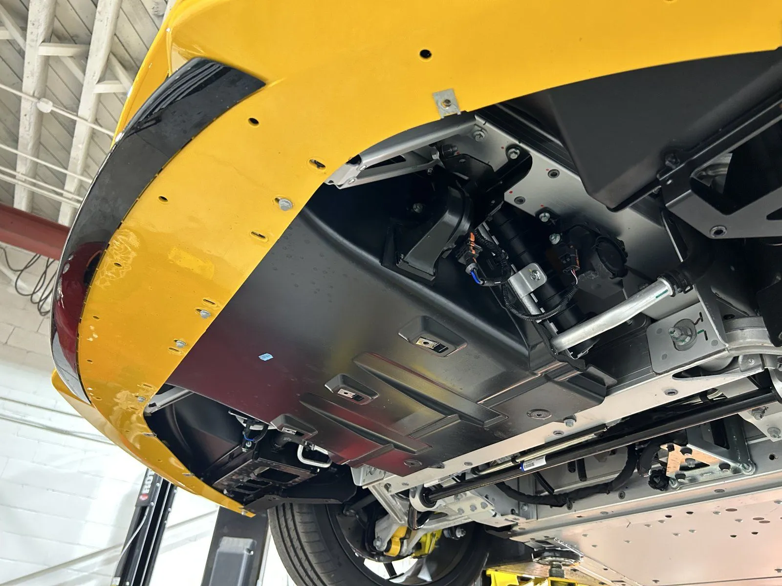

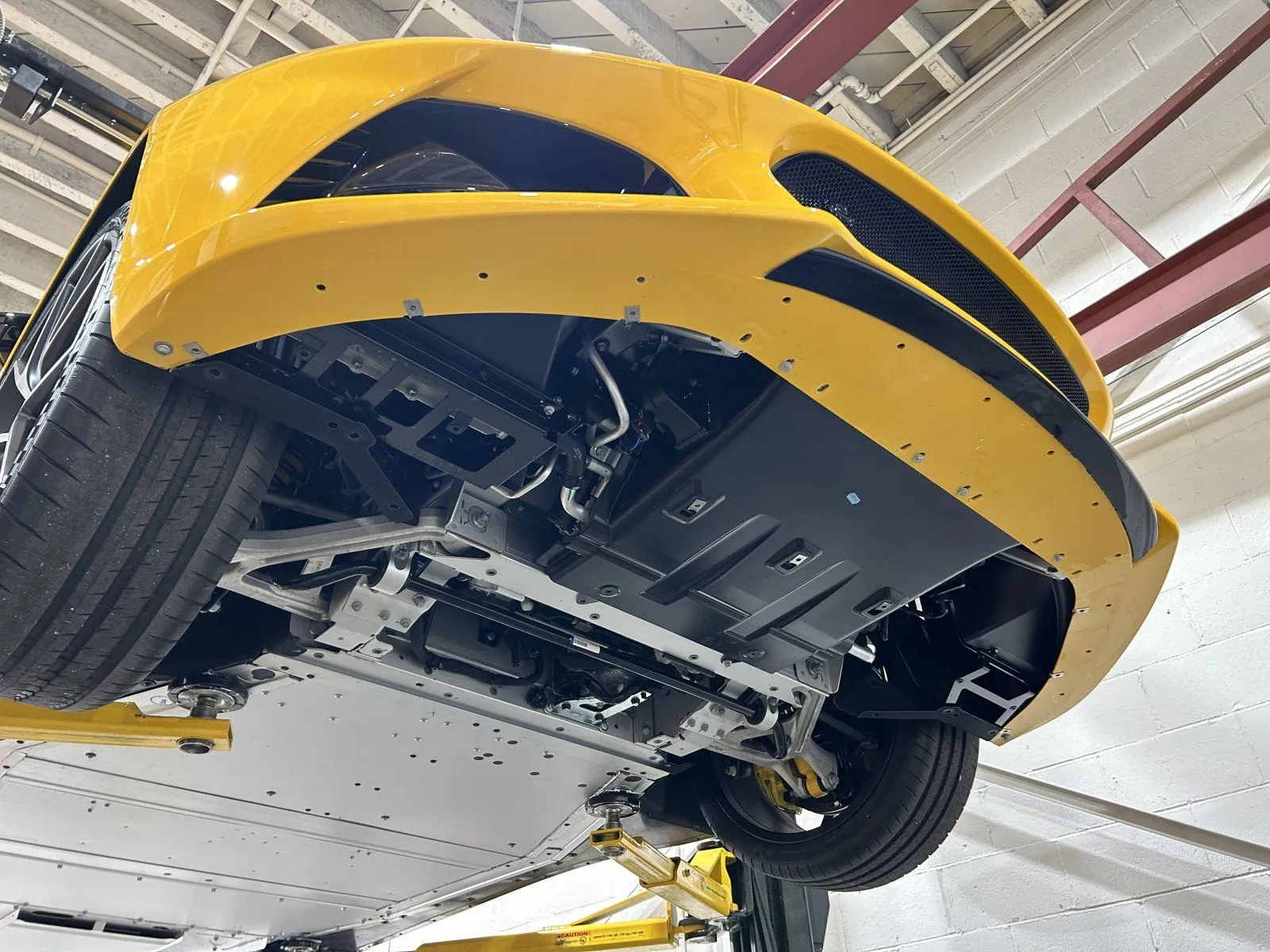

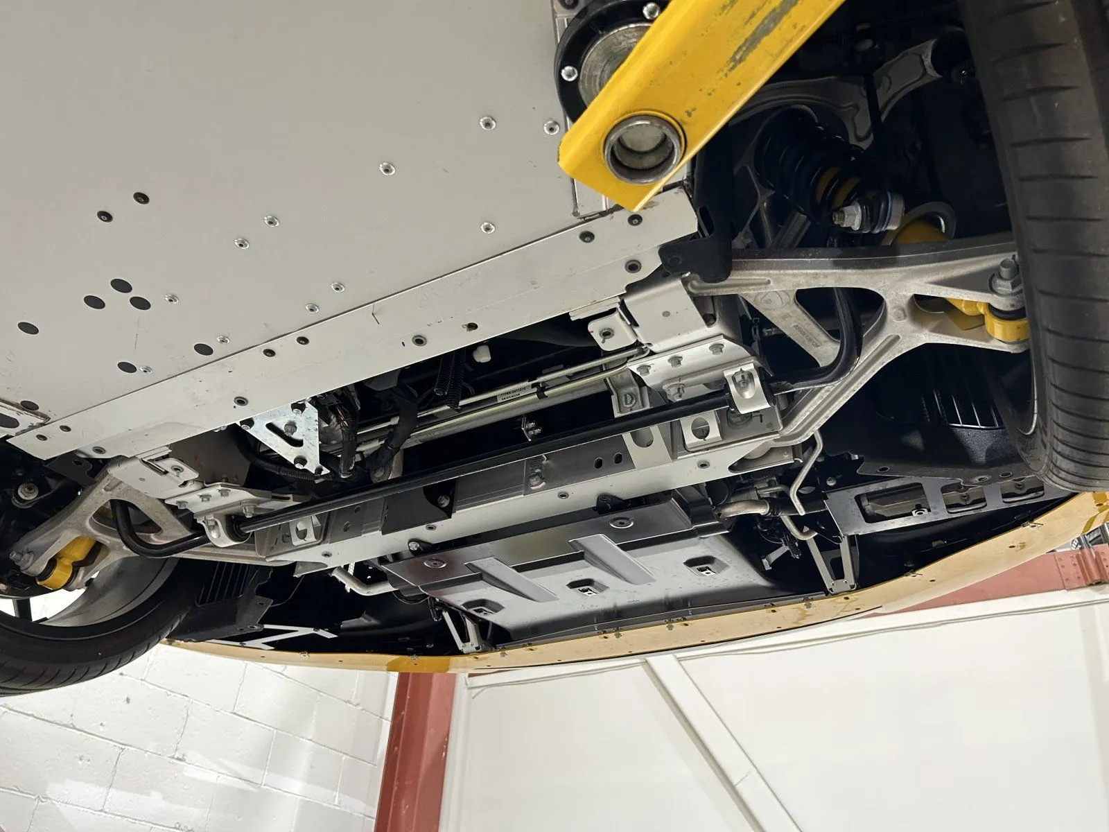

It looks simple enough on paper, but in reality, it’s much more complicated. These are pics of the front with the undertray removed. I had help recently from a Lotus tech at my dealership with another project I’m working on.
d7ccb1d0-e435-4e85-acc5-0dc4a573887c-jpeg.44143
As you can see, those 4 bolts/screws circled in green are only accessible after the entire front bumper is removed. As far as the Lotus tech and I could see, that’s the only way to get access to behind that front splitter. Don’t forget, there is a wire grille covering that front air vent, also preventing access to those screws. It’s a Tetris puzzle of interconnecting parts and fasteners under there. If @Aerie has cracked the puzzle and knows what fasteners can be removed to allow removal of that black plastic cover below the radiator, I’d love to know. There’s also an aluminum “floor” in that front intake chamber in front of the radiator that would also need to be removed.

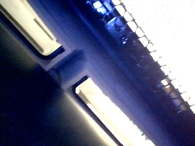

Here’s what it looks like from the inside. I took this picture using an endoscope. This is the back of one of those stanchions of the black splitter.
@Aerie has said the bumper needs to be removed, and everything I've seen confirms that. Everything about this car is a puzzle. If I had known before embarking on my door sill project I would not have done it. As is it's going to cost somewhere just shy of 10k, and that's not really worth it, but here I am.

And since I'm doing that, I'll do this splitter as well. The bumper is already coming off. What's another fifteen minutes?
By the way, the front bumper removal requires removing the access hatch (hood), under tray, and license plate plinth.
