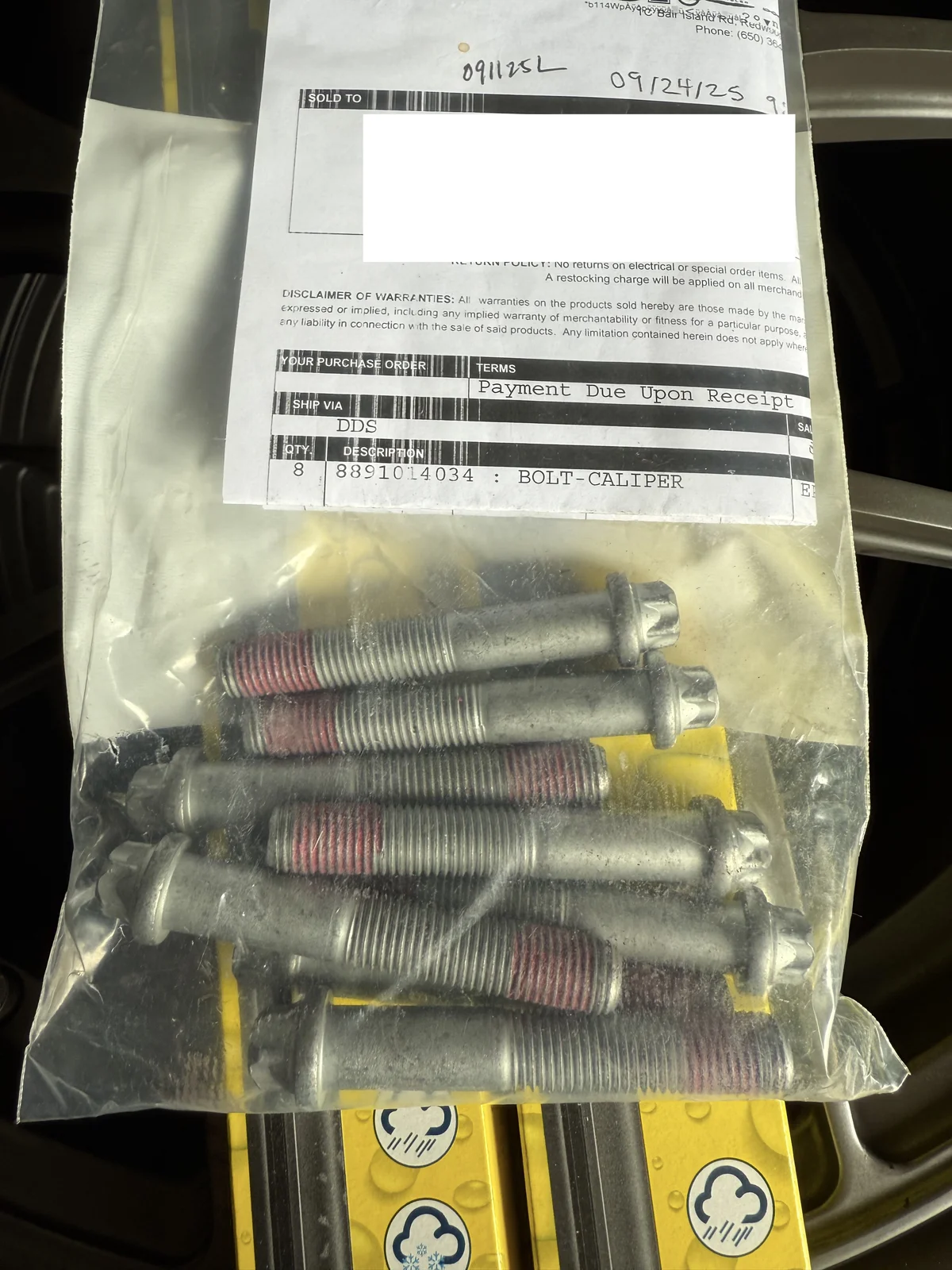

In a couple of other cars I've owned, the manual calls for bolt replacement because new bolts come with thread locker on them, and it's done that way to make sure the service bay techs don't forget.
I guess I'll buy a set of bolts and see if they're covered in thread locker. If they are, they're not TTY and I'll know for the future, but with brakes, better be safe than sorry.
