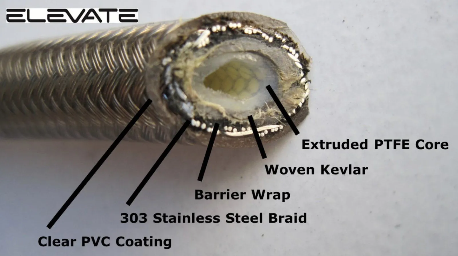

So they are rubber hose on the inside, and braided sleeve outside?
Basically exactly what you just said, I’m attaching an example and comparison with the standar ones normally installed
the wider track may or may not be a factor... if distance from spindle/caliper to the hard line mount is same it won't matter. I kinda doubt they made the control arms longer to get the width, but maybe. Did they change away from AP calipers?
That looks like a solid cable, with multiple fiber layers for dimensional stability.

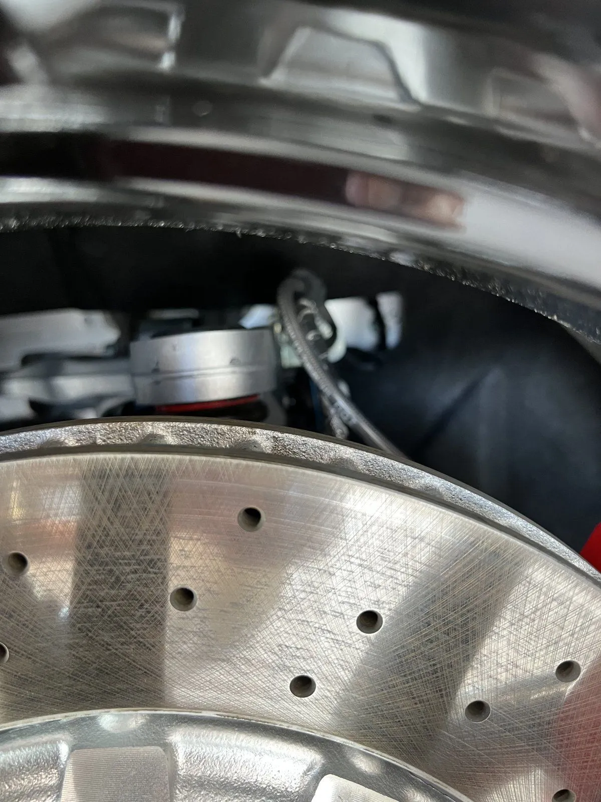

I think we could close the thread, on Harry's Garage viedeo (here: I visit Lotus factory to see my Emira in build) from the minute 7:00 it describes the suspensions and the braided stainless steel brake lines are clearly showed.
