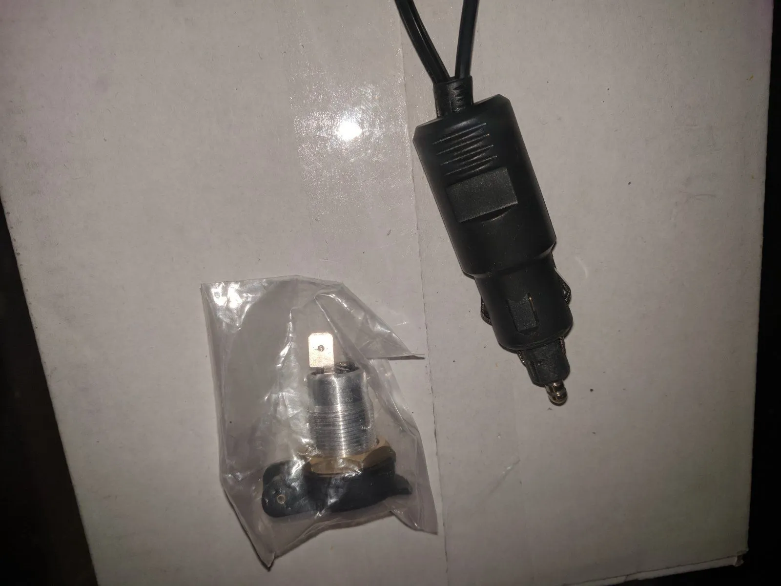

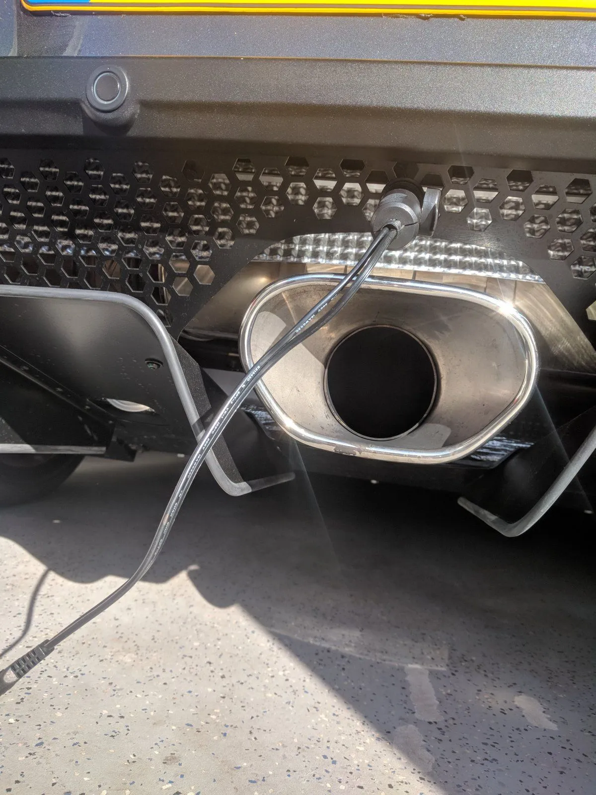

My simple fail safe Evora solution working now already for 1 year..........very easy connecting.........no kneel down.
Probably the same solution possible on the Emira.
No heat problems for the female connector located in the mesh plate above the exhaust tip.....
Actually the "chrome" muffler end does not become so hot as the inner circular pipe and therefore does not harm the female connector/wiring at all.........
Furthermore the location is almost invisible and can be accessed very easily.

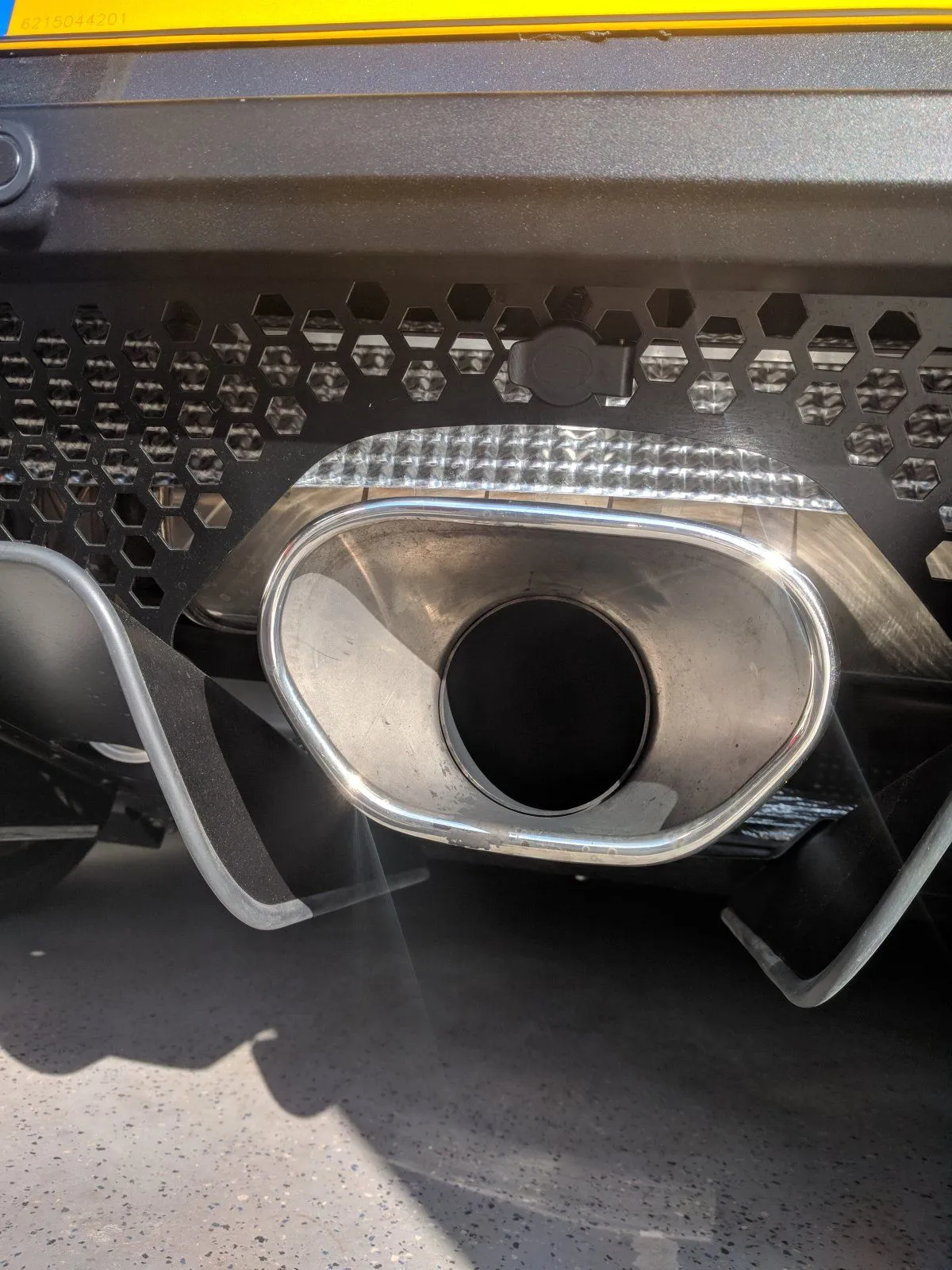

I admire your ingenuity, and it is reasonably neat in appearance, but there is no way I am chopping a visible hole and putting what looks like a trailer power hookup on my precious baby like that :)
Sir,
I did not need chopping a hole.......the female plug + spring loaded cover were mounted in one of the regular hexagon holes of the screen and from there easily connected to the lithium battery.
Furthermore it is not invisible in a standing man's eye distance of approx. 6 feet because it is covered by the rear frame.
At a more larger distance you could see it but it is black and tiny.........you really have to search for it.
BTW: If you can show me where the "trailer power hookup" is I will honor you with a lollipop emoticon

Ok, I'm big enough to put my hands up and admit defeat... That is not readily visible in your photo, and if it didn't require any cutting then it is a perfectly cromulent solution. I doff my cap to you sir :)
I bet it would drive me crazy just knowing it was there though 😂
