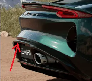

Hope the MagCode connector can fit under here. I think I'll go with the HethelSport kit, since it includes the CTEK cable which I need.

Elegant as the MagCode is, it does seem to be a solution looking for a problem with Emira. Assuming the layout for the Emira is the same as Evora (battery accessed via hatch in boot/trunk), a CTEK fly lead can be attached to the battery inside the boot. It’s a simple matter of opening the boot, connecting the lead and closing the boot again. The cable is small enough that it makes no impact on the seal. No need to cut holes in anything. I did this on my Evora with no problems at all. What is a useful accessory from CTEK is they have a fly lead with 3 leds on it so you can see at a glance if the red one is flashing and the car needs a top up. Then plug in. I have no relationship with CTEK apart from having used their products for many years.
