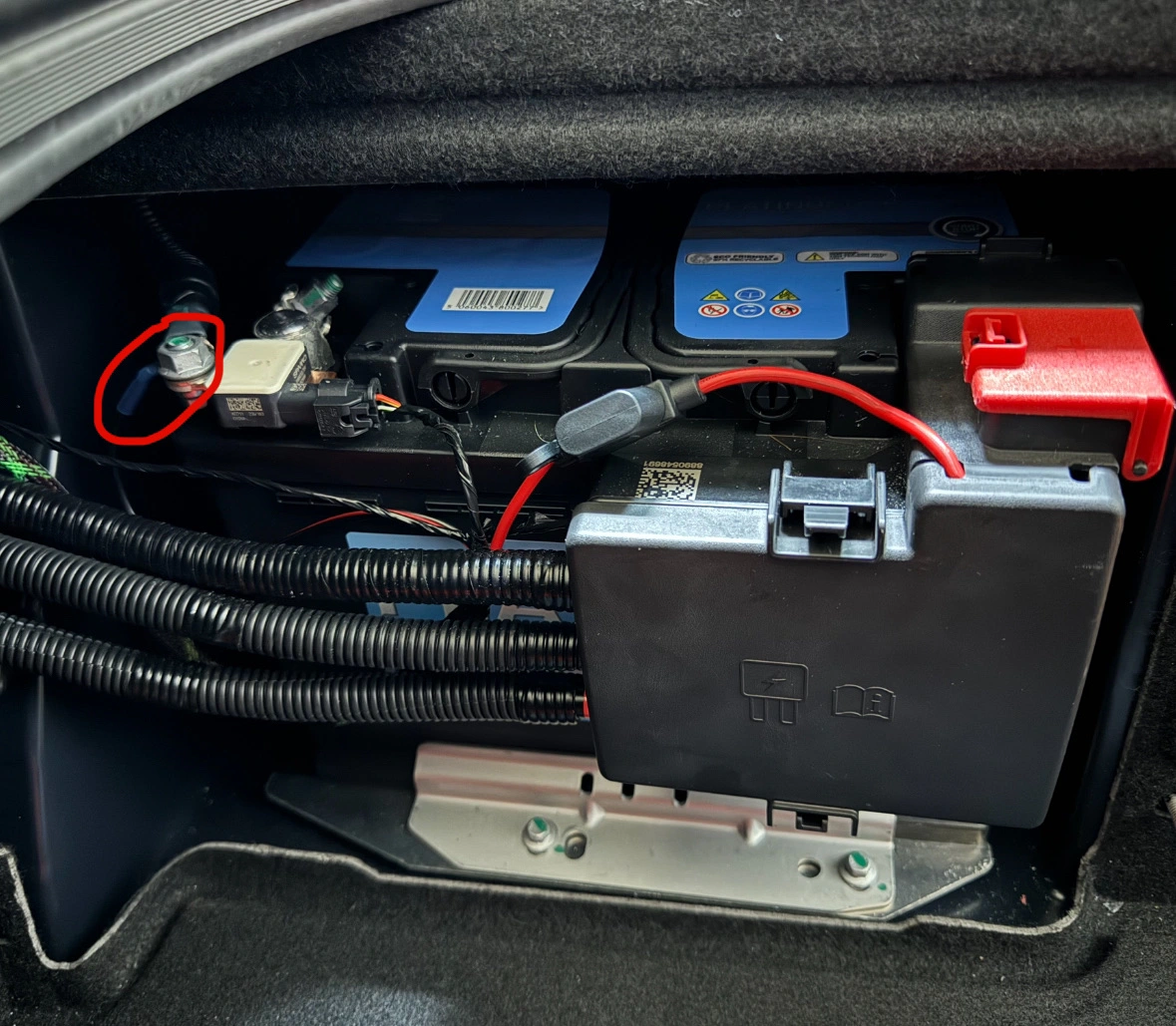

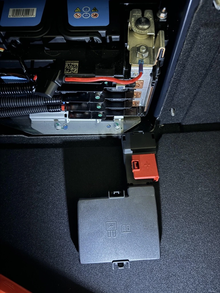

I didn't disconnect anything when installing the tender. Just connected the ground first, removed the inline fuse from the + lead, connected it to the positive terminal, then re-installed the fuse, no issues or codes. I've had it for over 3 months.
How did you get the cover off the positive side? I'm having a heck of a time trying to get that plastic cover out of the way. Thanks for any help and pics.
It unclips on the front and on the side. I fitted the pigtail for my tender under it and out towards the back from one of the hinge gaps.
