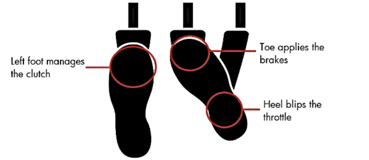

I find it pretty hard to heel/toe in the emira due to the very narrow pedal position and the throttle pedal being relatively short. Do you guys have any tips on how to do it properly?
In difference to the technique shown in the lower pic, do any of you guys find it easier to apply the throttle with the right part of the foot/toes as well (simultaneously to braking/foot on brake pedal) like shown in this video, at the very beginning (5sec into the video):

I do it all the time whether I like to or not.
Echoing what others have said, a pair of driving shoes make a huge difference. For street driving (light brake use) I use the 1st metatarsal to brake and blip the throttle with the right side of my foot while keeping my heel rested on the floor. For track driving, I actually heel toe.
No heel - but rather the sides of the right foot. What this means is that the right foot is partially on the pedals - to the very right of the brake pedal (bigh toe) and to the left of the accelerator pedal (little toe). Foosh above describes it.
I can do it with flip flops.
I don't find it too bad on the street with good driving shoes, I use the heal on the gas. Because of the seats I found it difficult on track to hold myself in place, and heal toe correctly. I now run a blip module for on the track, it is so much easier on the clutch and transmission, and helps with the track times. I leave the module turned off while on the street.
