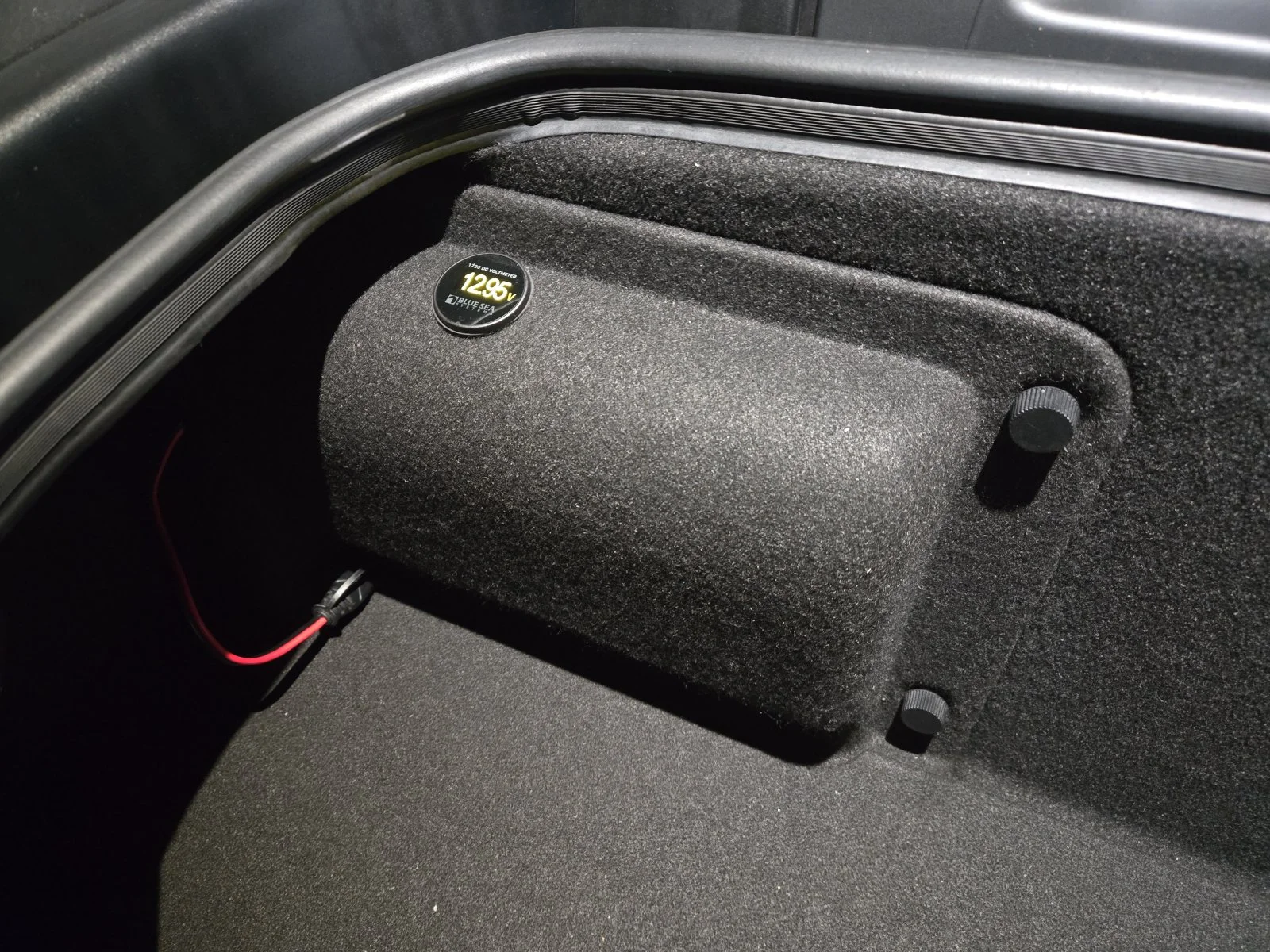

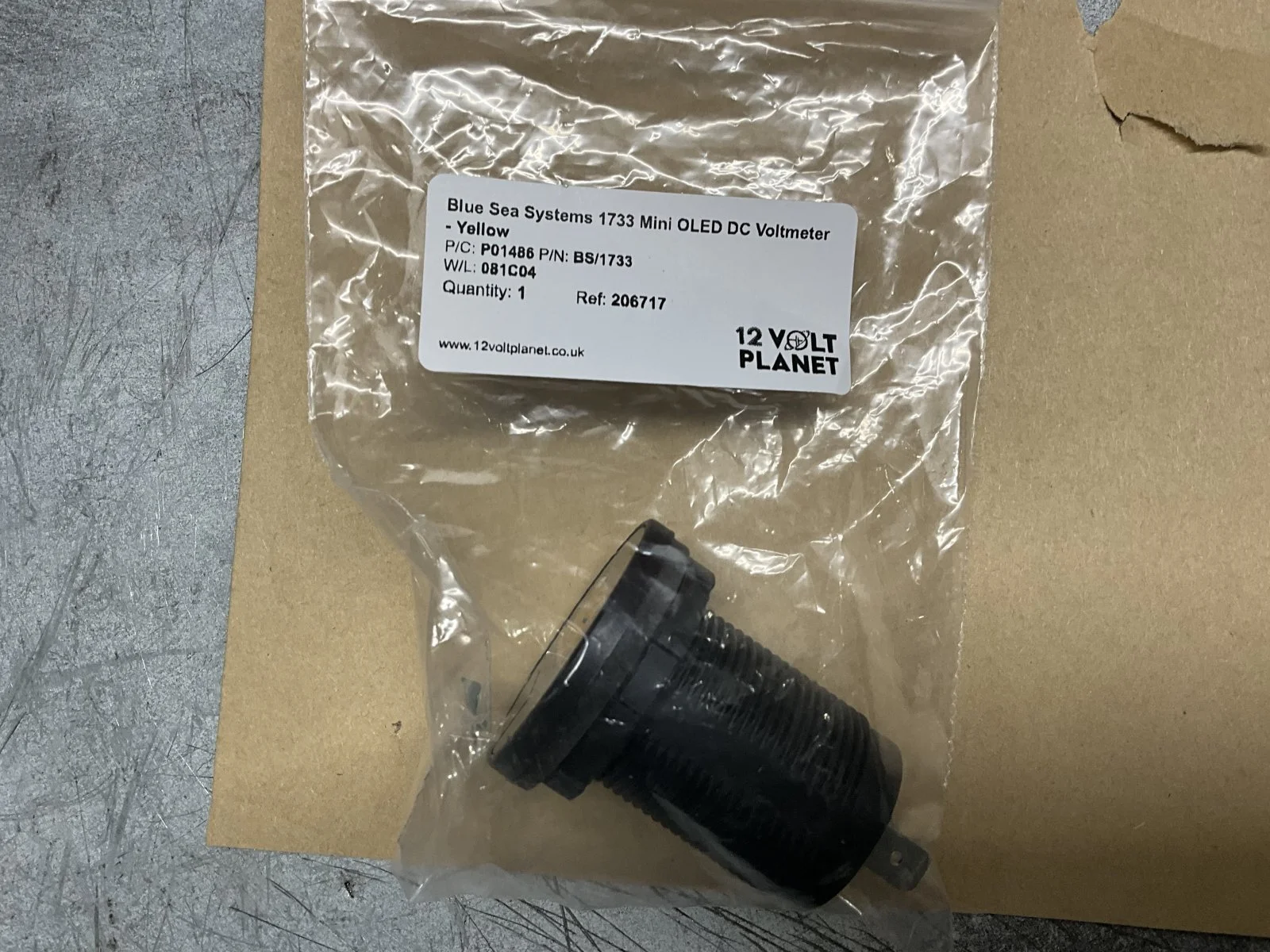

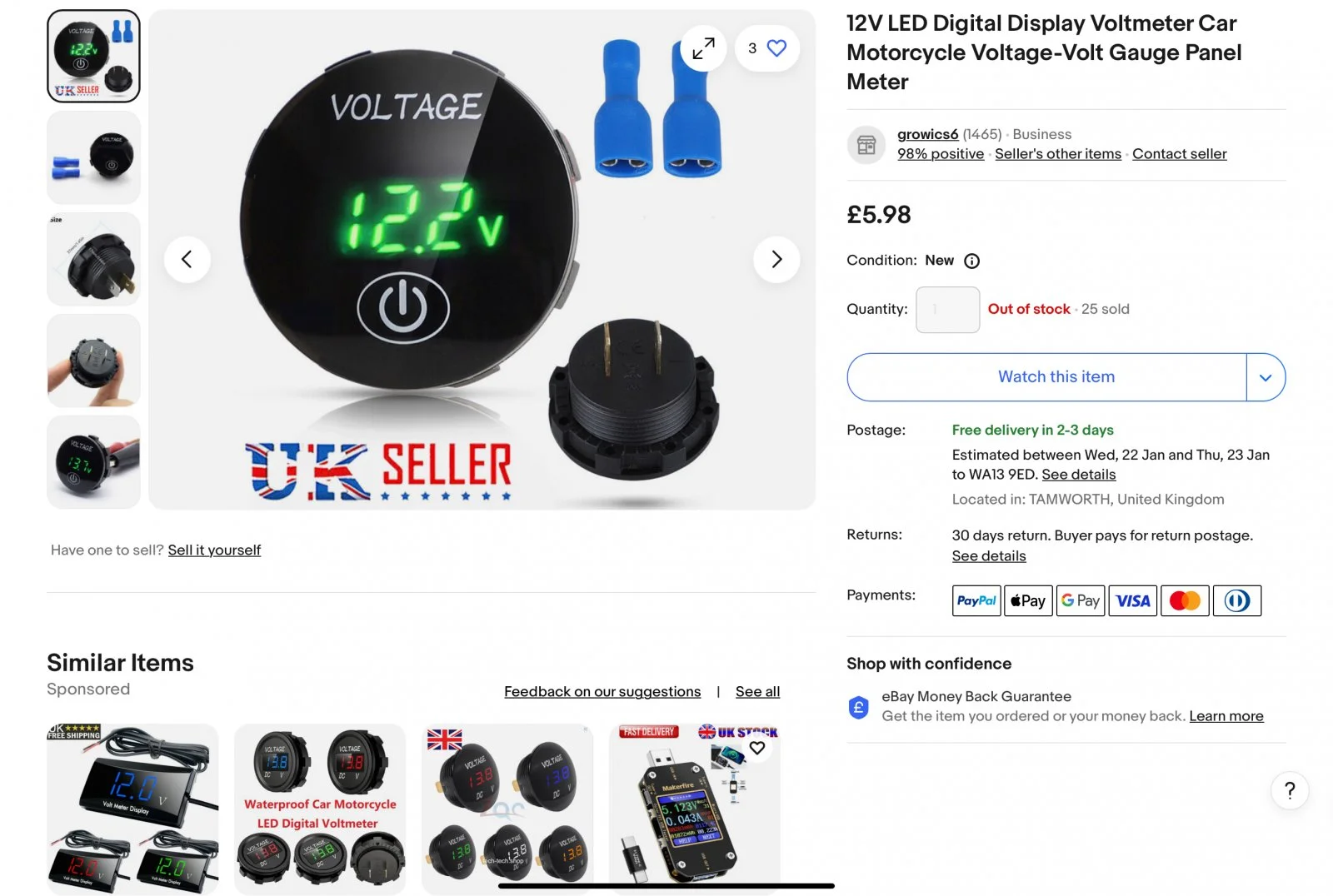

When my car eventually comes back from the dealer, I should be able to tell you the accuracy of the Tracker voltage as I will be fitting a voltage display across the battery terminals. I believe this will be the most accurate measurement, so I can see how much if differs from the tracker reading.
Let me know which one you use and how easy it is to install(I'm guessing easy)
I’m going to use this one. It’s just a matter of connecting across the battery and drilling a hole in the battery cover. Someone’s already done it on here. The installed picture is theirs.
