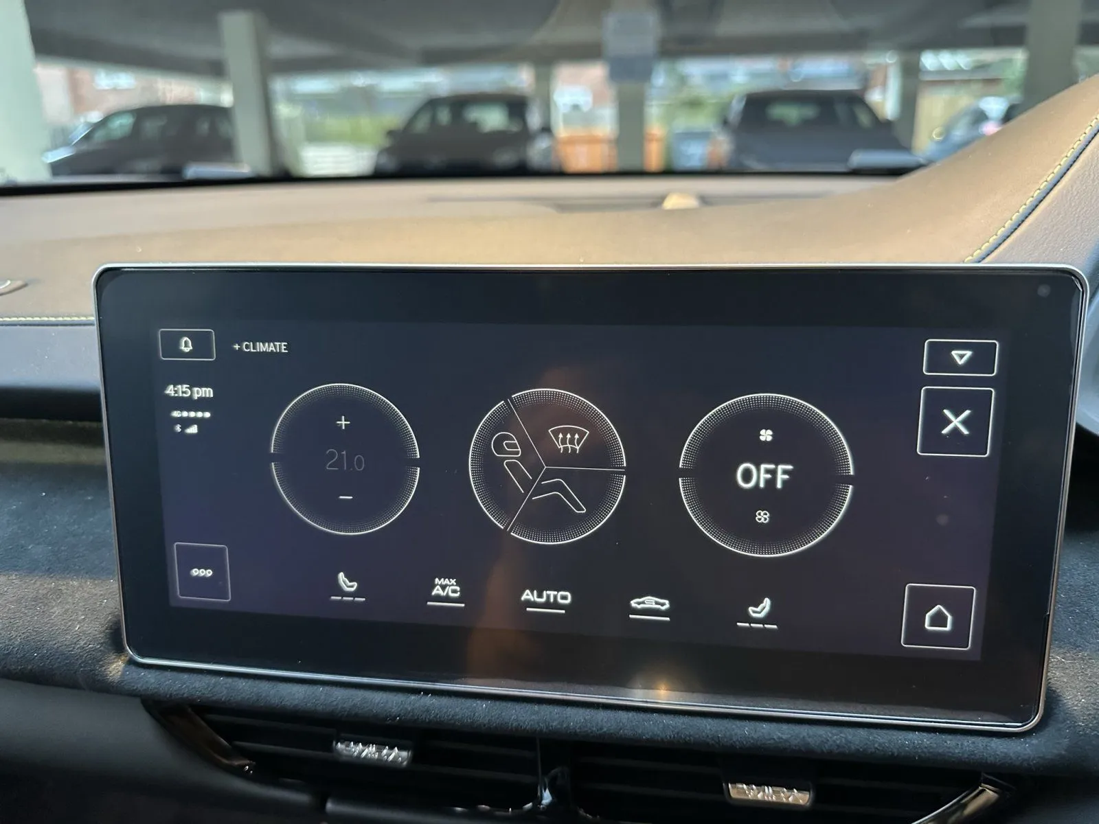

Does anyone know how you turn the air-con on AND have the heating on at the same time?
I have a air-con max button that overrides all the temp settings.
In the morning I like running the air-con and the heating at the same time as it de-mists perfectly whilst staying warm...
At the moment to demist I can:
1. have the aircon on maximum and freeze
2. have the window open and get similarly cold
3. turn the demist front screen button on and off as its too noisy to leave on the whole time

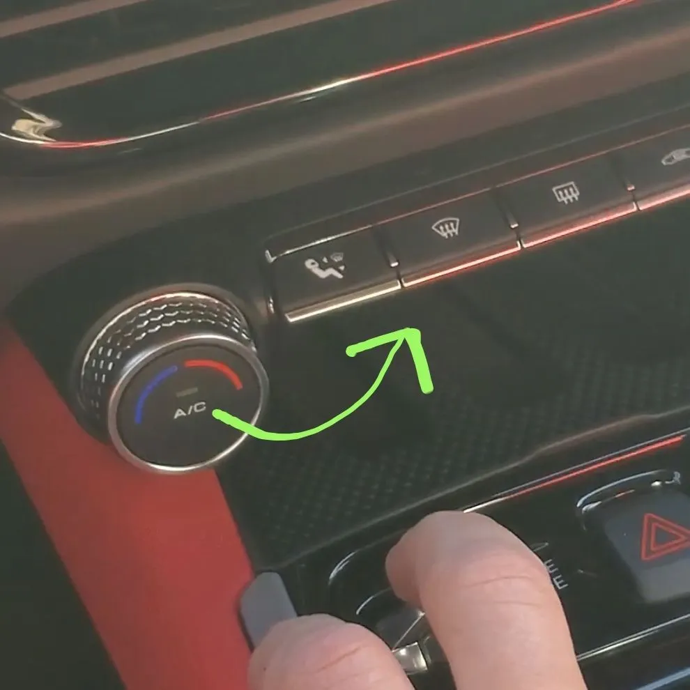

Might be obvious, but can't you just click one of the windshield direct buttons (one does face/feet/windshield and one 100% windshield), adjust the temp using the left knob to heat, then press the knob to turn on/off the A/C?

the more obvious the better.... as the answer is YES YOU CAN!
There's the solution I needed!
I was looking on the main screen and the only aircon button is "max A/C" and that over-rides all the other controls. By doing what you said and controlling the aircon on the manual button and then using the direction controls on the screen you can make it work...
Time to test how effective it is on the way home...

The windshield demist/defog function on almost all modern automotive systems is designed to run the heat and the A/C at the same time, essentially using the A/C as a dryer while heating the airflow. There's no need to manually set or configure heat and A/C independently, that's a thing we needed to do back in the fully manual control days.
The front defrost/demist/defog button looks like this:
The one for the rear window is the same but the icon is rectangular, and uses in-glass heating elements rather than the HVAC. In many cars it the rear defog button also engages the defrost/defog circuit in the side mirrors, or other accessory defrost features.

Works perfectly- thanks for correcting my stupidity!
The journey home was warm and cosy and nice and demisted!!!
