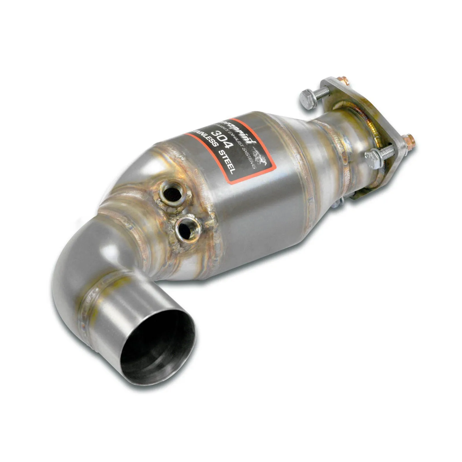

Looks like an Italian company called Supersprint got a hold of an Emira from an Italian Lotus dealer and built a exhaust as well as cat delete.

Looks like an Italian company called Supersprint got a hold of an Emira from an Italian Lotus dealer and built a exhaust as well as cat delete:
Performance sport exhaust for LOTUS EMIRA 3.5i V6, LOTUS EMIRA 3.5i V6 (405 Hp) 2022 ->, Lotus, exhaust systems
Performance sport exhaust for LOTUS EMIRA 3.5i V6, LOTUS EMIRA 3.5i V6 (405 Hp) 2022 ->, Lotus, exhaust systemswww.supersprint.com
No price and not sure how it sounds.

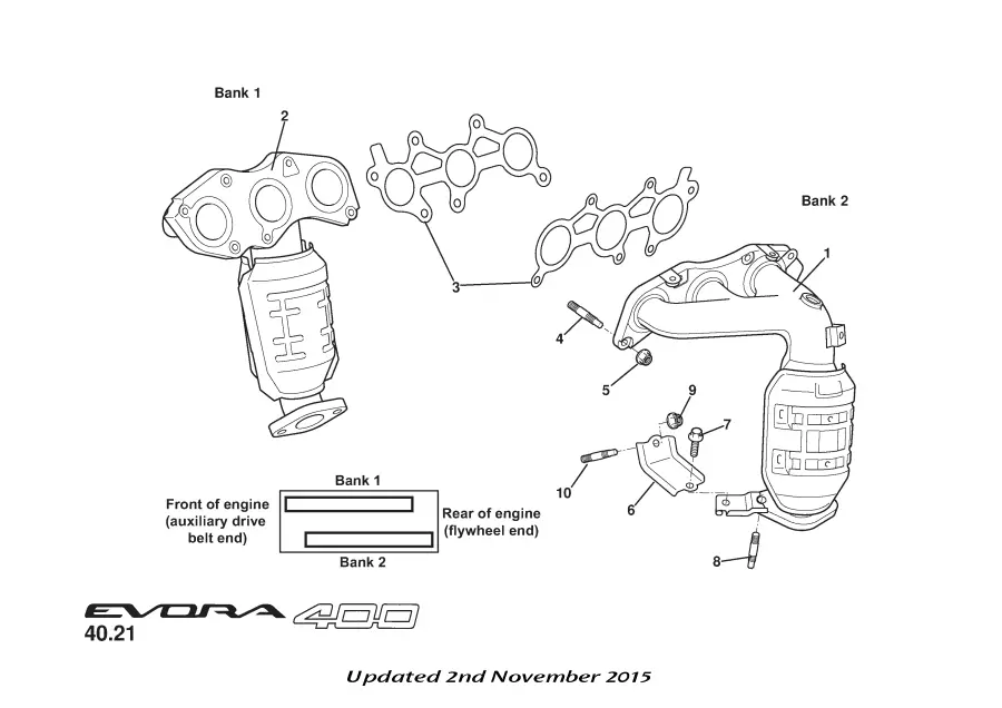

Yes each one is attached to each exhaust side bank.I have been searching on the Internet to see what the Evora's exhaust looks like and I can't for the life of me figure out where there can be three cats. I see the exhaust manifold has two bumps on them, are these the other two cats, one for each bank?
The Supersprint solution uses headers without cats. Therefore you need to have Lambda sensors further downstream behind the new main cat so no CEL will occur. Extension cables are needed then for the lambda sensors. That's the same solution Komo-Tec uses for complete exhaust system on the Evora.Looks like there are lambda's after the the cat so wont' be a swap without ECU work ...
Ah, no headers listed for the Emira yet that I can see...The Supersprint solution uses headers without cats. Therefore you need to have Lambda sensors further downstream behind the new main cat so no CEL will occur. Extension cables are needed then for the lambda sensors. That's the same solution Komo-Tec uses for complete exhaust system on the Evora.
