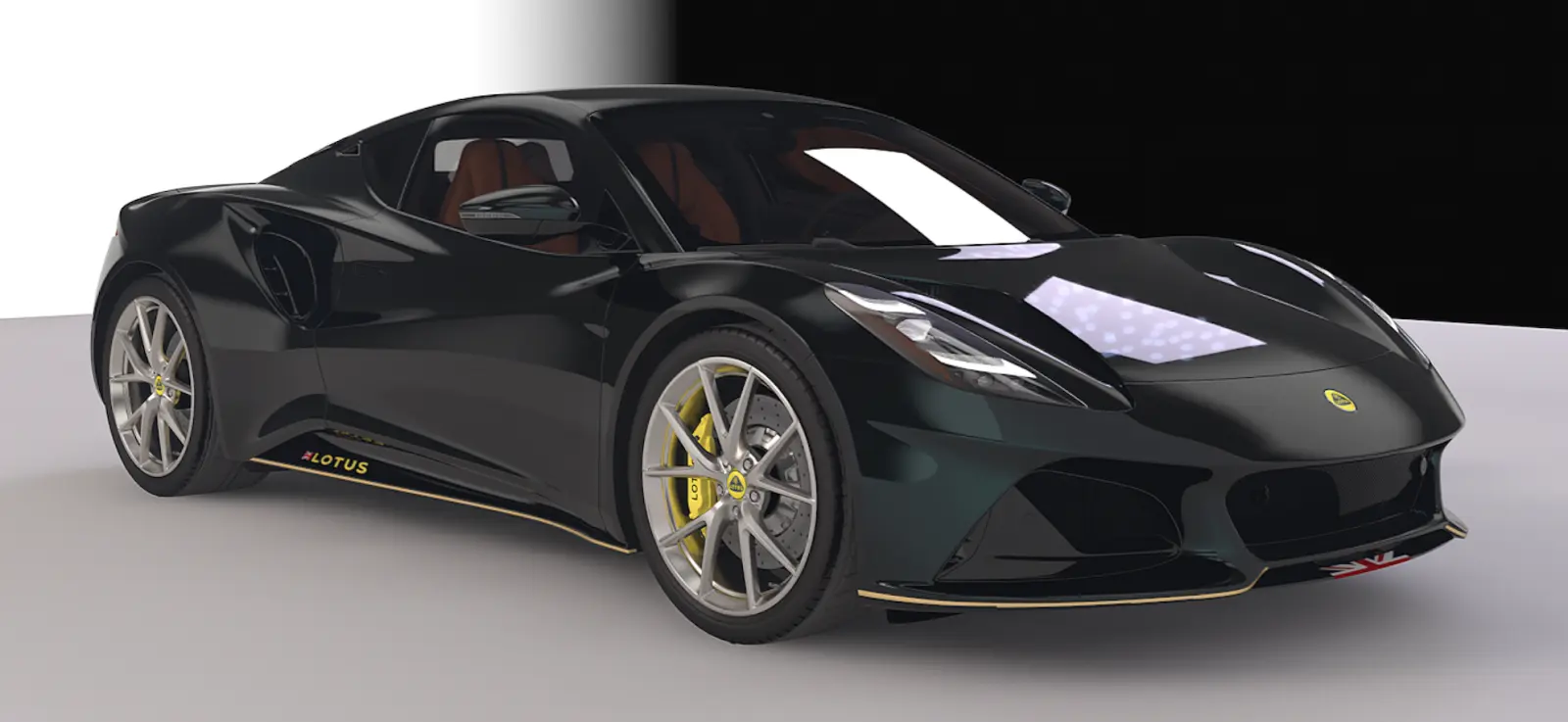

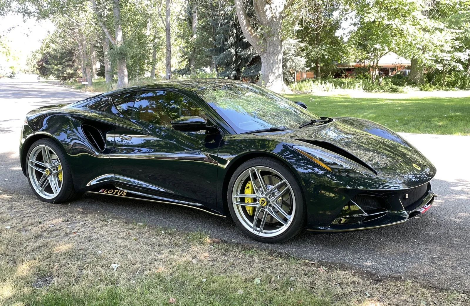

Okay. FINALLY got some good weather (great actually). Got some decent shots of the car. This is with the new graphics theme. I first worked this idea out on my computer, as a 3D render:
Here's how it actually turned out on the car:

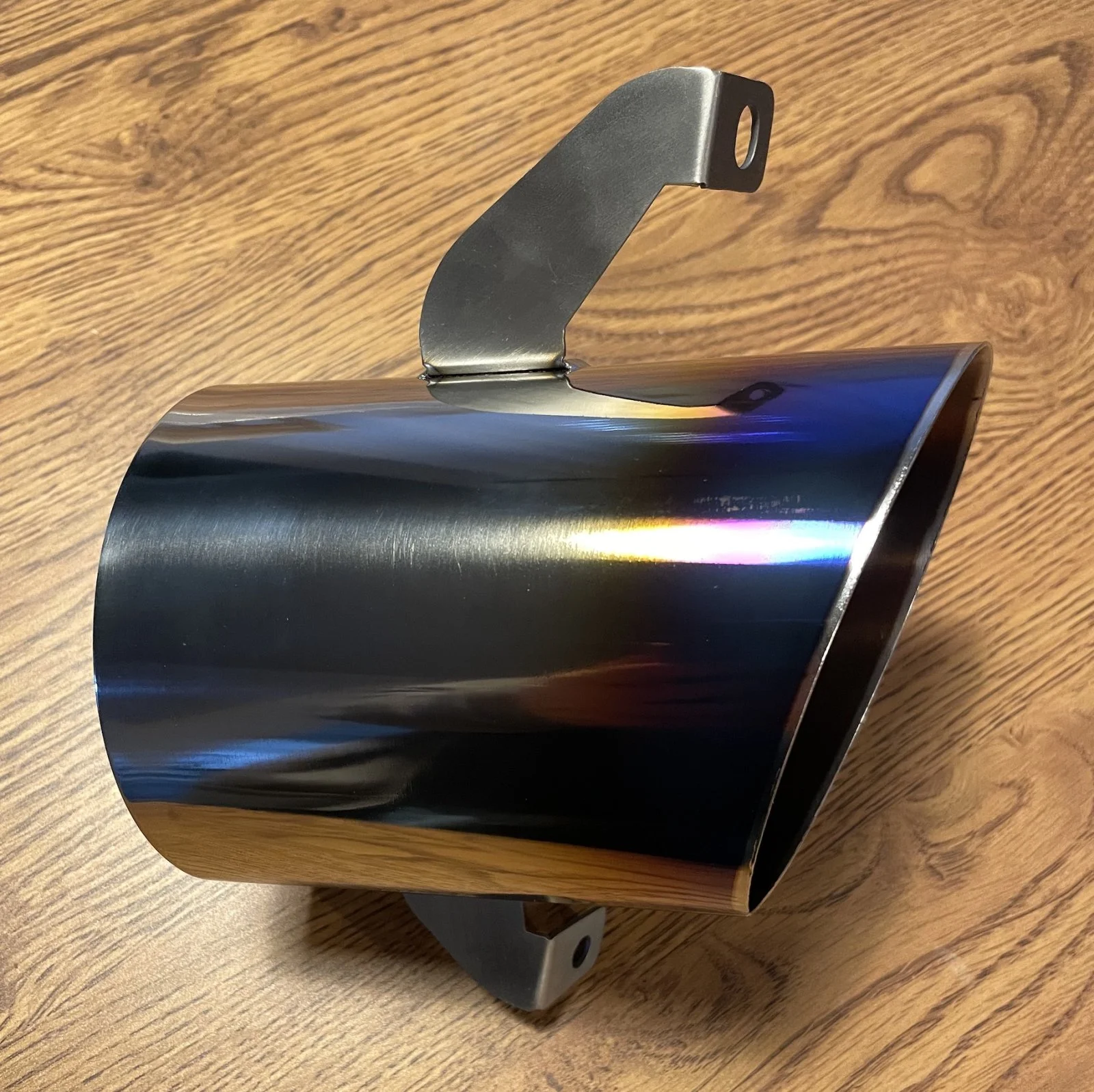

The @Aerie Titanium Exhaust
It's boomy at 2k rpm and under, but above that it sounds great. This is in Tour mode. It's not quite resonance boomy, but it's right on the edge. I believe I know how to fix that though. I had this same sound issue on my Alfa when I installed a cat-back exhaust. It turned out the end of the exhaust pipes barely went into the exhaust tips, and as a result, the exhaust was coming out INTO the inside back of the car, instead of out behind the car, if that makes sense. This was causing the back of the car to resonate the exhaust frequencies. The solution was to get a couple of 4 inch exhaust pipe extenders for the ends of the exhaust pipes, so the exhaust was coming out outside, behind the rear body panel instead of into the inside of it. That solved the problem completely at all rpms.
I looked when I got home and sure enough, the exhaust pipes of the Aerie exhaust barely extend into the far back of the exhaust tips, so I suspect that's the issue (this may also be why the Aerie installed so easily). I'm going to get at least a 3", maybe a 4" extension for both sides and see if that solves the boom.
The exhaust sounds gnarly at all rpms in Sport Mode. As far as driving feel, I only drove it for a little bit, but it feels like it has a bit more torque. It's going to be interesting to see what the dyno says.
EDIT: after taking some measurements, I think a 2" extension would do the trick. The pipe is just barely in the back of the exhaust tip. I also still have the issue with the pipes being low instead of in the middle. I tried every kind of adjustment I can think of, and I don't know what it would take to fix this, other than having the pipe cut and re-welded to aim it higher. Is anybody else's exhaust pipes this low?

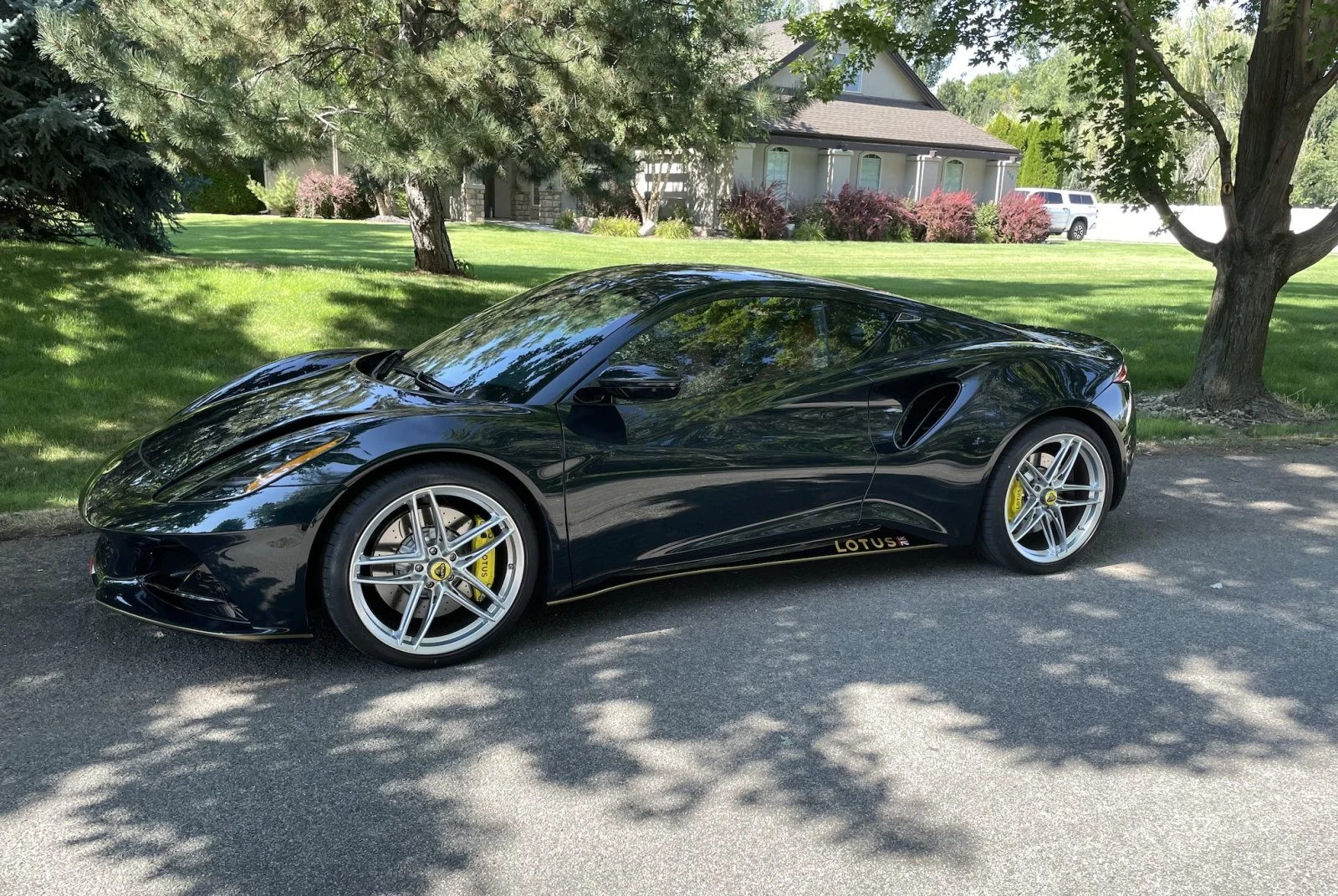

@Eagle7 those wheels look A-MAZING, especially with the yellow centers.
If that style wasn't as close to our Vantage wheels, I would definitely love to have those on my Nimbus.
These would look great on a Nimbus. They're much sleeker than the ones on your Aston.

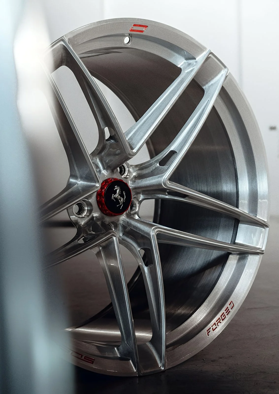

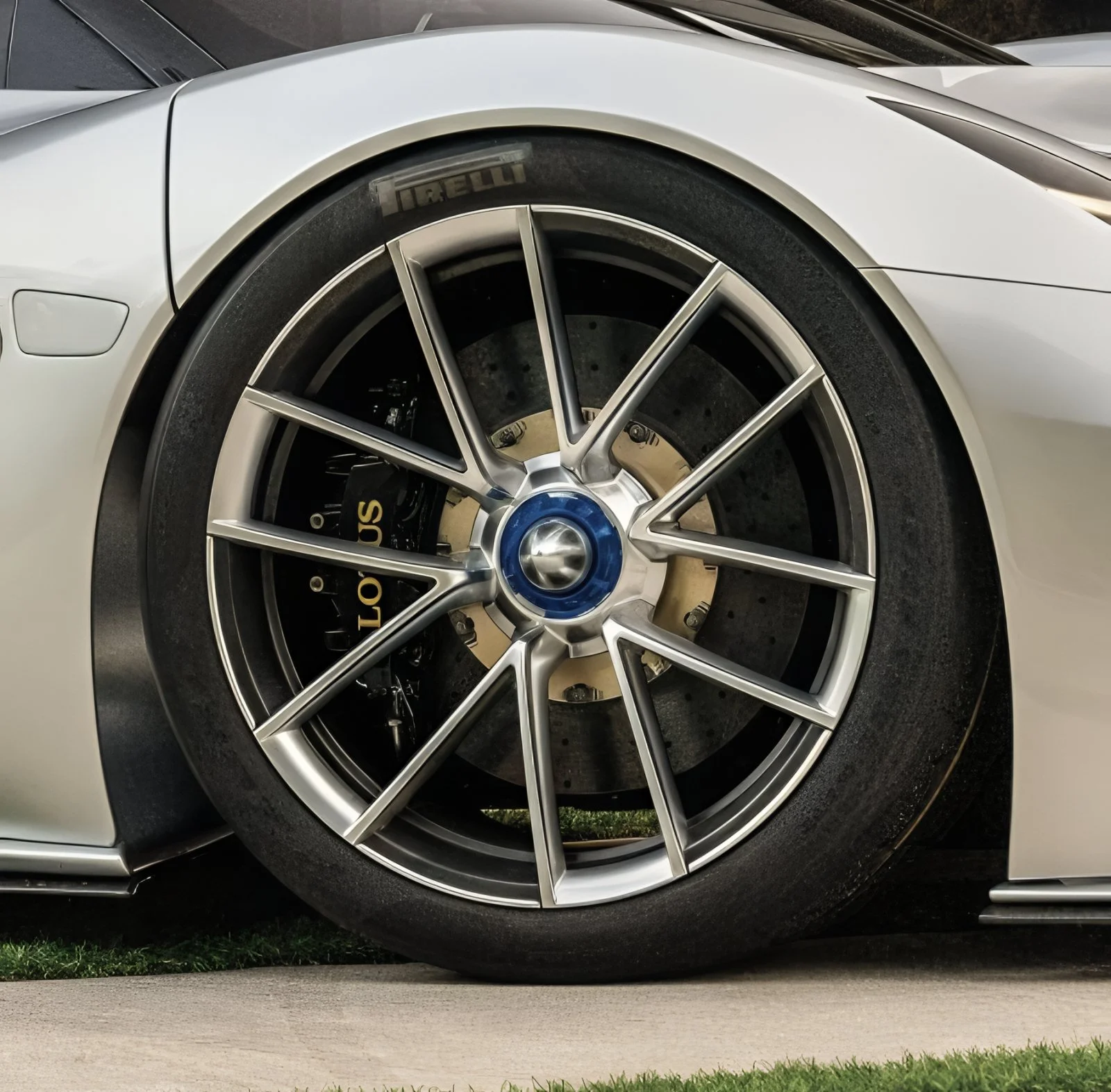

I originally was looking for a 5 spoke version of these that were shown on the Evija:

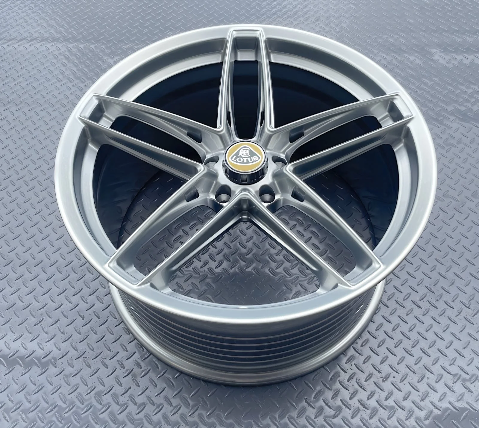

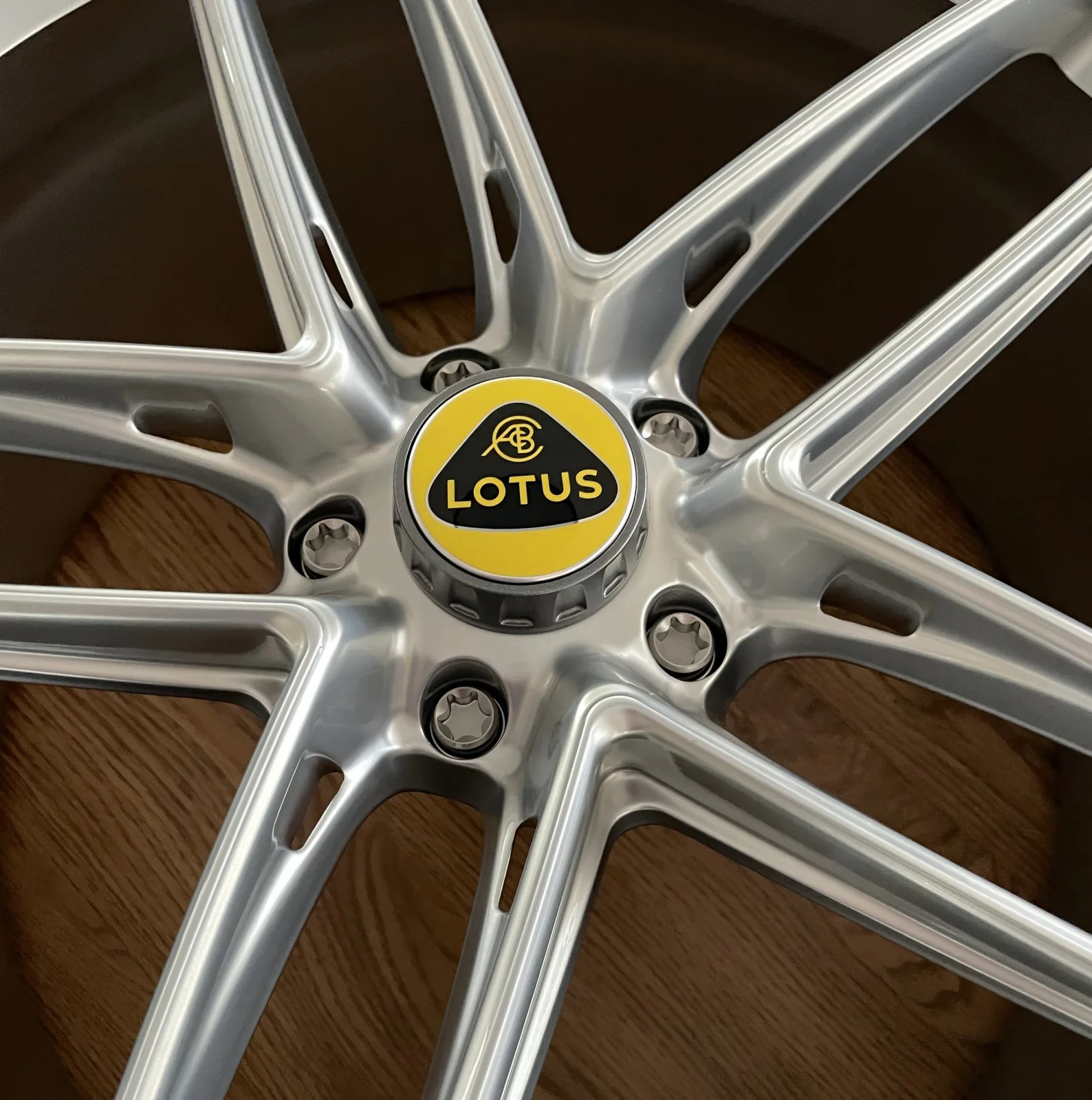

I asked @Aerie if they could make a variation on those, except I didn't want the spokes going out over the edge of the rim like that, and of course they had to fit the Emira's sizes and offsets. This is what they came up with:
I think they did a terrific job. They actually look better in person than in photos.
I chose the silver finish because I have DV, but they'll put any kind of color finish on it you want. The Lotus factory wheels look good, but to me these take it to the next level.

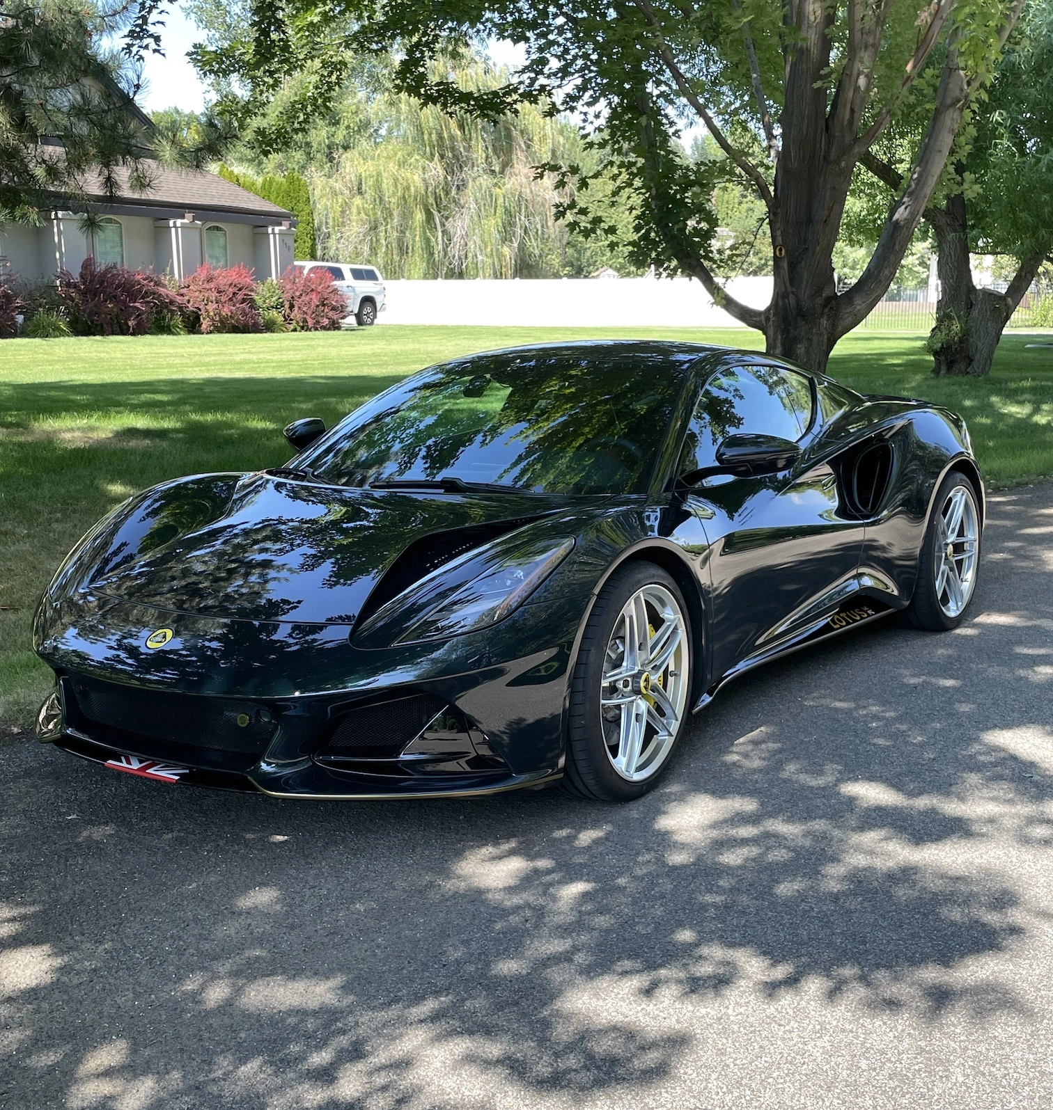

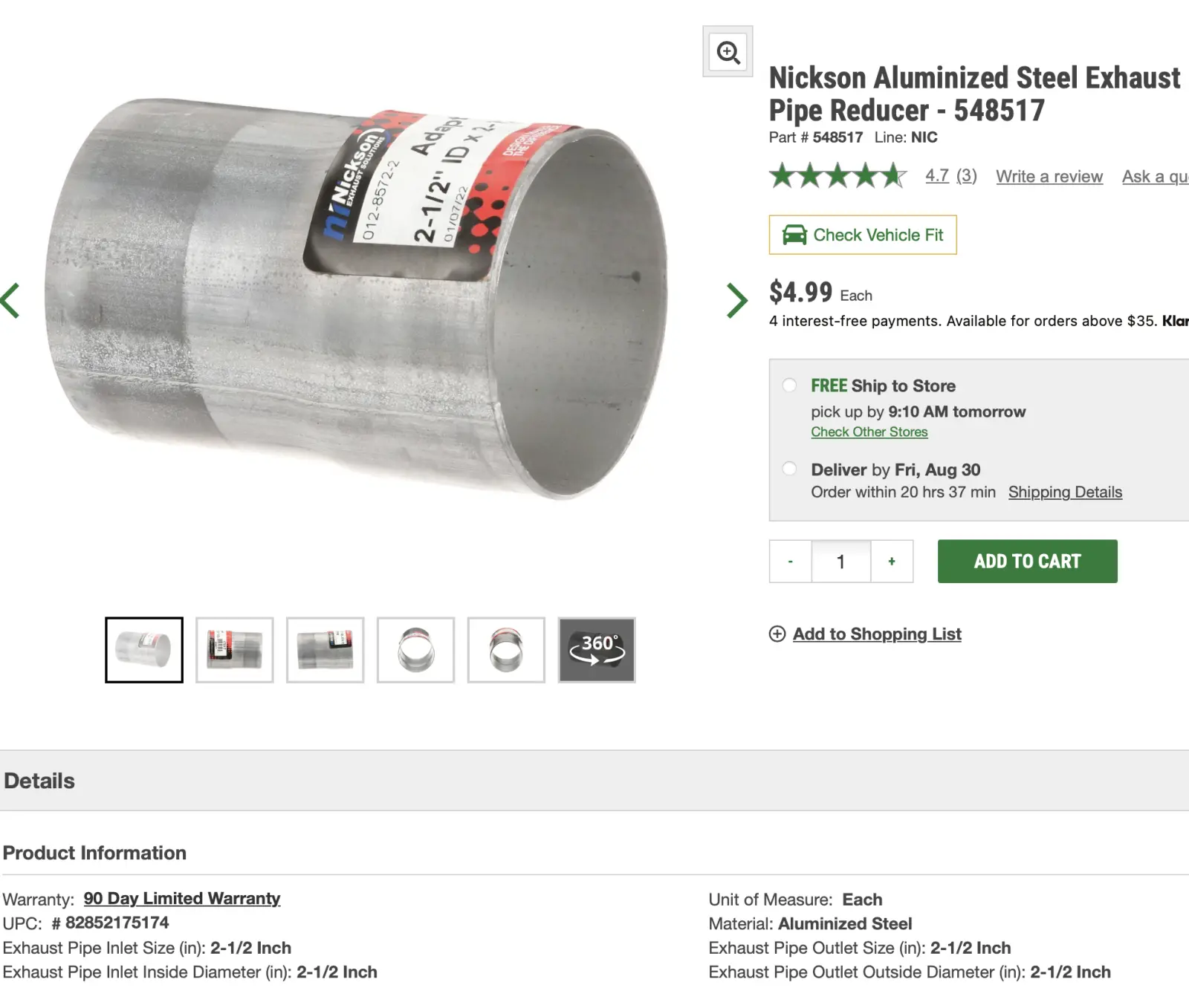

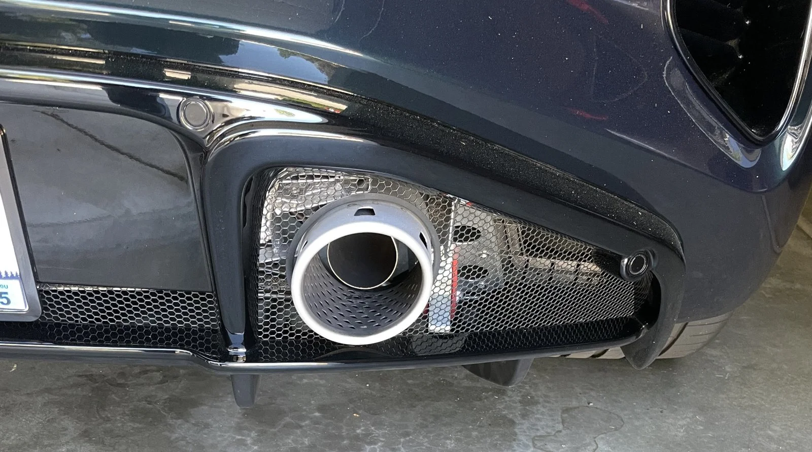

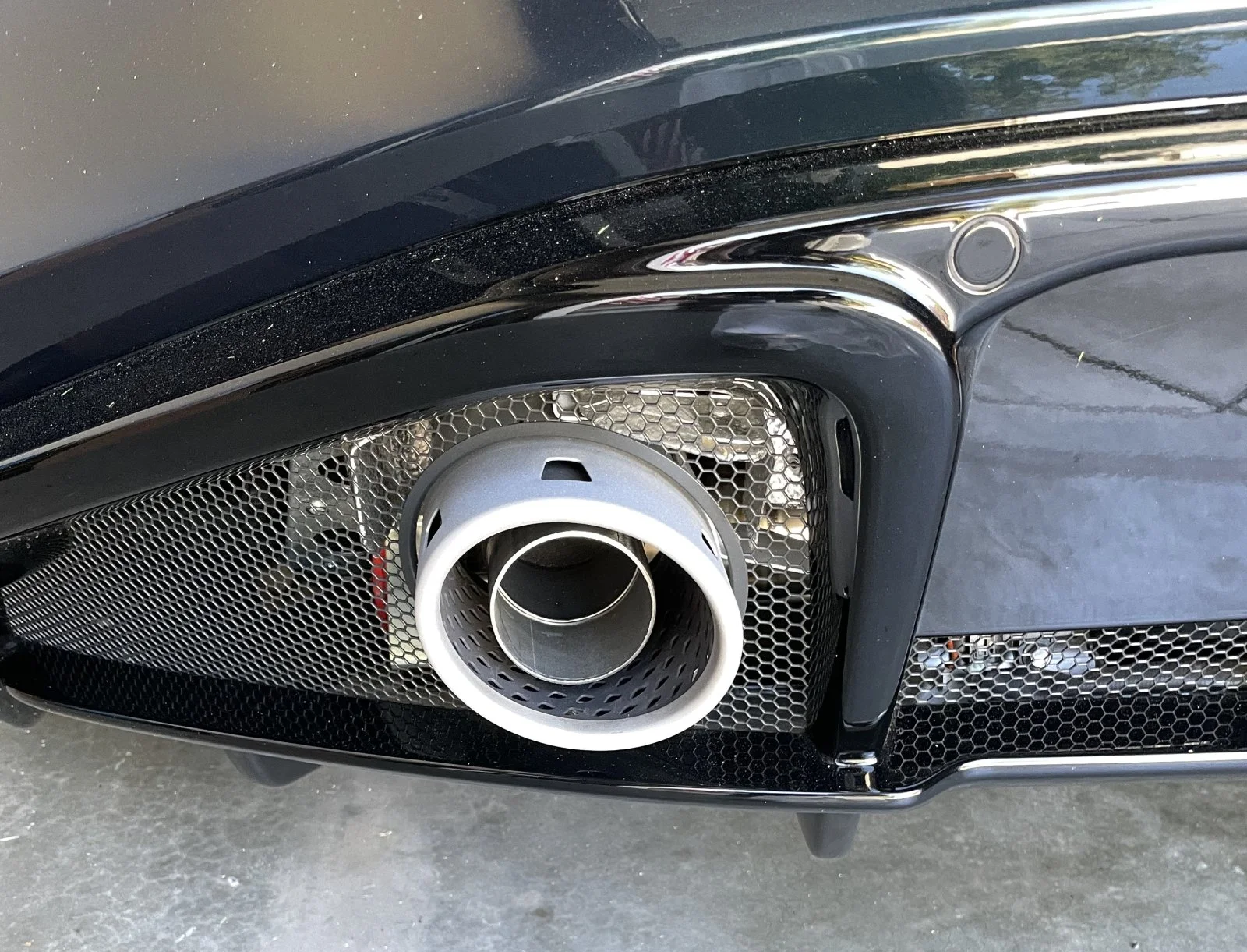

I went to a local auto parts store, and got a couple of these to put on the ends of the exhaust pipes.

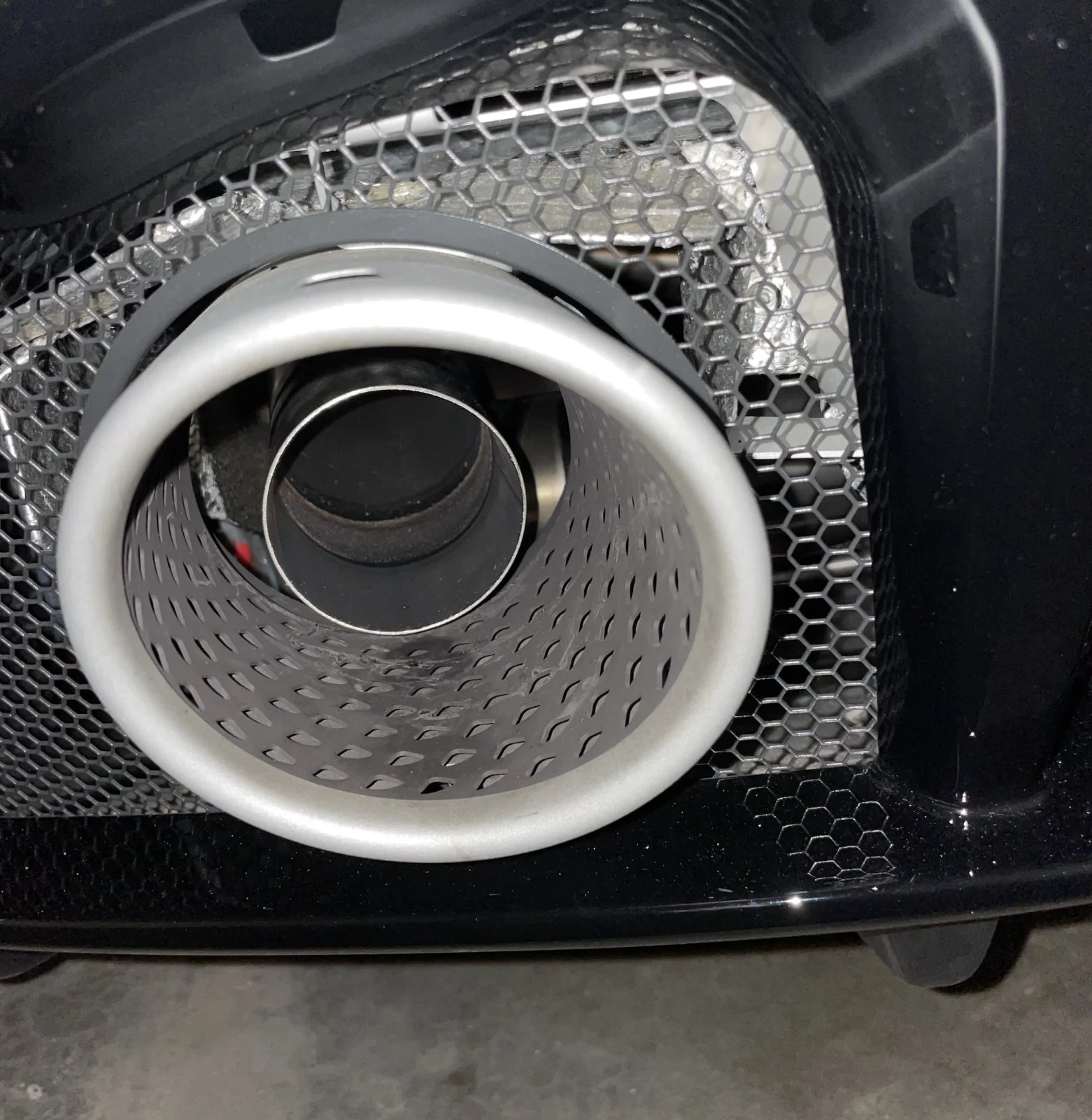

Here's how it looked before I put them on:
And here's the after picture.
Doesn't look too bad, and It works. It completely got rid of the boomy sound when starting the car and just letting it idle. It knocked out about 80% of the boom while out on the road. The only time I hear it is when the rpm is around 2k, and I press the gas pedal while in the same gear I was cruising in. If I downshift to get the rpm up above 2k, it's not too bad. This is in Tour mode too. Holding at a consistent speed it's much better than it was. It has a throaty, deep tone that kind of reminds me of a Borla.

This is really interesting. Are the Aerie exhaust tips longer than OEM ?
I didn't actually measure them, but visually they look just a slight bit shorter, like maybe a 1/4 inch. The factory exhaust was a bear to get out, and it was a struggle to get the exhaust pipes to clear the bolted in exhaust tips. I was shocked when the Aerie just slid right in without any clearance issues at all.
I should have been specific. I meant the length of the tips attached to the bumper.
Those are the factory tips. I didn't use the titanium ones from Aerie because I wanted the car to still look stock back there.

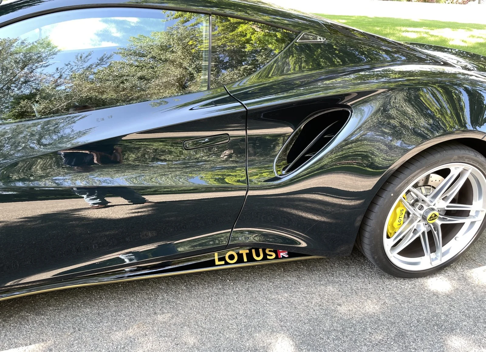

May I ask where you got the Lotus stickers with the half British flag from ? They look really nice and subtle!
And do they happen to match the yellow calipers/logo ?
Btw amazing work on the car and in the forum!
Thank you!
I designed and created the artwork myself, and had a vehicle graphics shop print them out for me. I wanted the lettering to appear more gold than the Lotus logo yellow, but that's an easy change if someone wanted the lettering to match the logo yellow.
Here's the file with the lettering in Lotus logo yellow. It's a pdf file so it will print at any size if you want it bigger or smaller. You'll have to take it to a vehicle graphics shop and get it printed out on the kind of vinyl that's for vehicles so it's durable.
Yes, I recall you saying that. Was just wondering if the Aerie tips are longer than the Lotus OEM tips to compensate for the shorter (?) pipes on the silencer. Anyways, you seem to have found a nice discreet workaround !
