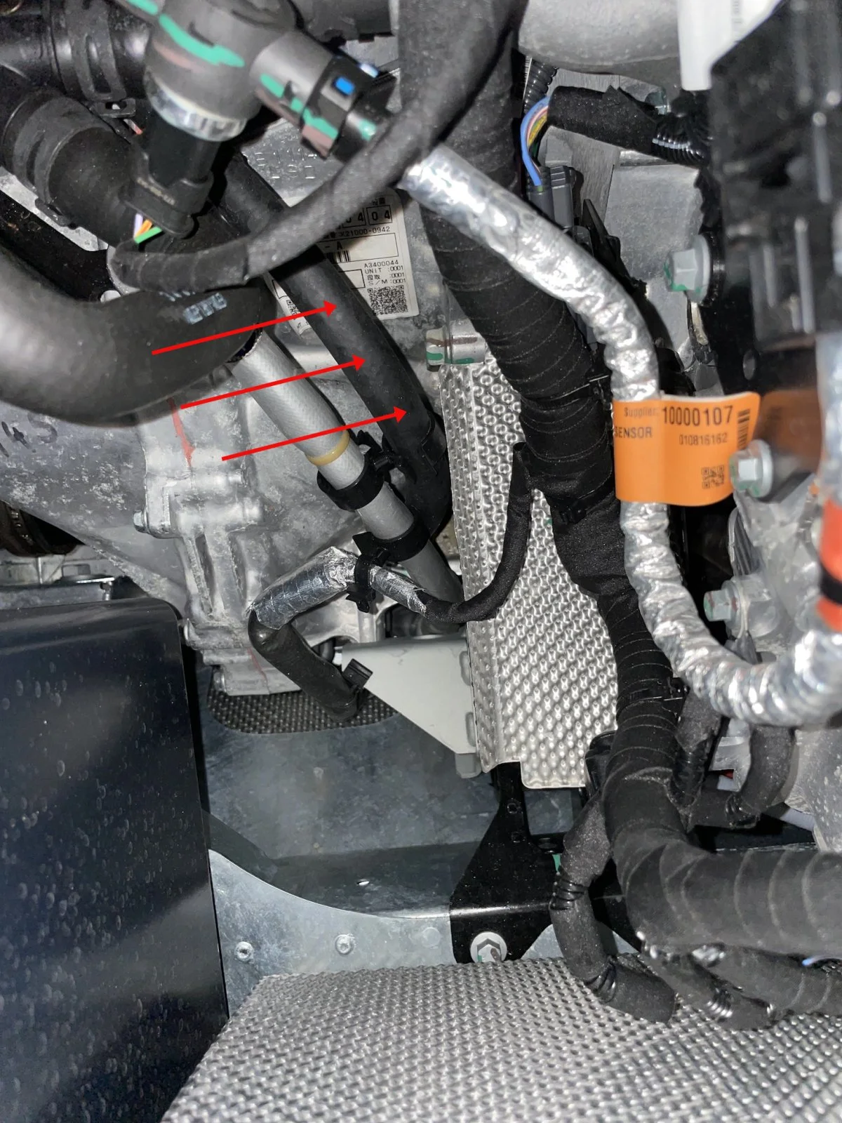

From what the tech told me, the drain plug on the bottom-side of the trans has a hose connected to it like an Evora (you'll need a crush washer for the drain plug), and the fill plug is in fact up on the top of the trans, not on the side. He said there's a black hose that also connects to the fill plug on top. I've looked at the top, and here's a picture of the hose that goes down to the fill plug. This is looking down on the left side of the engine. With the under pan off, you might be able to reach it from underneath. I'll check when I have the pan off.

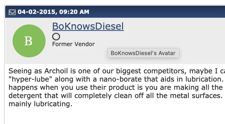

Here's something I found that's interesting, as it's a comment from a competitor to Archoil (the competitor is Hotshot). Here's a snapshot of the start of it:
Here's the full text:
"Seeing as Archoil is one of our biggest competitors, maybe I can shed some light on the product. Let me start by saying, it is a good product. When it comes to stiction, they skinned the cat in a different way than we did. I am pretty sure they are using a blend of several different ester oils which act as a "hyper-lube" along with a nano-borate that aids in lubrication. Due to the polarity of the esters, I guess that could have "some" cleaning properties (sort of like the esters in our Friction Reducer and Transmission Stiction Eliminator), how much they actually clean is up for debate. So the main thing that happens when you use their product is you are making all the metal surfaces slicker than they would normally be, which is why you get almost instant results. I cannot comment either way on the longevity of the effect. What we did with the Stiction Eliminator was put a very strong petroleum distillate detergent that will completely clean off all the metal surfaces. It also contains moly, so after it has been cleaned off, you get the benefit of the moly on the metal. In short though, while the Stiction Eliminator helps some with lubrication, it is mainly cleaning; and where Archoil does some cleaning, it is mainly lubricating."
The main thing I appreciated (besides the professional respect for a competitor's product) was his comment at the end, where he says Archoil's main feature is lubricating. By their own analysis Archoil's product is "...making all the metal surfaces slicker than they would normally be".

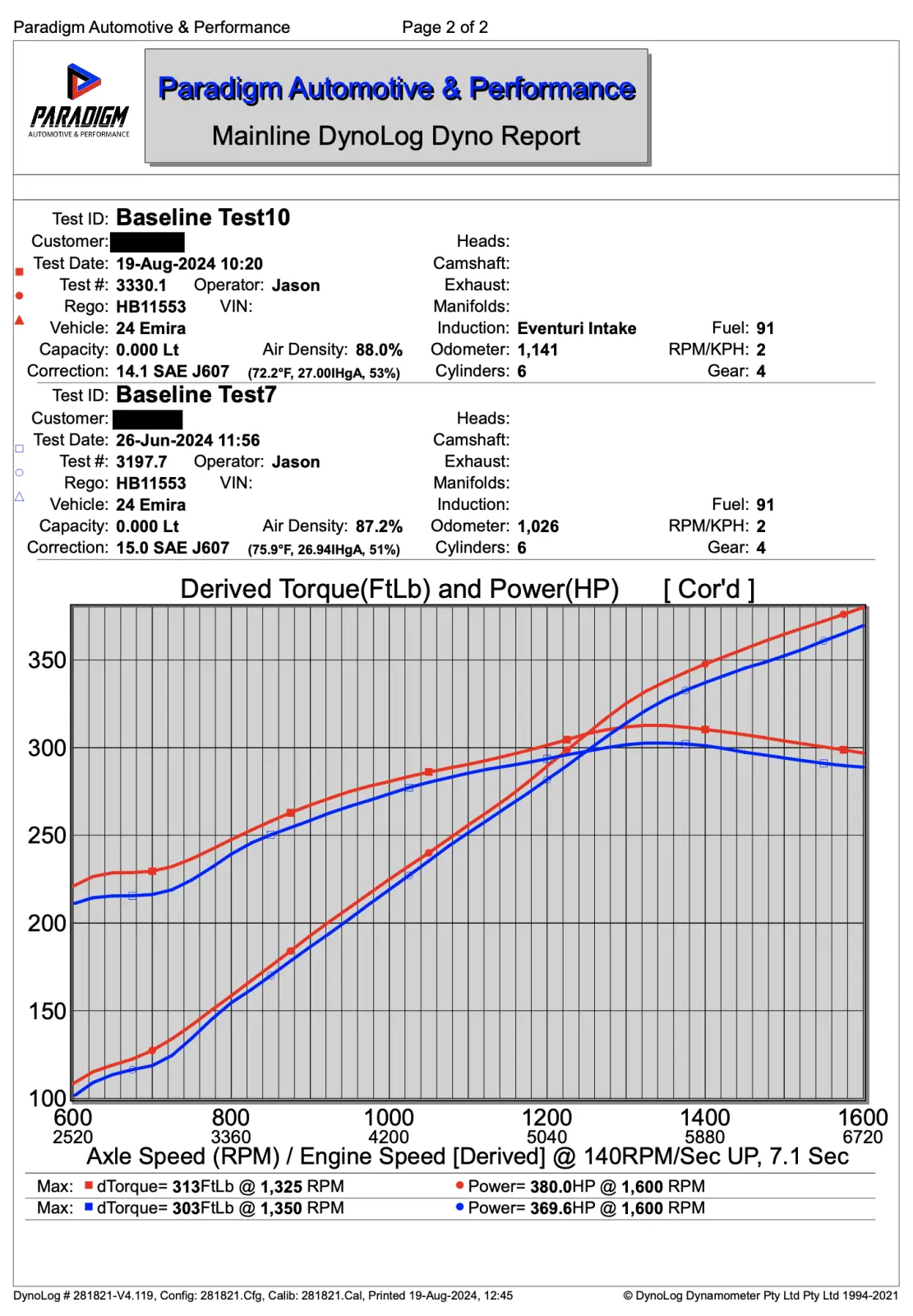

Okay, got the dyno run today. The only difference compared to the last dyno, is the Archoil 9100 in the engine and trans. There was no power gain, in fact a slight drop of 4 hp, but the operator said that's within the margin of error of the dyno, and today the humidity was 53% versus last run which was 42%, and that would have an effect on the results.

So now I'm going to fill the tank, zero the trip odometer and see what the around-town gas mileage is. I noticed today when starting the car, that it is quieter. There's virtually no engine or trans noise, other than the gear growl when you first start out, but that too seems a bit less. The tone of the exhaust comes through nicer now. The overall impression is everything feels and sounds smoother. The car feels slightly more responsive when I accelerate. It's not dramatic, but the way the car feels and sounds now just feels a little more polished overall.

As far as the Archoil 9100, it had a surprising effect on the gas mileage (this is just in the transaxle too). On the way back home, measuring the same way (actual miles driven divided by the number of gallons the car took at the first refuel stop), I got 25.8 mpg! So before the Archoil in the trans, doing 75 most of the way I got 23.8 mpg, and after the Archoil, doing 80, I got 25.8 mpg. 2 mpg better! If I had done 75, it would have been even better. Now it's going to be interesting to see what the results are around town.
Monday I have an appointment for another dyno run, so I'll have a chart that shows what effect the Archoil has on power and torque (if any). I can say that there's been a definite reduction in the mechanical noise from the engine and trans, and now a definite increase in gas mileage. I wish I had been able to do a before and after with doing both the engine and trans at the same time, but it's surprising that just the trans alone would make that much difference in the gas mileage.
Over the years I’ve done countless dyno runs and agree with the varying results due lo humidity. The other big factor is temperature which directly relates to the oxygen levels. I’ve personally removed a cat and was unable to make any gains at all on a hot Summers day which was very disappointing. I later gained 12hp more on a colder day which shows th difference it can make.You never know with the exact same conditions you may have been 4hp up.. Pity you couldn’t have done a run and then the oil to test in the same conditions.
I’ve built a few engines over the years and although I’m no scientist it is widely accepted that a build with more precise tolerances is a better build and that directly links to how they sounds. If it sounds rough it’s not going to last as long. Based on you saying it sounds quieter I’d say that is great and should add protection and a longer life.
I am taking a guess that this will be most beneficial for the gearbox which is probably subjected to a harder life than it would have in a different application due to the constant high revs .

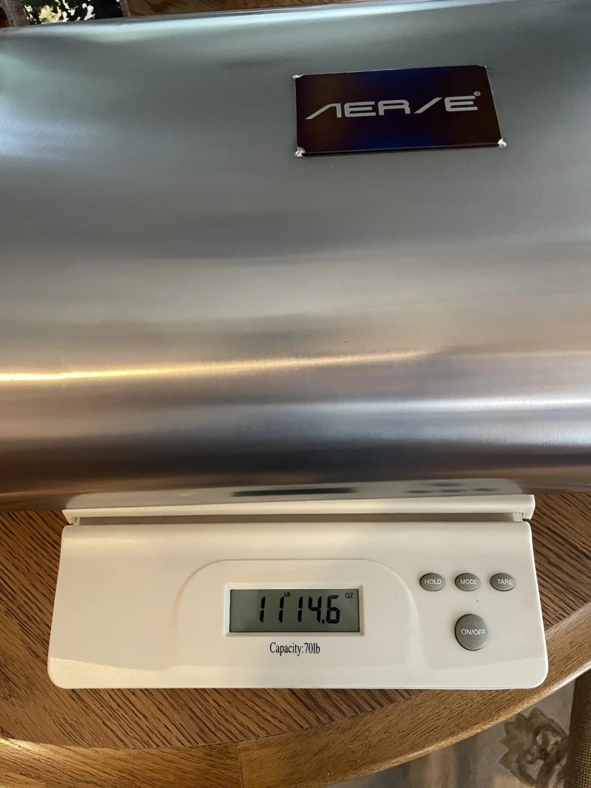

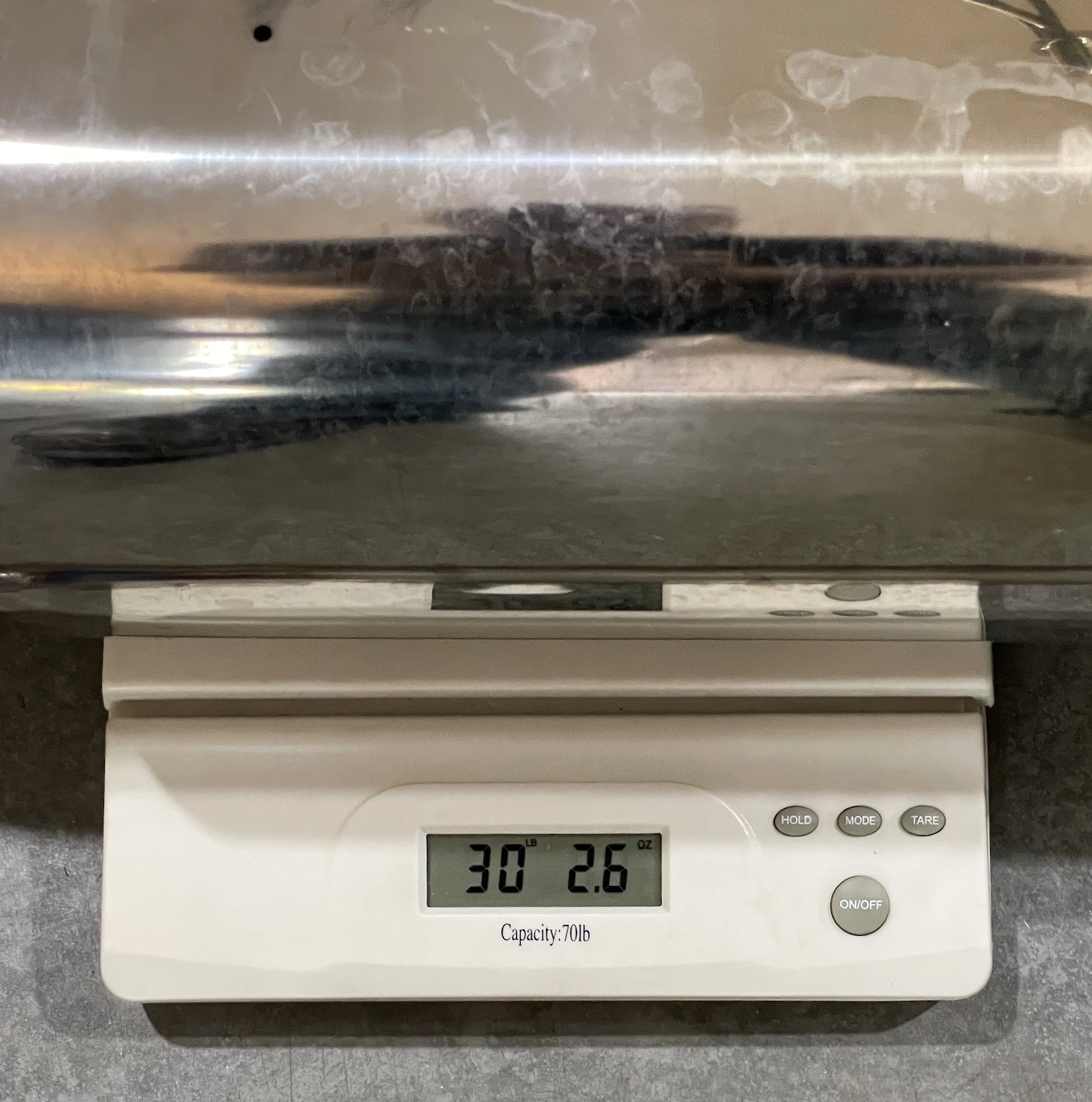

I weighed the factory muffler, and it's heavy. 30 lbs 2.6 oz.
The Aerie titanium muffler by comparison is only 11 lbs 14.6 oz, so you save 18 lbs 4 oz. with the Aerie unit. This brings my total weight savings to an estimated 72 lbs of weight removed from the car.

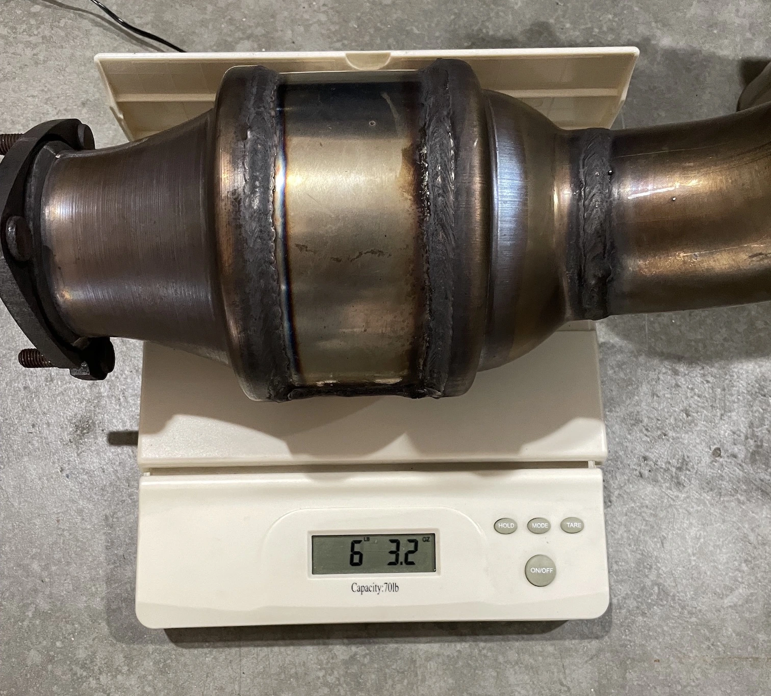

For those that have removed or are interested in removing the 3rd cat, it weighs 6 lbs 3.2 oz by itself.
