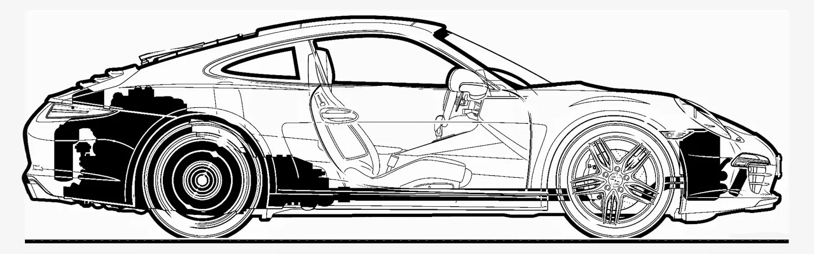

(rear engine sits on top of the rear axle). This is why it's tail happy (in general).

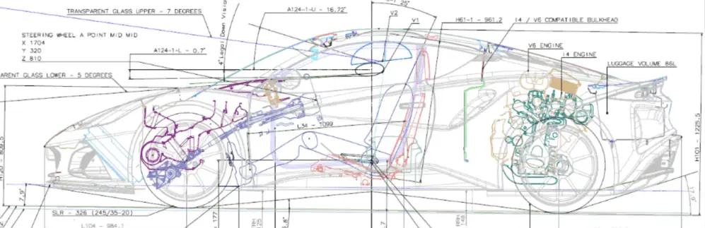

The engine is not on top of the rear axle, but behind it and only slightly higher than the hubs (as opposed to the Emira and other transverse mid engine cars where the engine does indeed seat on top of the rear axle). The tail-happiness of a 911 is mostly due to the high polar moment of inertia with the heavy part being in the rear (the same thing that promotes understeer in front engine cars - high polar moment of inertia with the heavy part in the front).
911 (991):
Emira:
Fun fact. The 911 and Emira have the same weight distribution (approx 60% rear, 40% front).
If you want something close to 50:50 the Cayman is near perfect.
The difference from the 911 is that the Emira puts that weight ahead of the rear axle.
I was paraphrasing for purposes of simplicity. However, I like that you attached the diagram which further reaffirms my point. the engine is further away from the center and to your point behind the axle making it exceptionally easy to getting the tail to slip. My whole point is getting more weight towards the center is better. The emira compared to my old Carrera T accomplishes this better than the T.
When cars turn, they do not rotate about the center of the car. They rotate about a point on the line you get from projecting the rear axle out some distance, so the effect of weight on polar moment is a little more complicated than people are discussing. Also, oversteer/understeer is really a discussion of the amount of grip the tires get, which is only partially influenced by static weight distribution, as you rarely corner under a completely neutral throttle. Braking or accelerating shifts weight on or off the wheels. You need to drive a 911 slower into a corner, and apply more acceleration coming out of the corner. Coming into a corner under breaking will lead to oversteer.

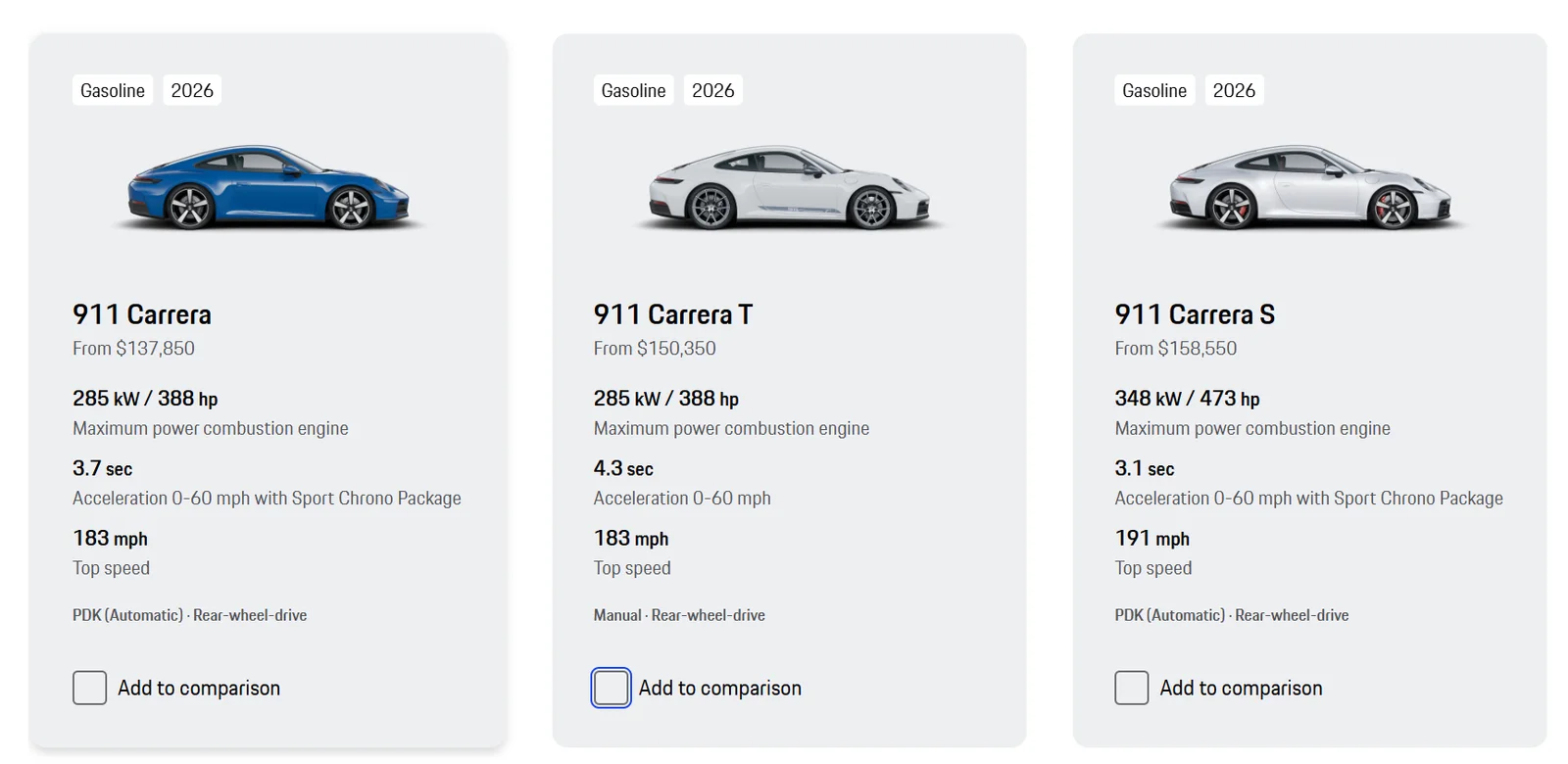

I thought about getting a 911 T instead of Emira before, but nowadays Porsche is going for crazy high prices, which I don't think is really worth it. 130k for a base Carrera and 140k for a T without any options? No thank you.
2026 prices have gone even more nuts: a base Carrera starts at 138k and a 911T starts at 150k now. :eek:

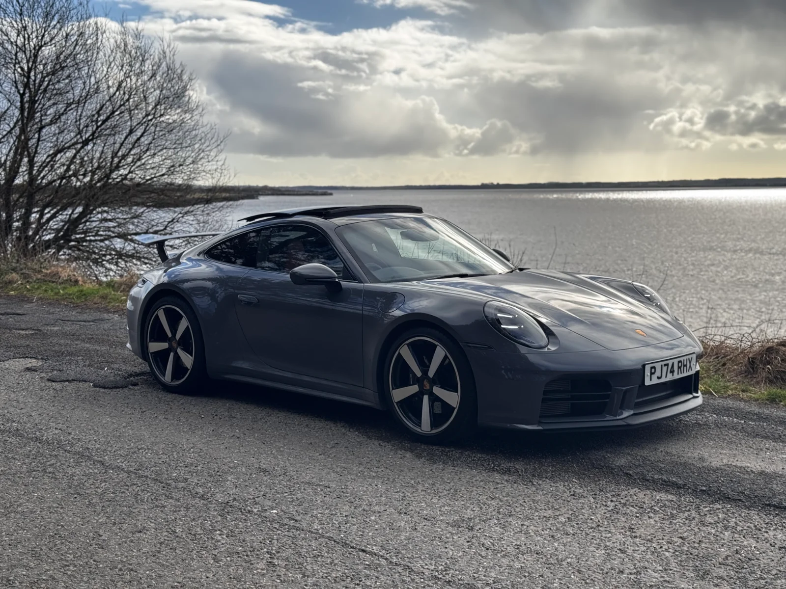

Haven’t been in the 992.2 Carrera for a while so the chance to drive it today with fine weather was nice as it also allowed me to refresh my memory as to how this and the Emira differ.
Again as I remembered the Carrera’s low speed ride quality is better than my Emira SE Turbo despite it being equipped with the Touring suspension, but as the speed builds so does the preference switch and its the Emira that glides over the bumps that unsettle the 911 and not only that but you feel them more in the Porsche, it’s subtle but the difference is there. Next is the steering and again low speed over poor surfaces the Emira steering continues to fight your grip where as the Porsche is way more settled yet despite each car sharing similar weight distributions the feel you get through the Lotus is remarkable compared to the Porsche, one feels like a well honed sports car whilst the other feels like a race car for the road by comparison, probably why I prefer driving Lotus when I don’t have anywhere in particular to go and just go out for a drive instead.
I love my Emira SE Turbo but compared to the Carrera it’s sound especially inside is just too ordinary, yes there’s lots of mechanical noises but the overall sound isn’t as thrilling as it should be in a sports car this exciting to drive, in a way I wished they could have enhanced the noise to sound a little more exotic through the speakers but maybe that’s not the Lotus way. From the outside it’s great, just wished the inside matched but hey that’s just me.
Lotus have came a very long way from previous models especially with their interiors and I hope this trend continues to the point that they match that of Porsche, IMO their Eletre has already done this so the Emira replacement should be a worthy rival to the 911 when it comes.
