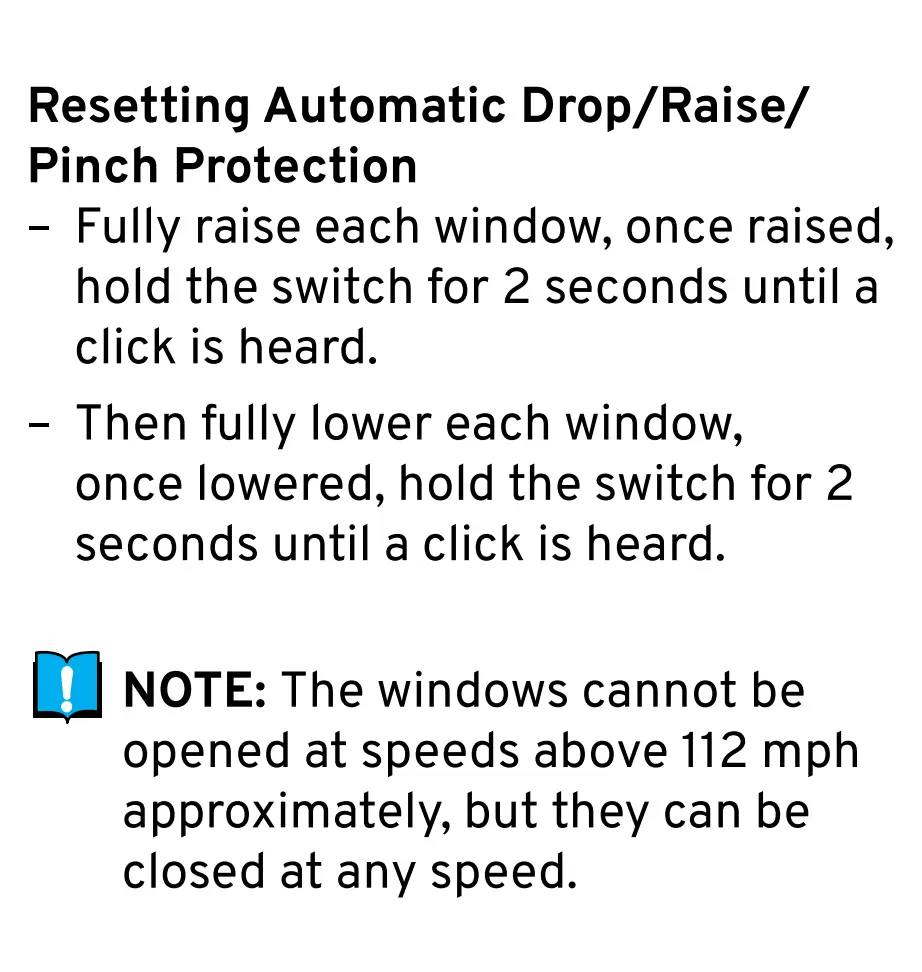

That would be my guess as well. I'd try the re-learning process (typically closing the window all the way and keeping the window switch in the up position for 5-10 more seconds, or sometimes releasing the switch after the window closed all the way and then pressing up again for 5-10 seconds).

I had a issue with it not locating at the top and they needed resetting.
I'm not 100% on the procedure but it's something like you hold the down button on for ten seconds. I think that re sets the low point.
According to the dealership, there is no re-learning process, so it has to go to them :(
It's in the handbook, worth trying first.
