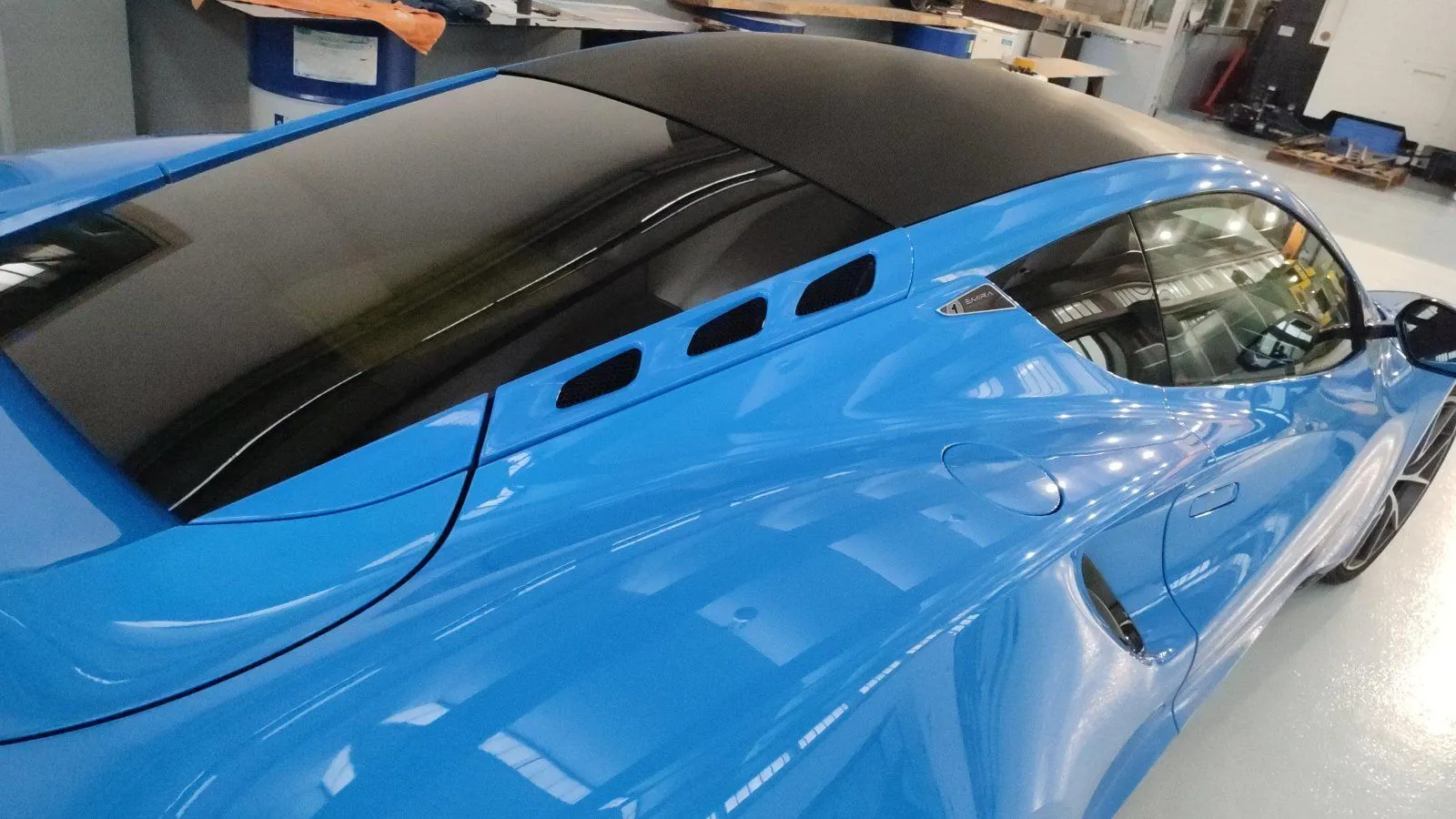

I was thinking -- it might be kind of fun to have a different colored engine cover
Something like the image below.
Will something like this eventually be available for the emira?

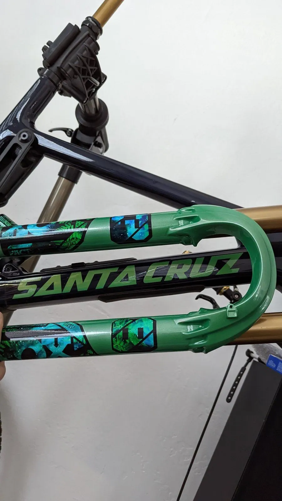

It’s not too hard to remove and powder coat
But what color? Body color? Something iconic?
I did a mountain bike fork and that was great. Matched the downtube decal

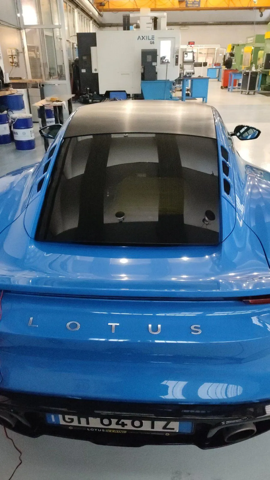

The company that did my ppf asked if I was thinking of painting the cover and said they can do any colour in heat proof paint. Sadly my came with the tinted glass so not sure it’s worth it or not? Also I have yellow callipers and stitching and I’m torn to whether it would look good or not.
I think it will look great in yellow if you have the whole calipers/stitching yellow. It might be the best way to see the engine better through the privacy window.
If you are going to do it, I recommend you double check about the warranty with your dealer.
If you decide to do it outside Lotus, you might void the warranty. Once you pull out the supercharger cover to do the powder coating, you will have to replace the gasket/seal.
