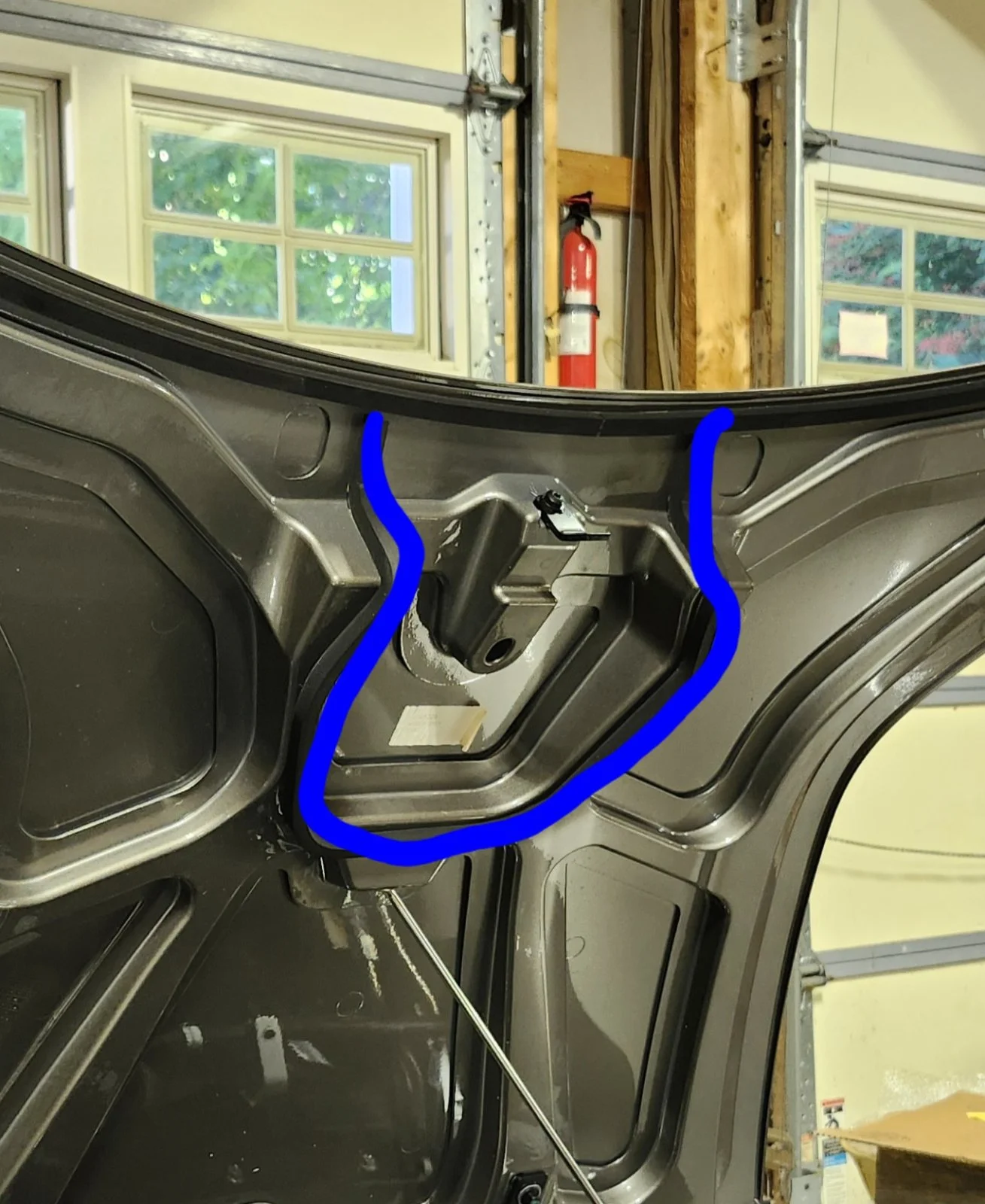

For anyone who hasn't 'popped the hood' yet, allow my bad digital crayon work to show the issue regarding warm vent air even on cool days. Red arrows show the air flow at radiator-exit temp. Blue arrows show the theoretical "fresh air" inlet for the HVAC. Are there speeds at which the HVAC might be able to draw cool air that is untainted by the hot stuff? Maybe. There is a seal on the hood that attempts to create somewhat of a barrier around the HVAC inlet (second pic). But it might be as effective as a small no-smoking section in a restaurant. (or better yet, a no-peeing section in a swimming pool).
It is very noticeable at 25-40 mph…Drive with your hand just outside the window and you will find cool air above the midpoint of the window opening and hot air at the bottom of the window opening. Huge temperature difference.
