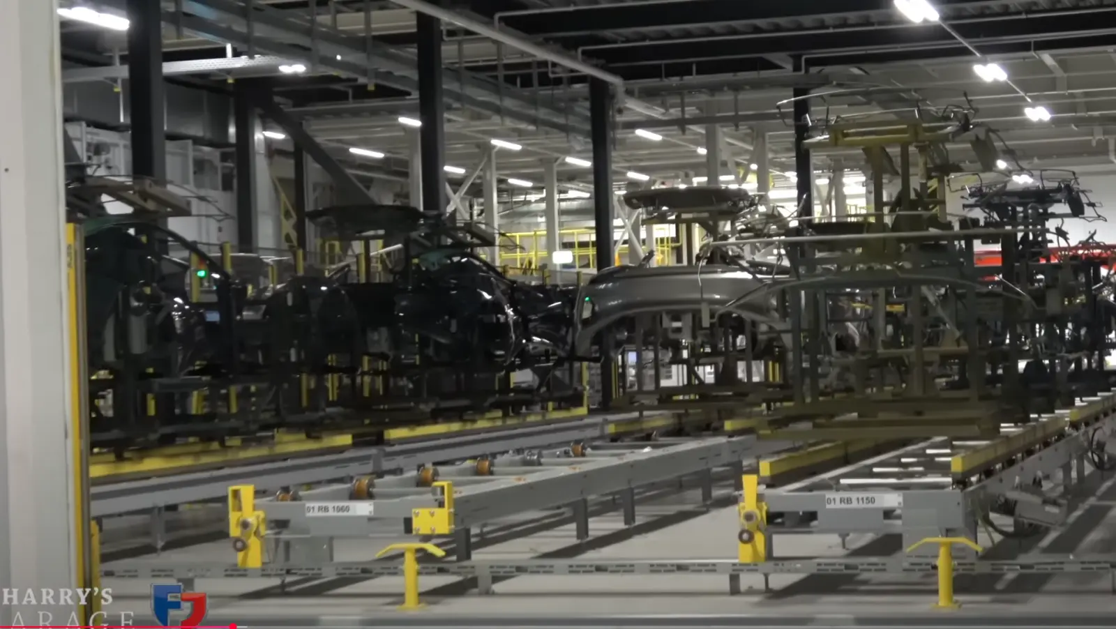

Image from the Harry's Garage factory tour video, showing the factory panels on frame jigs coming out of the paint process. These are all painted by robot and get absolutely consistent paint coverage, then are individually inspected and approved for forwarding onto the production line for fitment. The idea of a whole surface of a panel coming out without paint is not believable.
There are multiple steps in the process where this would have been caught, including the assembly/mounting process on the main production line itself. They would have rejected the part when they took it off the rack to fit to the vehicle.

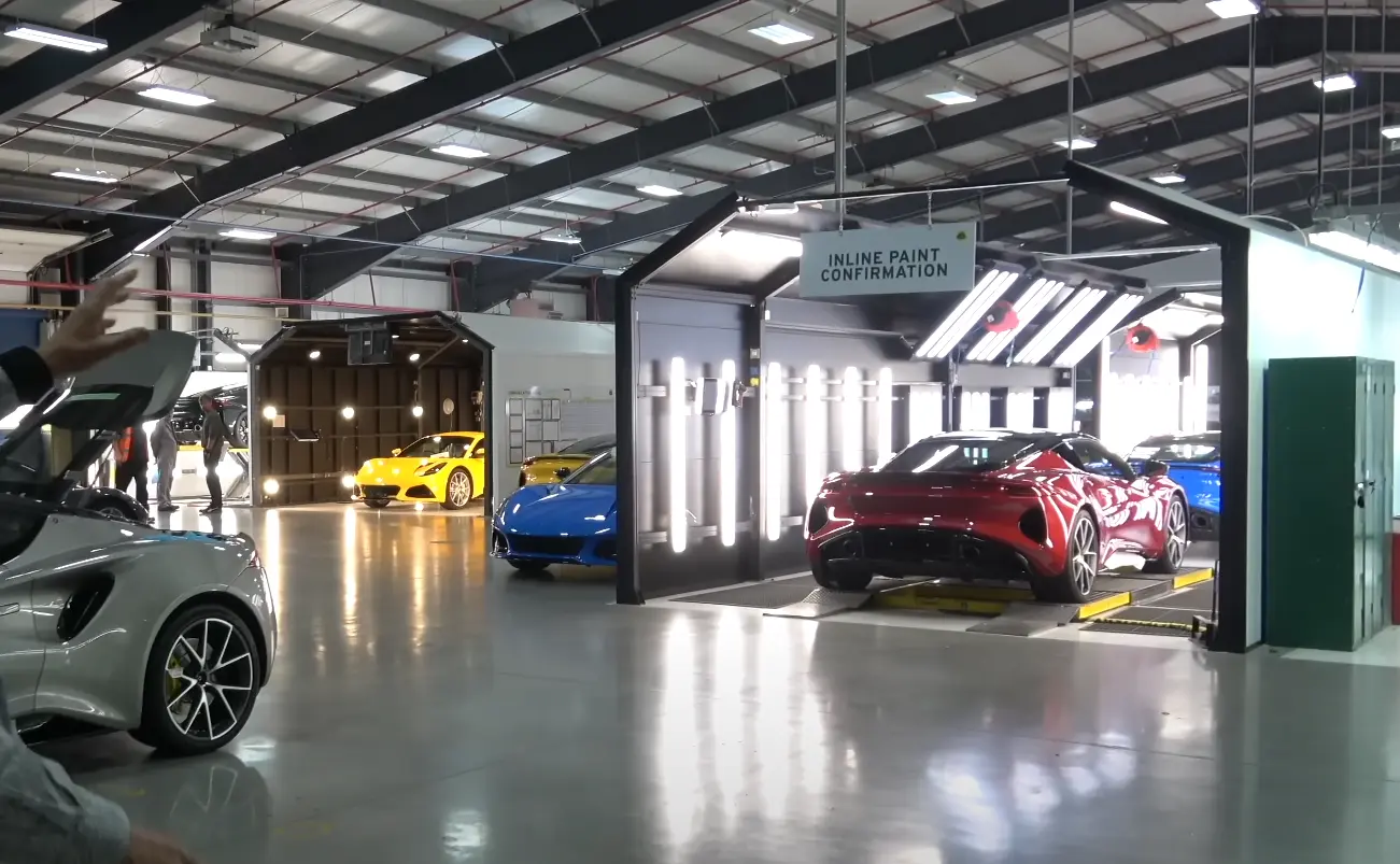

Here's the final paint confirmation and inspection bays, they look over every surface of the cars again before approving them. A bumper coming out partially unpainted is, again, not believable.
