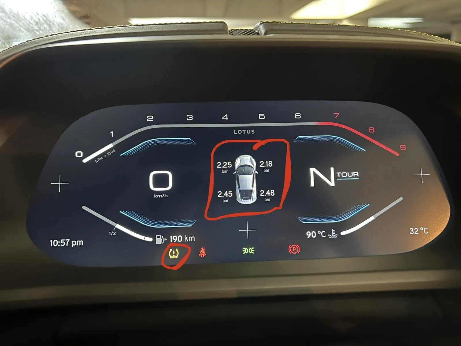

Wondering if anyone has had the same issue. I haven’t had much time to drive my car since delivery (have put just over 200kms on so far), but the TPMS light went on the last time I drove. Now it flashes every time I start the car and remains on. I did see the readings fluctuate whilst driving but my tire pressures remain well above the recommended settings and also the center console readout says tire pressure is good. I checked all my tires and there is no puncture or leakage.
I checked out the owners manual and there is no hard reset function, but that the TPMS is supposed to reset itself after some more driving, though it hasn’t seem to have gone away after about 20kms.
Anyone had a similar issue or fix?

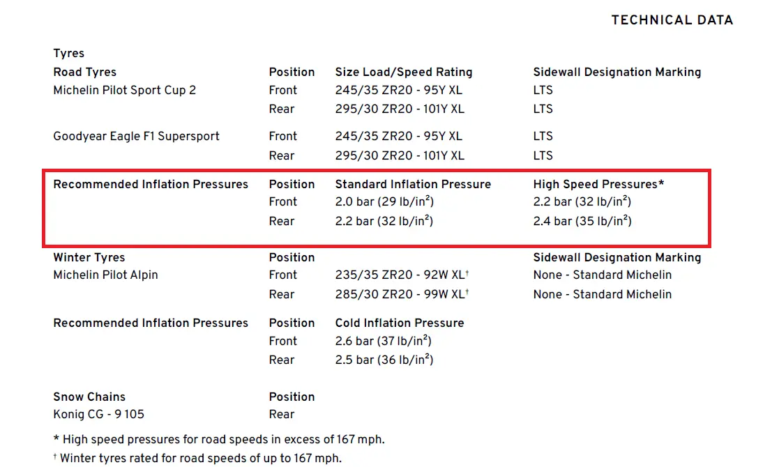

Will try, but the rears and front should be different. The rears should be around 0.2bar higher than the fronts.

In my experience. I set front at 1.95 bar and rear at 2.15 bar when tires are cold, using petrol station measuring machine. Had to go through 3 different machines and all of them showing different readings and the car showing a different one too. After one minute driving those readings show 1.98 and 2.18 front and rear in the car sensor.
After tires warm up, the reading is similar to the OP, 2.15-2.2 front and 2.45-2.5 in rear, and doesn't trigger any alarm.
Using Goodyears
I did find that for some reason the sensors read 0.5 higher than in the Evora, where I used Cup2´s and lately PS4S

I have no confirmed it to be faulty, but it's the some one (Front-right) one that initially triggered the first warning light.
I've tried adjusting tyre pressures. Nothing will make it go away.
Unless you have to drive 100 kms to make it go away, but I've driven w/ the light for 50-60kms and it still sticks around. It flashes when you start the car like it's trying to calibrate and then just stays permanently on thereafter.
The central console will also indicate it as "Tyre pressures OK" and have a green dot. So I'm not sure what's causing it to remain on permanently.
Attached a pic of the FR sensor failing initially before returning to normal after restarting the car.
