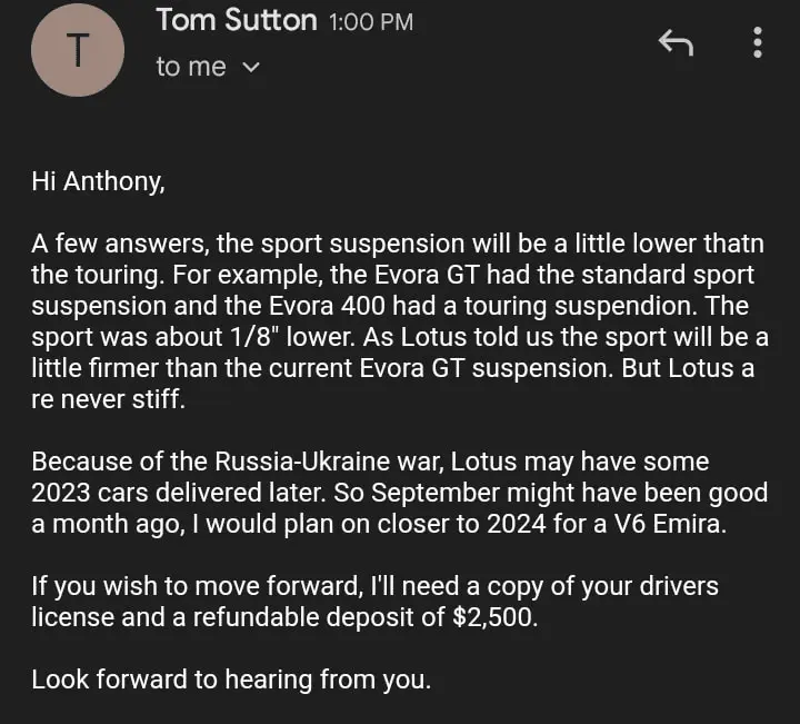

An email posted in another group in case you haven't already seen it:
Respectfully, I don't know if a comparison to Porsche suspensions are fully relevant, since Porsche fits remarkably stiff suspension to their S models and then actually gets significantly (experientially) softer as the tiers increase to GTS, Turbo, etc. With the better dampers in their top models the ride is actually more compliant, adds effective traction, etc. They are odd in how they handle it.
Also, this Tom Sutton gentleman from whichever dealer this is says the Tour and Sport will be at different ride heights, which has been very specifically contradicted by Lotus themselves (including Gavan Kershaw), so I'm not sure whether to trust the rest of his narrative either.
