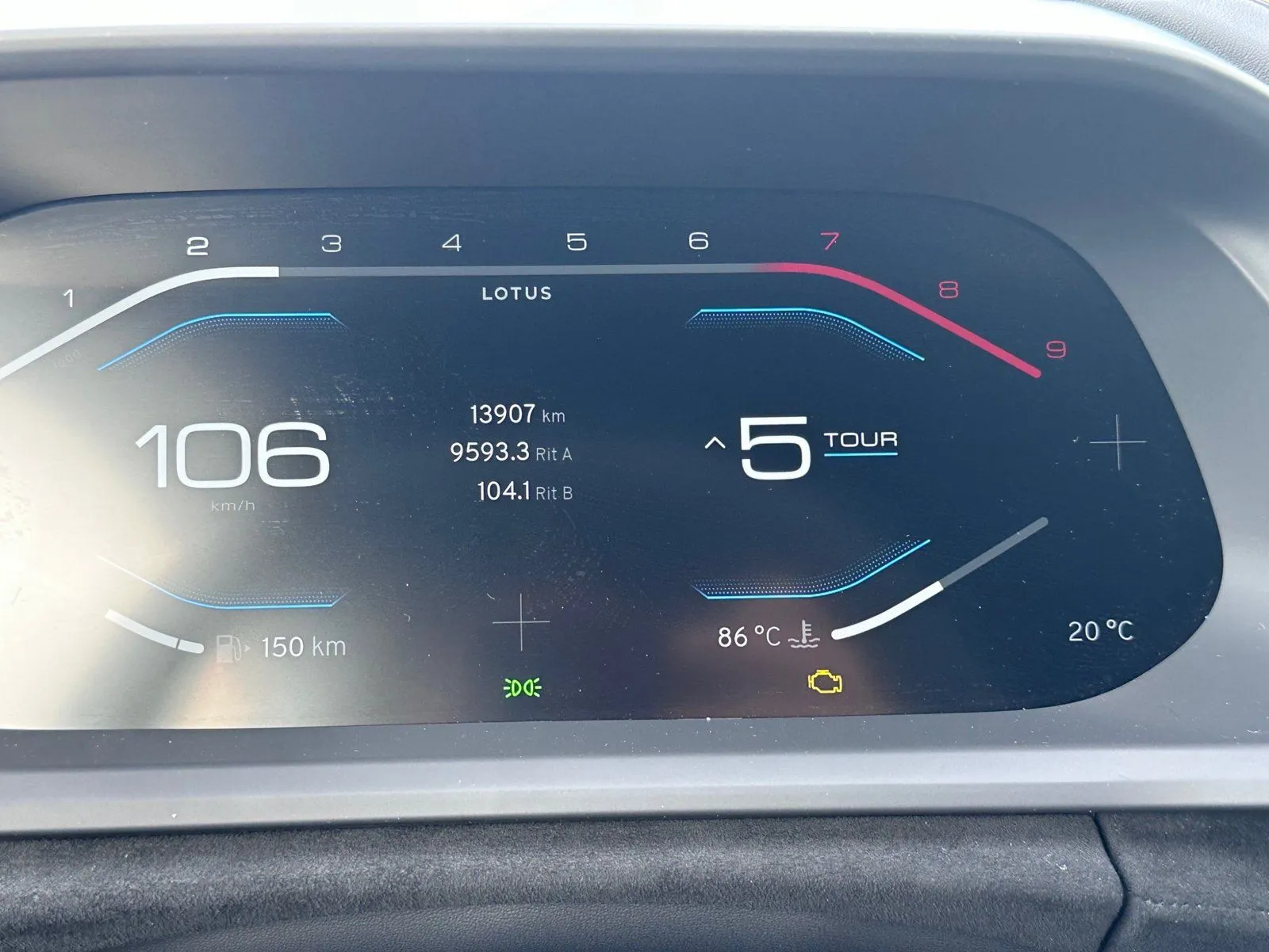

My car has now driven 14,000 km and has already had several updates. A final update last week. But even before this update and now the last one last week, the engine fault light keeps coming on. Last time my garage told me that this was not a problem and that this would be addressed in the next update. But after the last update last week it went away for a while, after about 100 km it suddenly came back and stayed. The car drives perfectly and does not indicate that anything is wrong. After a phone call to the garage, they went to Lotus to listen to how this could happen because they were apparently aware of it. In any case, this has to go because it always seems like there is something wrong with the car. Anyone else having this problem?

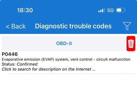

Hi, I ordered this and received it yesterday and was able to use it, works perfectly. I was able to remove the error message, the engine light is now off. It appears to be a problem with the ventilation or shutting off of any gasoline vapors. For now, the warning won't come back, so let's hope. So thanks again for the tip, it works perfectly for me! I can now take this information to my garage and see what their answer will be, whether anything needs to be done in terms of maintenance.

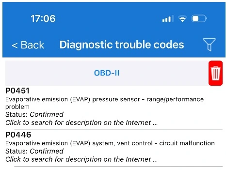

Wasn't there an issue with the charcoal canister needing to be replaced on some models, or something like that?
Ok warning light is already back. Victory declared too early. Did a reset again, same error message. We'll see what Lotus will do with this.

Decently common part failure on the Emira -- EVAP purge valve is faulty and will need to be replaced.

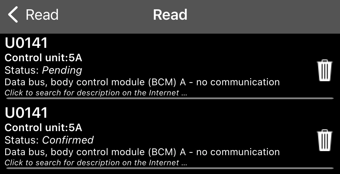

I’ve got a sub 20 day old Emira and the amber malfunction light has come on and remained on for a few days now.
Used Veepeak and CarScanner to get the error code DTC U0141 - Lost communication with Body Control
Searched the forum but no hits, does anybody know if it’s safe to drive? Safe to clear?

Yes, I had this issue. They ordered the part 3 months ago, still not in and reset the light. Has not come back yet so I don't worry about it. Get an OBD reader and reset your light and see what happens. Also, read what the diagnosis is and then post that. Good luck.

I would reset it and see if it comes on again. I would drive it and see it if reappears. When I first got my car it had a "invalid data from vehicle dynamics control module". The guy at Autozone used to be a Lotus tech, imagine that. He said it's probably a glitch. He reset it (before I had an OBD reader) and four months later it never has come back.

General rule of an OBD reader - reset it - if it comes back, it's a problem - if it stays away, it was a glitch.
