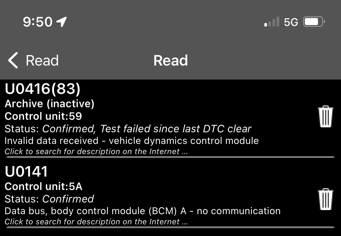

I turned the car on this weekend and the engine check light has gone away! Drove a fair distance into London & back, no issues. Hooray?!
But running another scan once home, it seems I now have 2 error codes logged… (same as before plus a new one)
Should I be more concerned that it’s got 2 errors now? Or chilled as the dashboard light is not on anymore?
Using the same app just clear them and see if they come back after a while. These communication errors are somewhat known on the Emira.. Most of the time they just don't come back so nothing to worry about. If they are persistent I'd let the dealer check it, but don't get your hopes up lol
