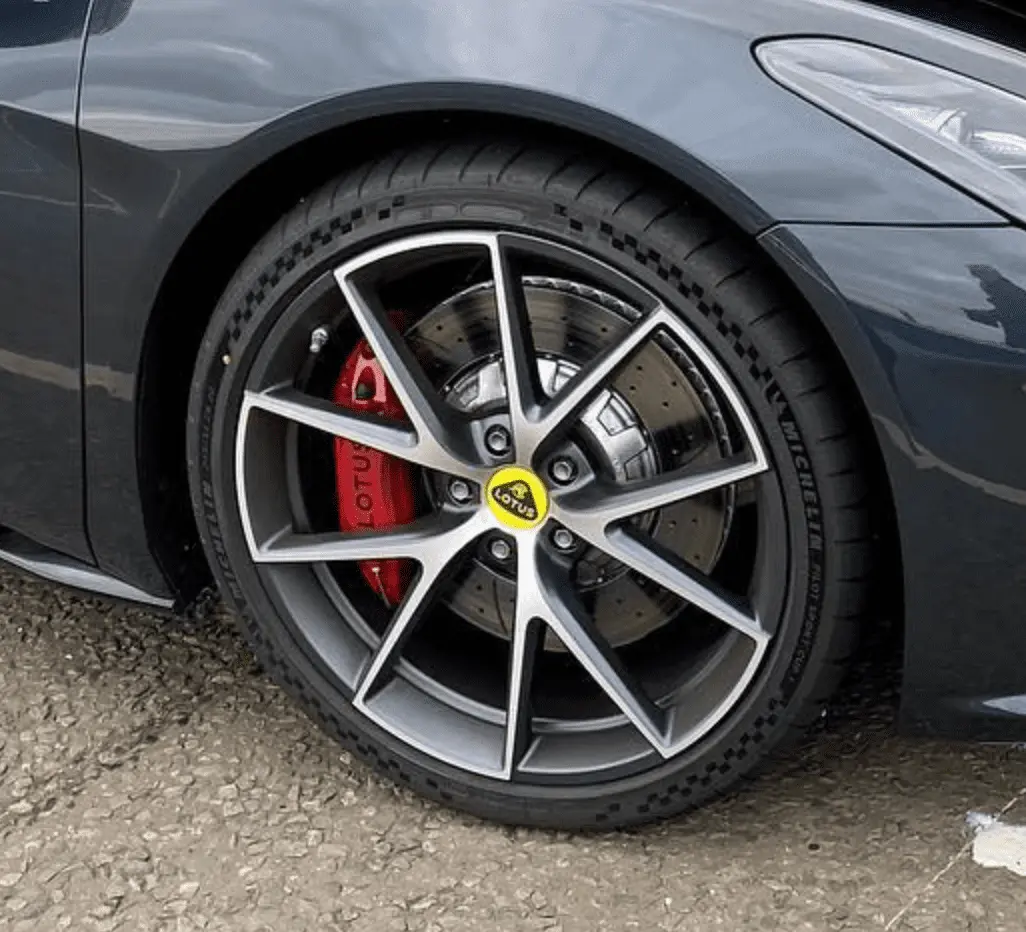

Do you think you're going to be able to fit an 18" wheel on the Emira? I'm pretty sure a 19 will fit, but there's not much room behind that brake caliper. Even for a 19 it's either a custom forged, or something with spokes that have good clearance on the inside.
The higher offset of Lotus setups might make it harder for spoke clearance to caliper, but that all comes down to spoke design and spacers as needed. As for the barrel clearance, that shouldn't be an issue at all. I run 380mm rotors and 6/4 pot Stoptech calipers that are fairly massive under 18" wheels with plenty of clearance.
