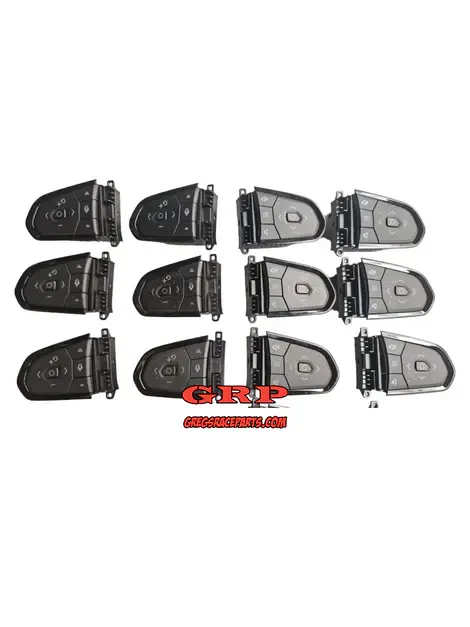

A lot of you were annoyed with the touch sensitive type buttons on the steering wheels from the factory and for good reason, those things are too sensitive!
We now have the press type buttons available to order on our site. (Ready to ship out around Aug. 5th)
These are brand new buttons that are totally plug and play.
Takes about 30 minutes to swap them out. You can use our custom steering wheel installation write up as a guide on how to access the screws to swap them out.
See our site for some more details and feel free to reach out with any questions!
Press Button Sets from GRP
