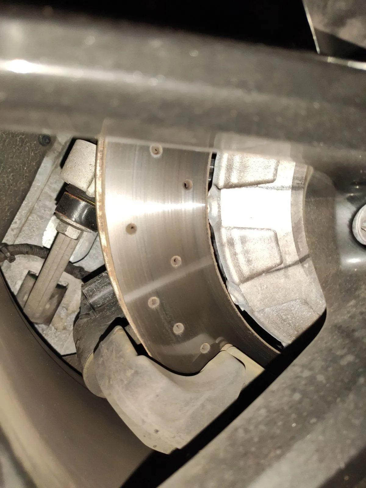

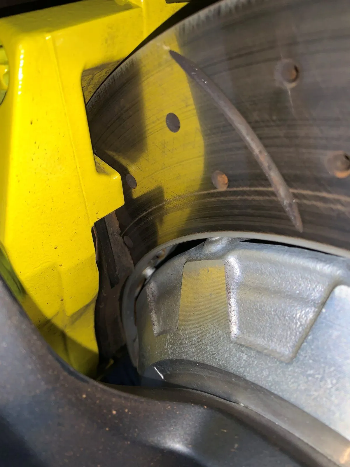

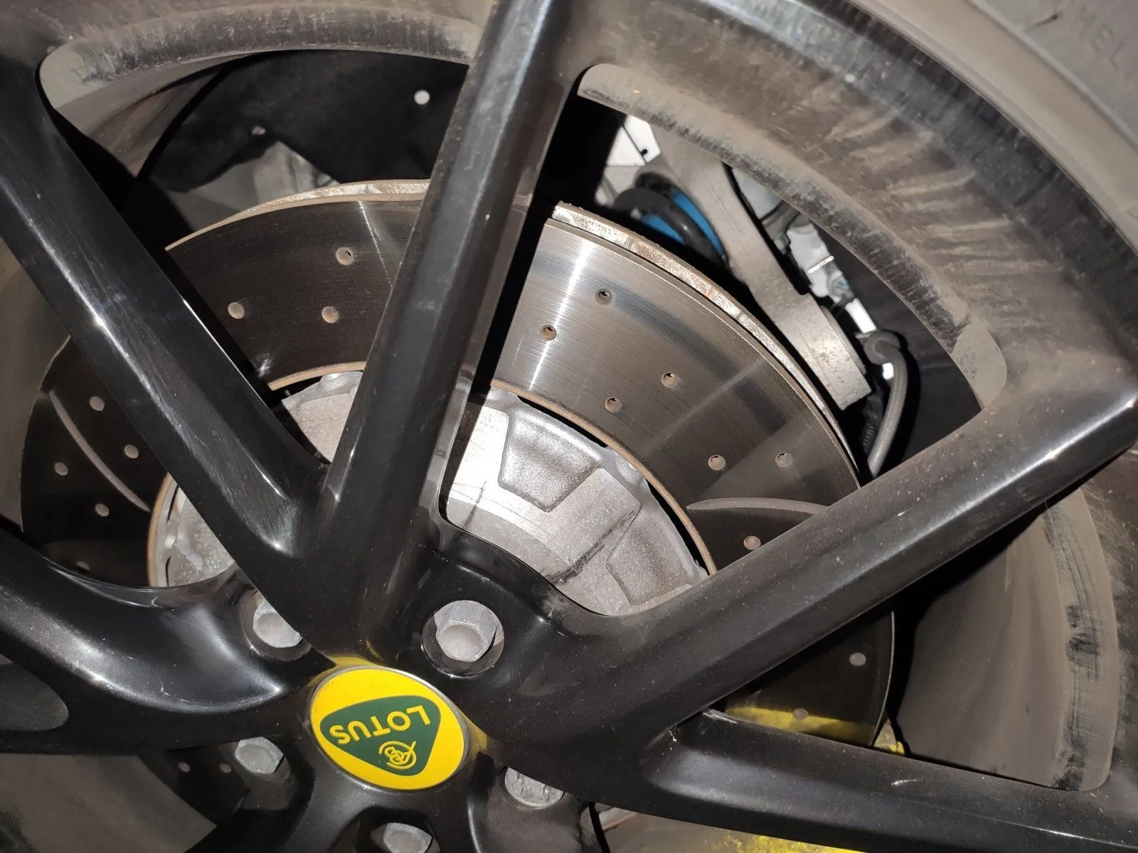

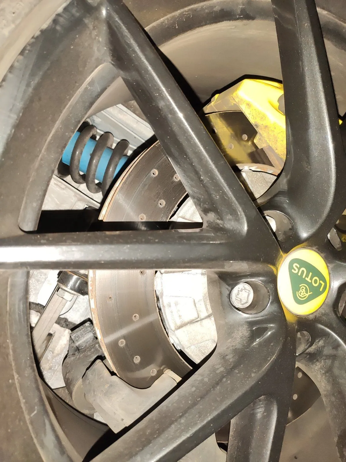

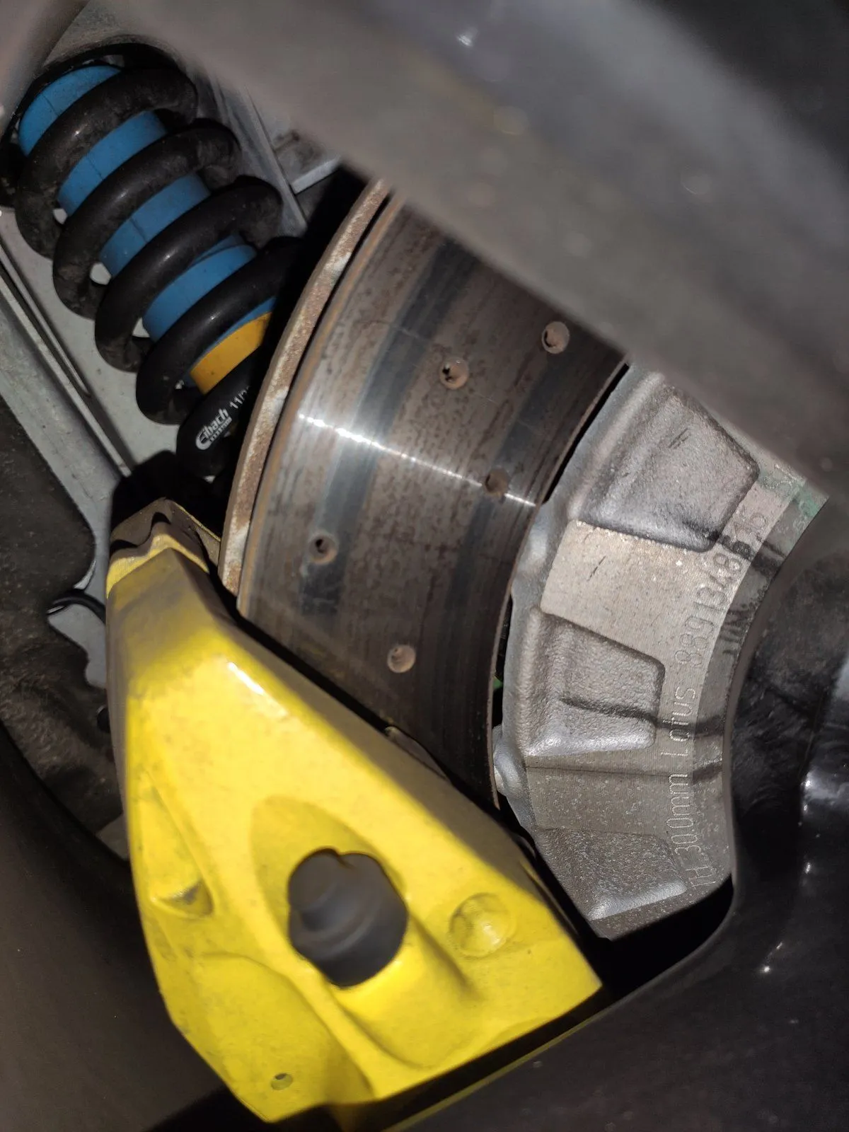

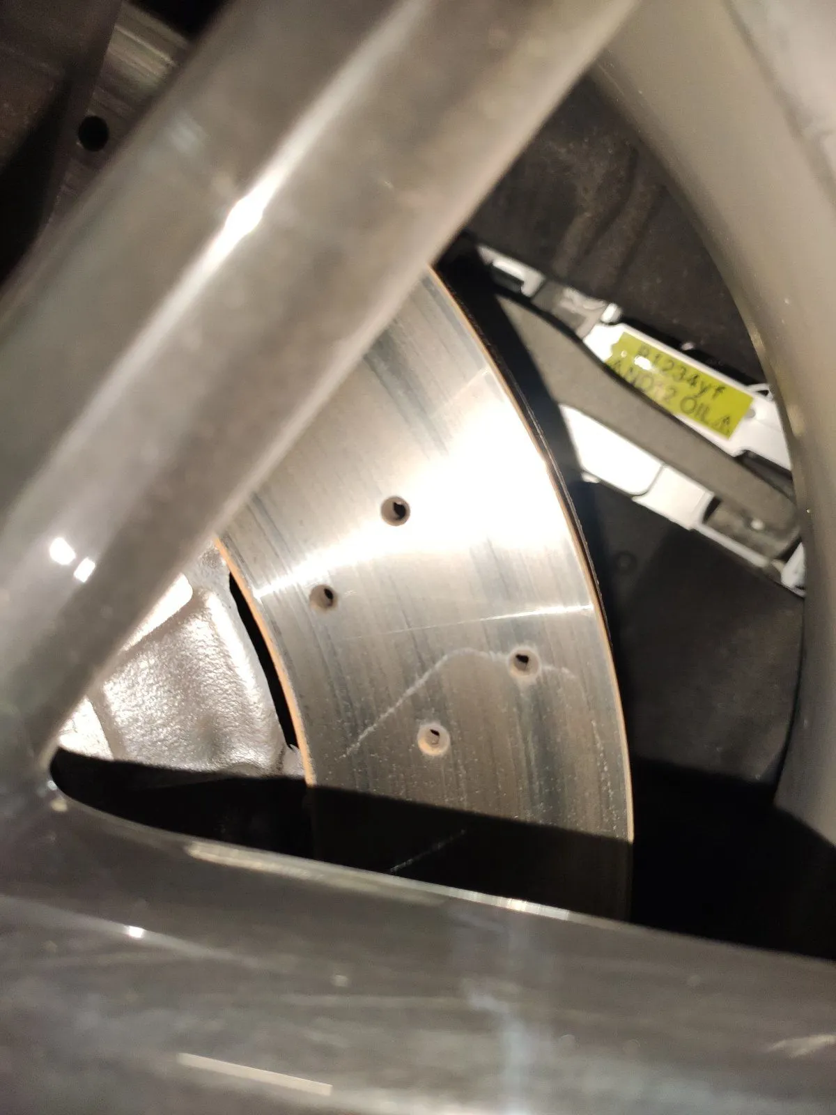

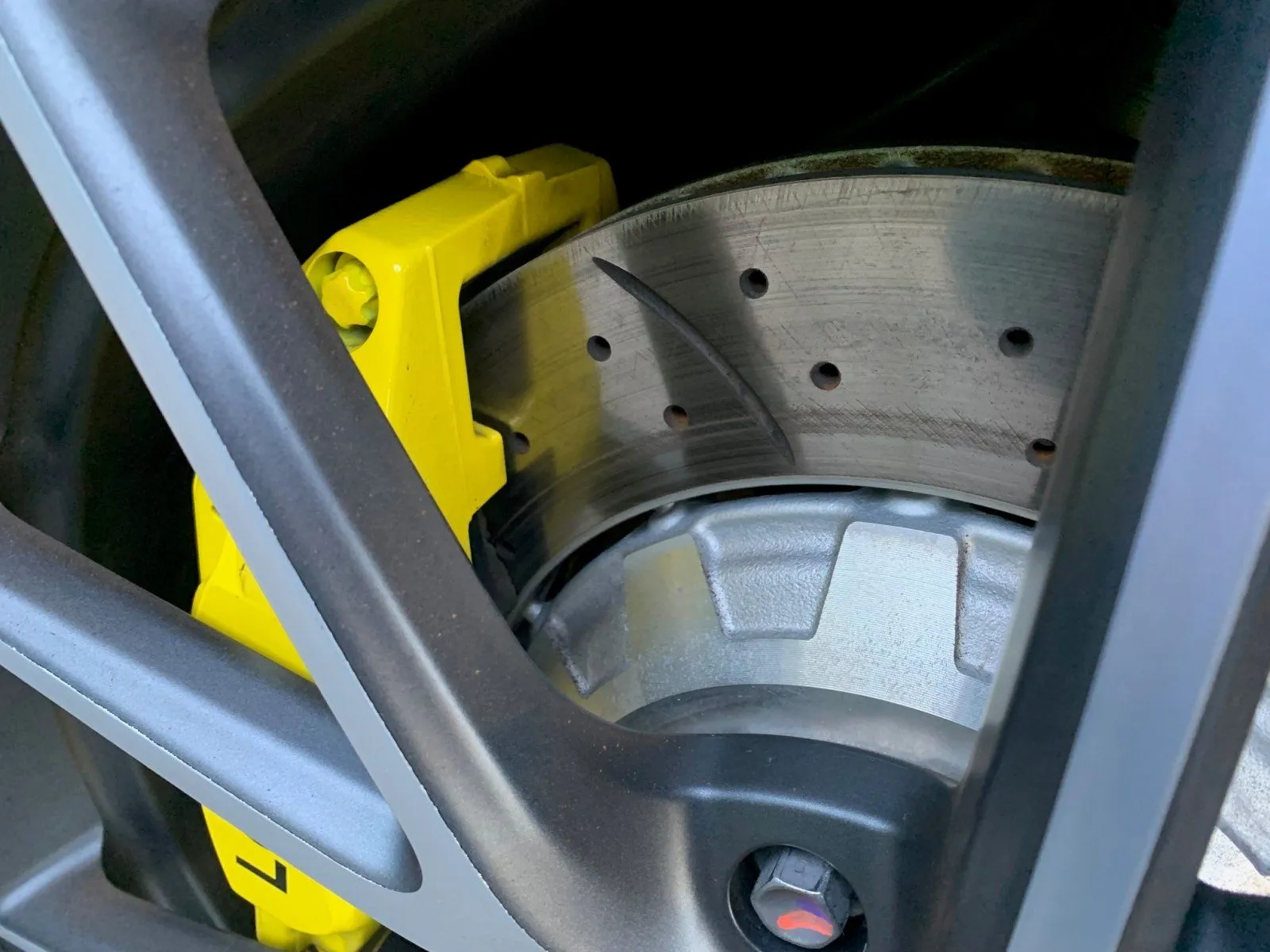

Here are some pictures. Not sure what to think about them. As a novice I'd guess rear left doesn't look quite right..
Rear left:
Rear right:
Front right:
Front left (Weird line?)
Rear left:
Rear right:
View attachment 23314View attachment 23315
Front right:
View attachment 23316View attachment 23317
I would suggest getting these checked out at the Dealer. There looks to be the outline of a pad (dogleg shape) on one disc indicating the pad has been seized on at some point. That is probably the source of some vibration and could generate squeal. One possible explanation for the wierd line could be where the machining operation has failed to clean up the casting. Check to see if this line is below the main surface of the disc I.e. a depression. If it is, I would strongly advise you take it to a Dealer immediately as it’s a casting or set-up defect. Depending how deep it is, it could affect the structural integrity of the disc. I’m not (wasn’t) a forum member, just concerned on seeing these images. Best of luck, hope it’s ok.

Yeah, get those checked out. They aren't wearing evenly and seems to be a common problem here. You can tell by those thick stripes on the rotor. It seems the pads weren't properly bedded, therefore 100% of the pad isn't grabbing onto the rotor. I'm not sure if proper pad bedding is something the factory normally does, part of PDI, or something customers should be instructed to do on their own.
Also, is your e-brake caliper just really dirty or is it actually unfinished? I thought they were all powder coated/painted gloss black.

Thanks guys. I'll pay the dealer a visit tomorrow.
I can't really believe I did something wrong bedding them, first 800km was mostly on the highway. Various speeds, nothing crazy, since the car wasn't broken in then either..
Dirty. Weather sucks. I'll wash it tomorrow, promise 😂

Bad day... for my ego 😂
Headed to the shop, mechanic promptly meets me outside. I point to the rear right.... and it's gone. Nothing. Looks like new. I'm probably booked as the "young bloke who spends too much time on that forum" haha
Don't quite understand it, as the shop is halfway of what I usually drive and I took the photos yesterday after said trip home. Car went at least 20km every day for the last two weeks, with some fun days in between.
Whatever. Rotors look fine now and I have nothing to worry about. Sorry for the drama.

Thinking about it the imprint is probably my fault. I unexpectedly rolled back entering the garage just before taking the pictures and hit the brakes, that's probably where it came from. Also gone now.

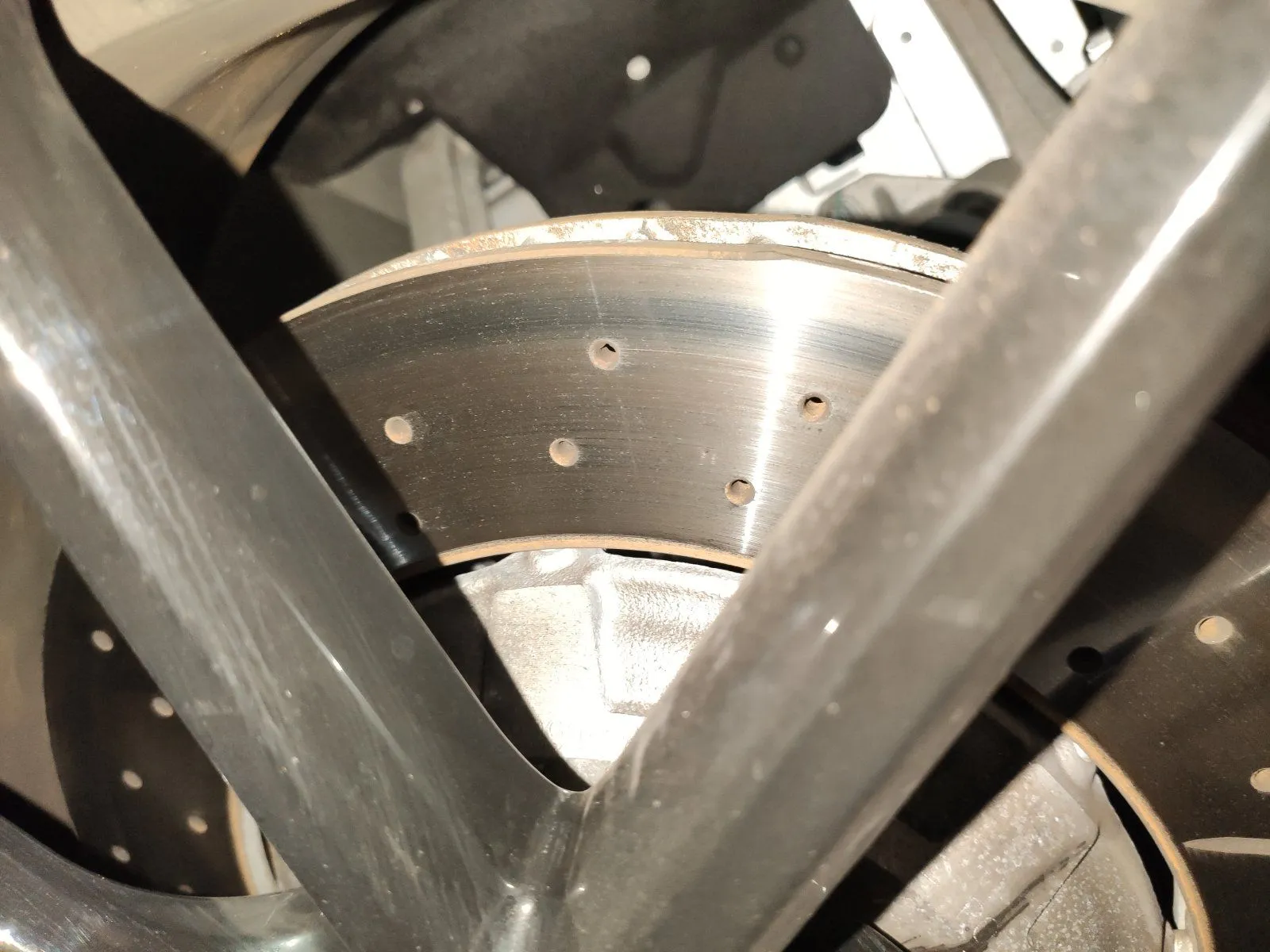

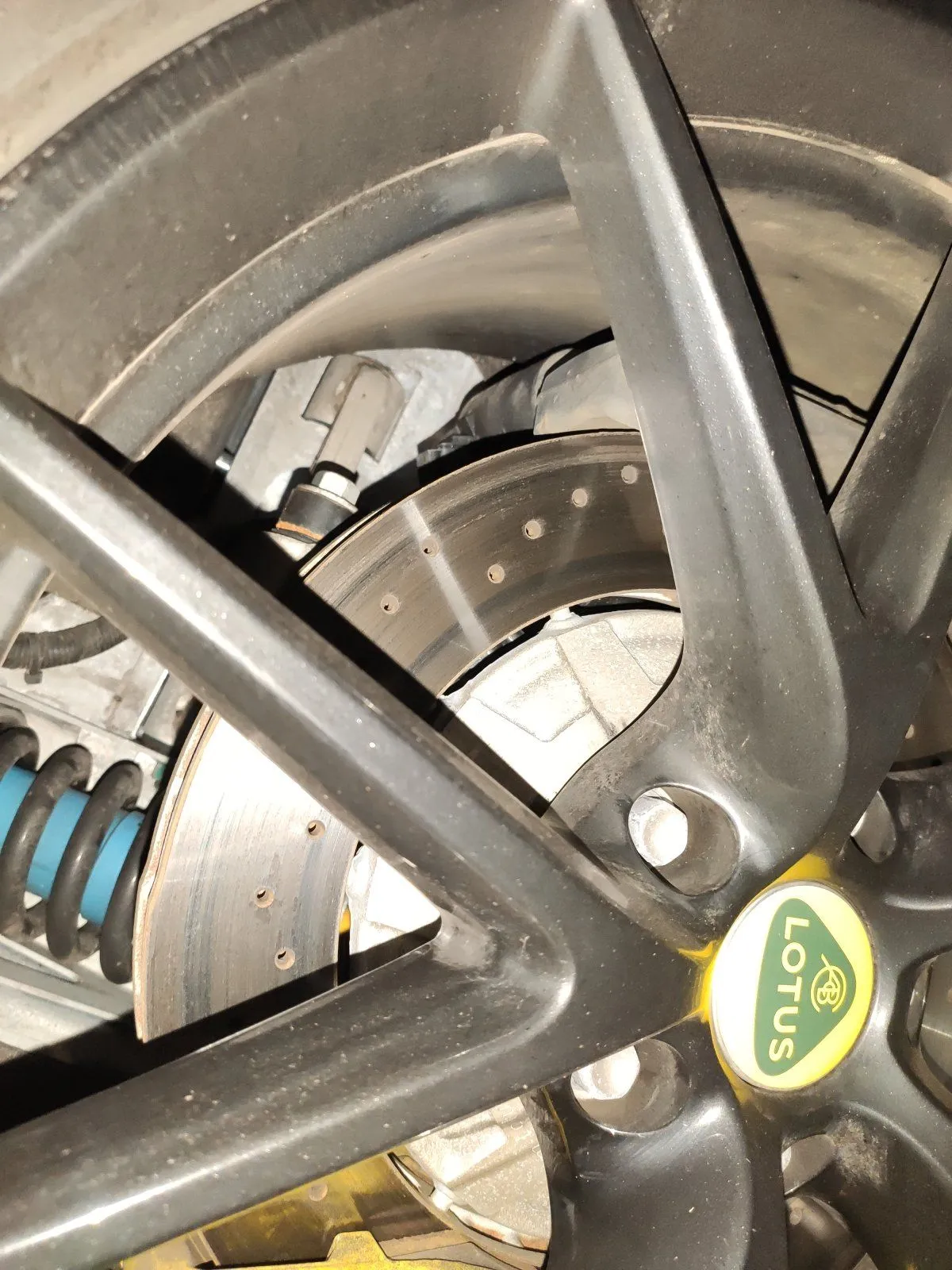

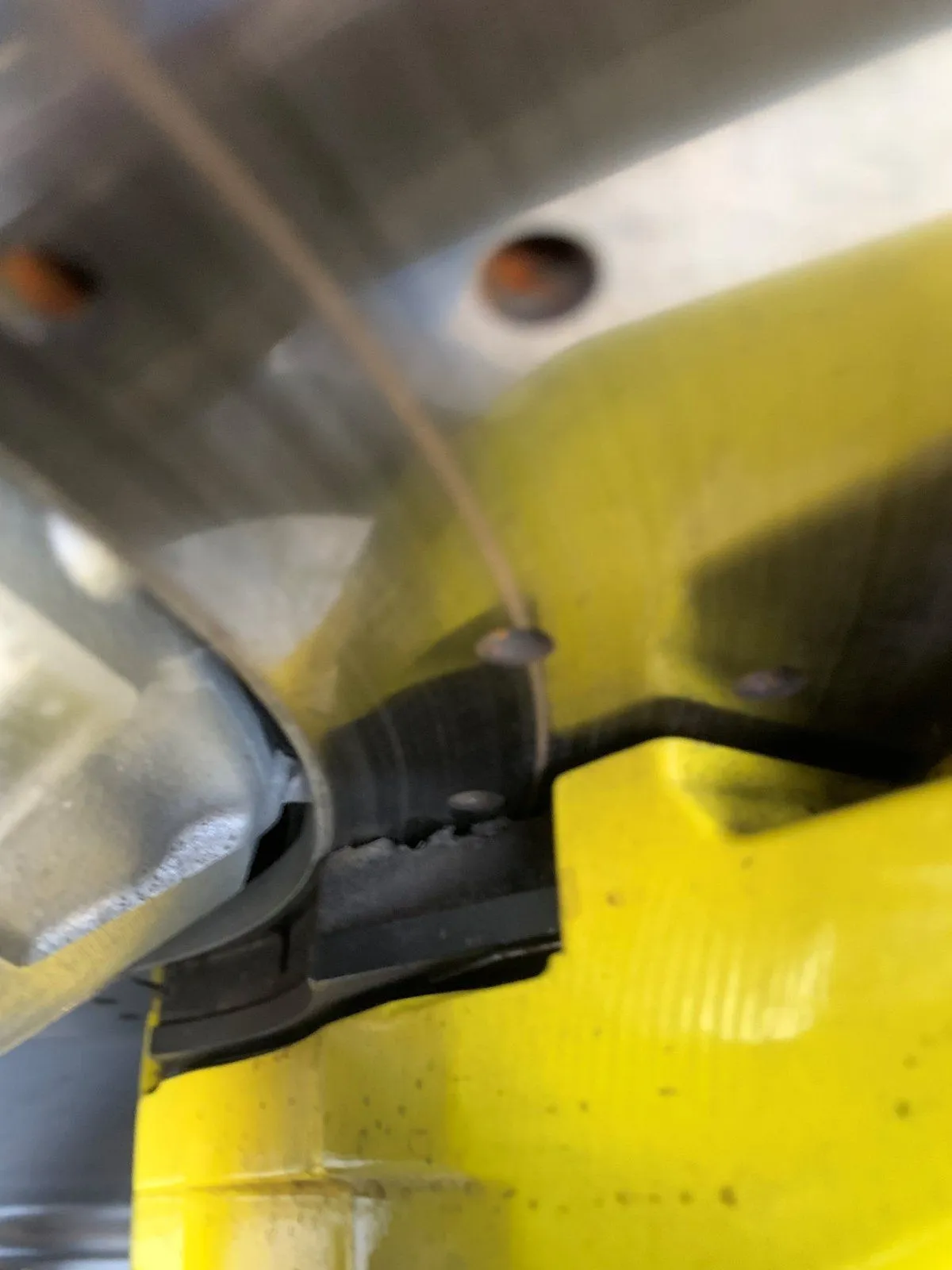

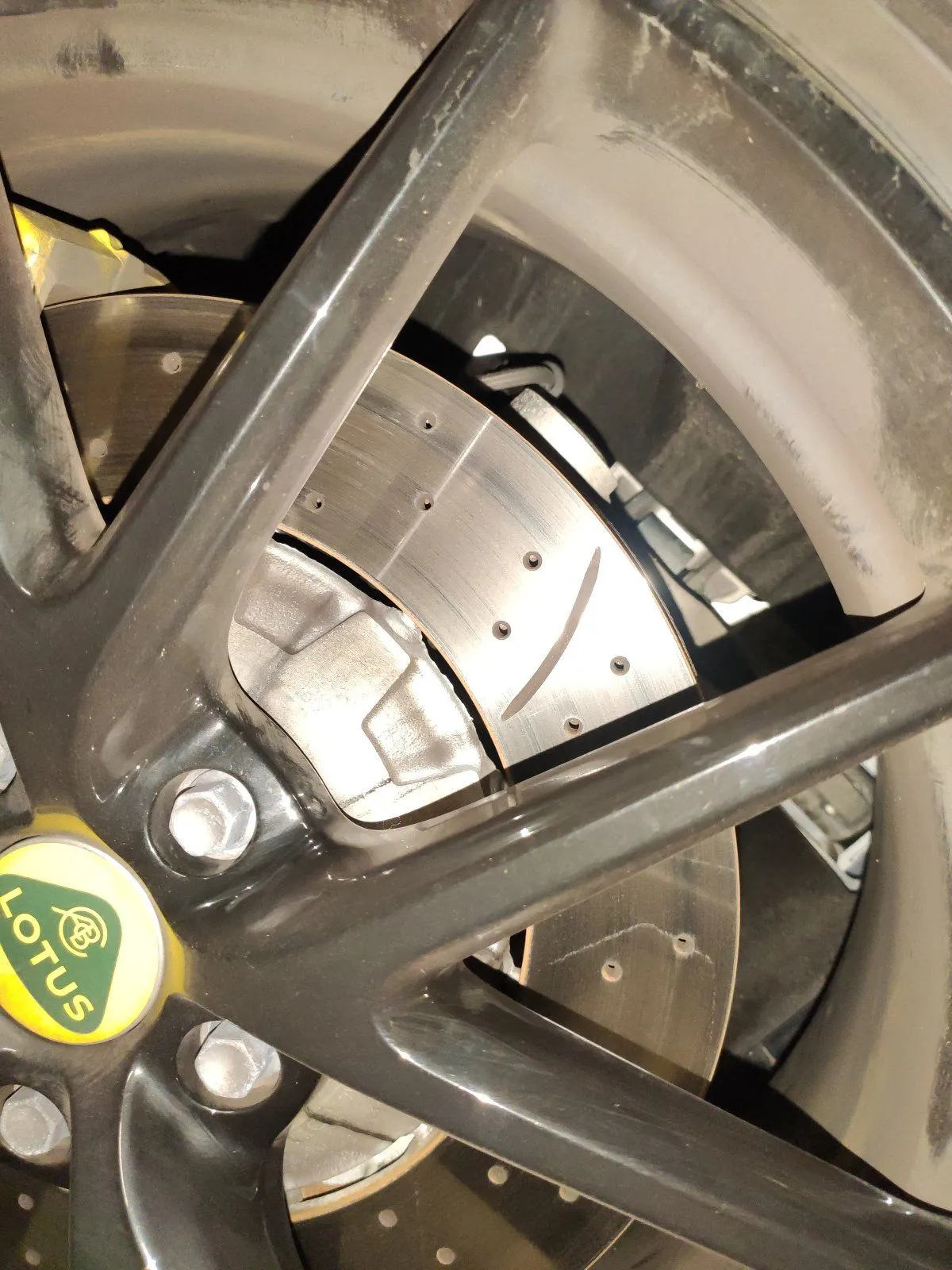

Ok, I had same problem from car collection few weeks back. Only a slight annoying squeak at v low speed rollling up to traffic lights etc. After washing car I put it away with wet discs. When I next pulled car out of garage front pads were stuck to rusty disc and a mighty bang ensured. I then found the front edge of pads have chipped off. Went back into Lotus yesterday for new pads and discs under warranty. Dealer said it was 2nd set they had replaced. He said its something to do with when car was orriginally tested by Lotus exuberrant braking causes pads not to bed properly, shards get caught between pad and discs, hence the replacment. See my pics, look very similar to yours.
