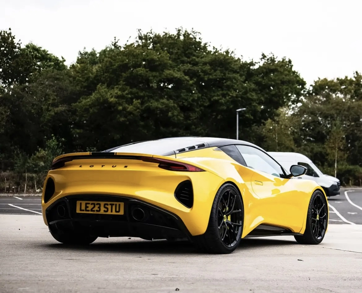

More Ferrari yellow than Lotus. Looks great though.
It’s weird that the yellow looks slightly paler in the pictures which is probably my phone camera when it’s finished I’ll do some pictures my decent camera but I’m not sure if the site will allow me to upload them.
I’m away on a work trip so can’t pick up my car until the end of next week.
Here’s some photos from the pod company. IMG_6353.jpegIMG_6352.jpegIMG_6350.jpeg IMG_6342.jpeg

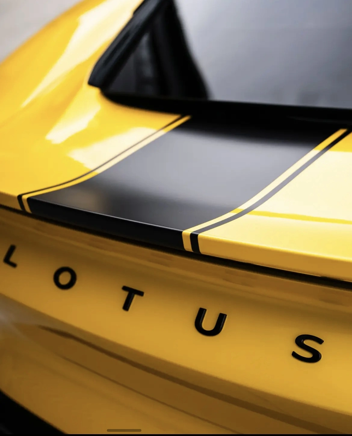

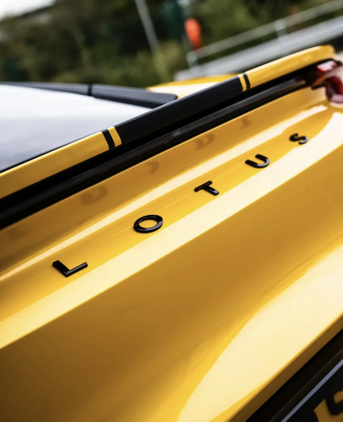

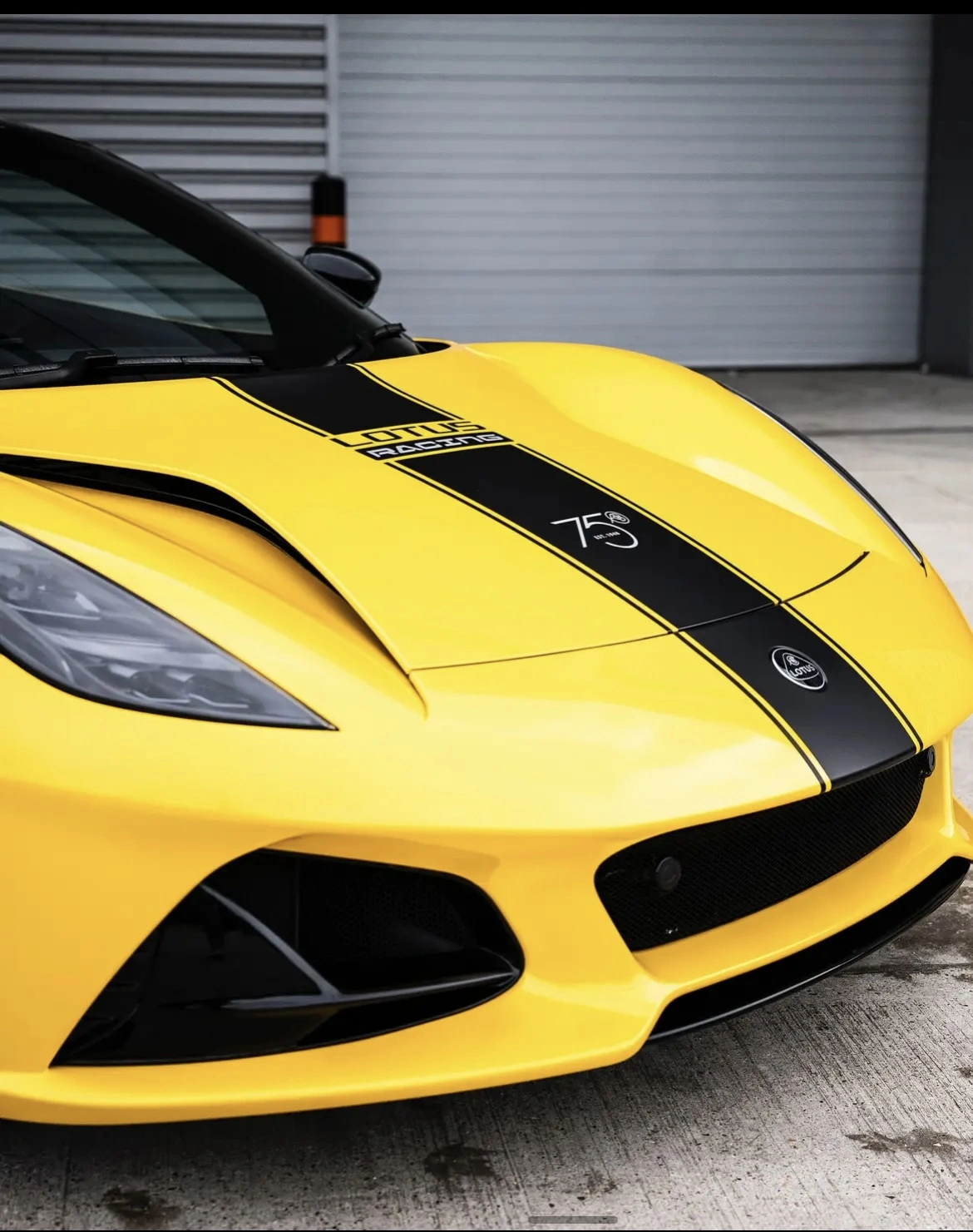

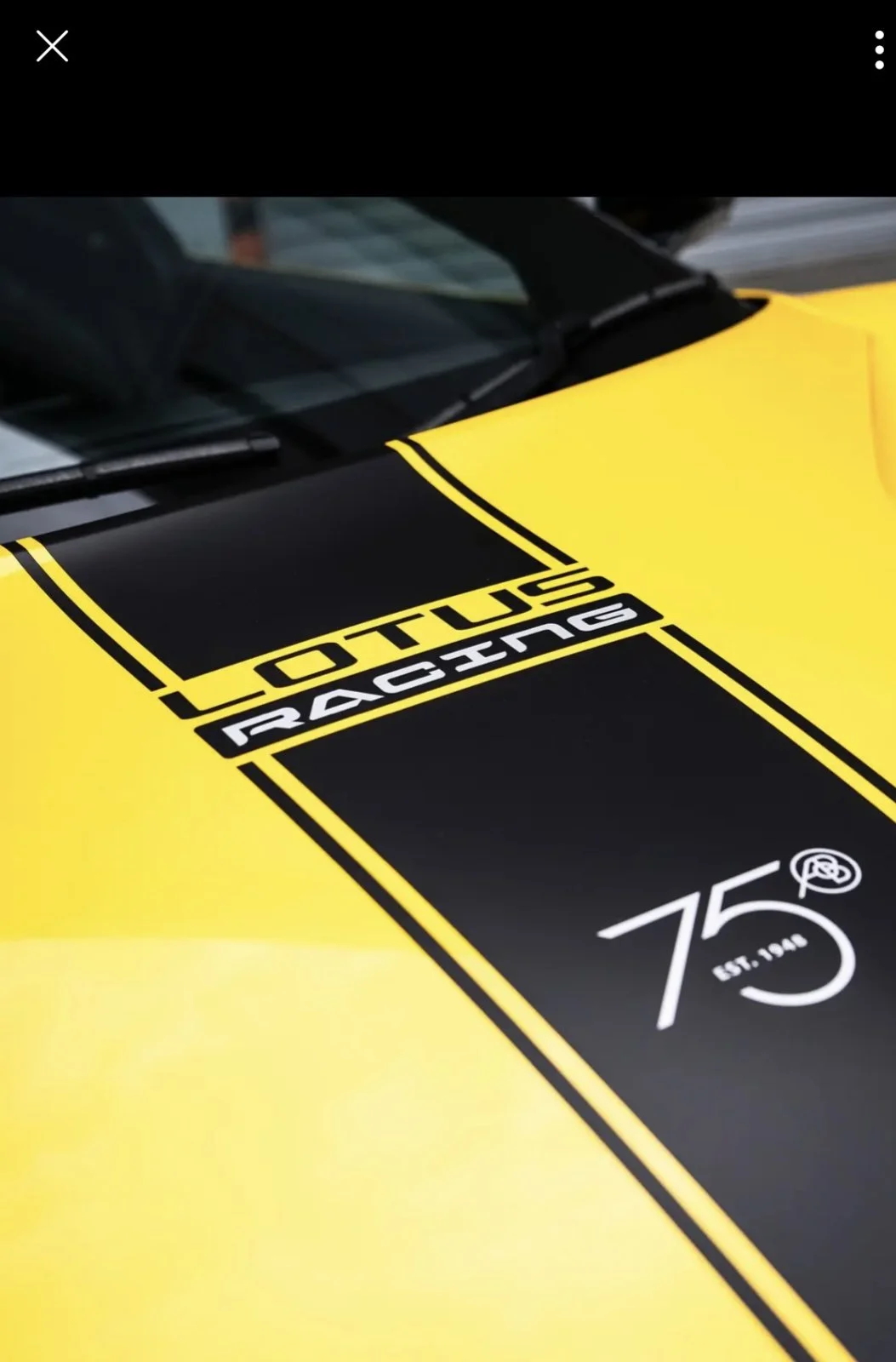

That turned out sexy. Like the choice of going matte on the stripe šŸ‘
It was the wrap company that suggested it or it wouldn’t look like there was a stripe going over the black gloss roof.

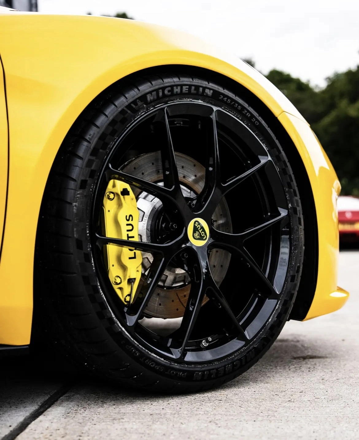

I was very impressed with the GRP 12.5mm hub centric spacers that not only give it a better stance but it also makes it look lower than the 15mm drop I did when I fitted the Nitron coil overs.
now THIS is how the car should have looked stance wise from Lotus.. This is so sweet man.. I see so many other cars that have the GRP 12mm spacers and the 15mm lower kit as well and the stance does NOT look like this at all..
Wondering what is different here....
I did change the wheels to Aerie V2 and fitted Cup 2 Connect tyres which were wider than the Goodyear tyres but on paper the same size.
