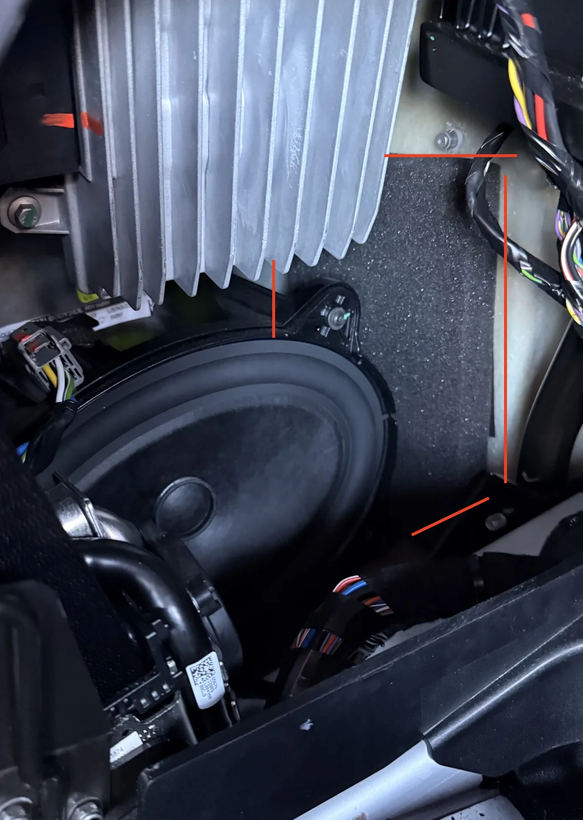

Note the foam in place. Just tested it with a high bass track. I'd say there was some improvement, but can't say it was a fix.
The vent contraption does feel fairly firmly fixed. I do wonder if removing it and then perhaps covering (mummifying) the front of it in fabric tape, would have a greater effect.
Interesting, my slapping sound literally disappeared. Have you installed a sub as well, or just the foam?

Quick update: had a 30 min drive around town earlier. certainly some noticeable improvement with the windows cracked open, especially if i nudged bass level in the Equaliser down to say -1 or -2. Previously at this level i was getting the blown speaker effect, even at just mid level volume.
So overall, an easy fix with some foam does seem to have an improving effect. But, i suspect getting a small sub for the rear deck is the proper answer.

Oh that is interesting, and I am guessing a fairly inexpensive way to solve it. Did you just disconnect the OEM sub completely (which it sounds like you did). Do it yourself or take it in to an audio shop? Did you just velcro it to the deck?
Do you find this has mostly solved the blown speaker effect when windows cracked?
Lastly, where did you manage to tuck the wiring?
I did initially, but went back in a reconnected. DId it myself, I used T-Wire taps to connect the signal wires to the sub (like other members did). I was going to de-pin and connect a new 4 wire plug, but ended up just using the taps. So as it stands, both OEM and Aftermarket sub connected, and the foam block in place produces a really enjoyable sound, and yes it solved the slapping sound (Bass set 4-5 on head unit) - now debating installing the Alpine tweeters in the a-pillars (there is a thread on this too..)
If you look back at the picture of the foam block I posted you will see the red and white wire bundles - those are the tapped sub wires.. They are all friction taped and are tucked across the bottom behind the back wall (which is easily removed with 6 bolts). The sub plug just pokes out on the bottom, between the flooring board and the back wall board, and plugs in on the bottom of the sub (which is facing the back wall, sub is installed on its side). Only other thing I did was wrap the sub in Alcantara to look a little more OEM - down firing sub, so speaker grill is facing the back wall.

Ok, so just ordered a piece if 1" thick high density polyurethane foam from amazon - £7. Aim to perhaps just put same fabric tape around the perimeter of the vent, then just cut the foam to size and just wedge it between the vent and the sub. Will report back in a few days - will it cure the blown speaker effect - i wonder.
