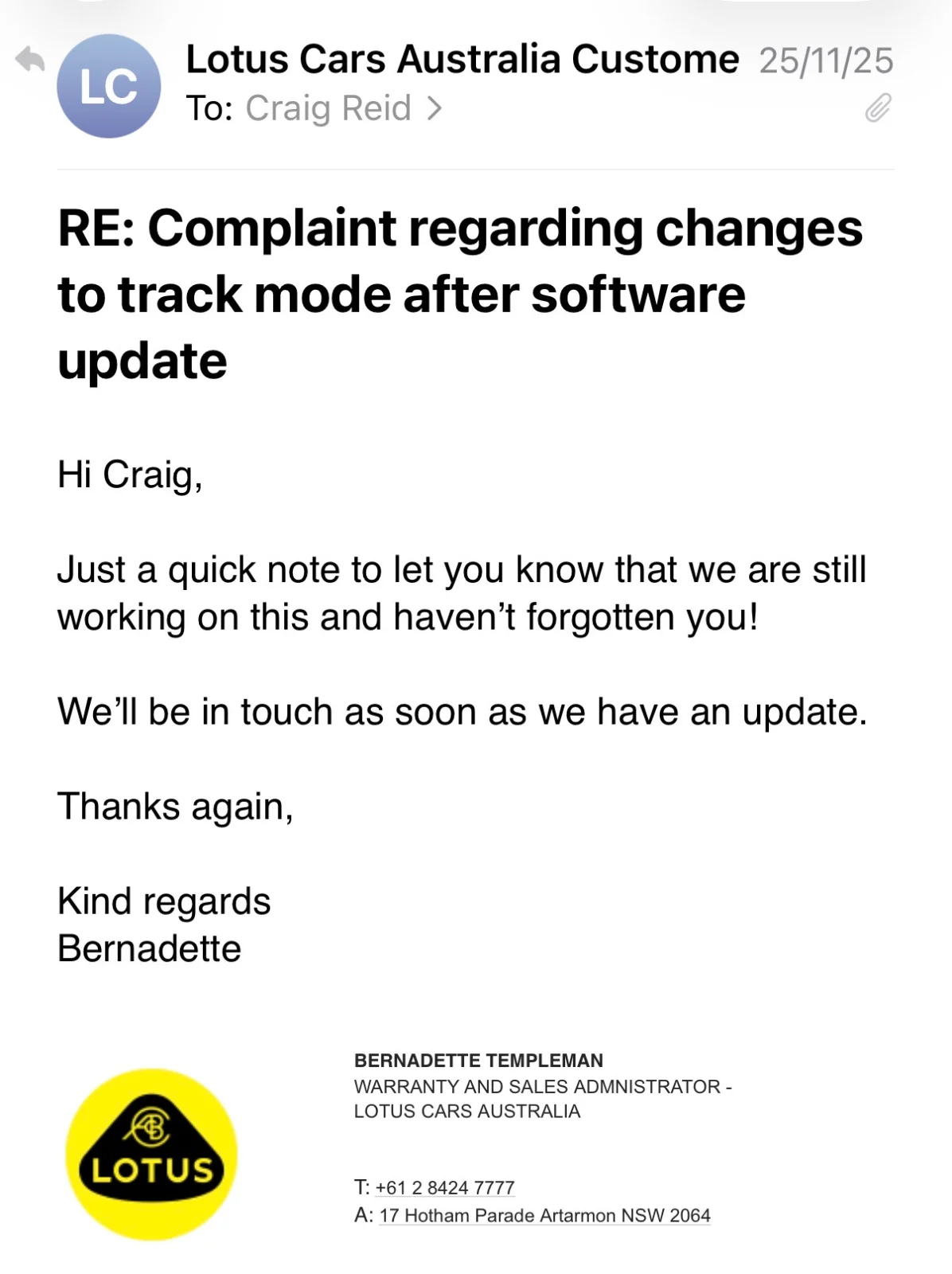

FYI I’m still waiting on a response from lotus Australia on this.
