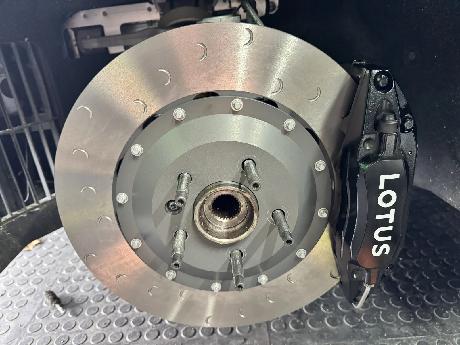

Replaced my fronts, trying to sort some rear bells at the moment.
OEM don't seem over the top with regards to price but considering they are made of cheese are not much use as brakes.
Replaced my fronts, trying to sort some rear bells at the moment. View attachment 53427
These look great, and way more suited for purpose than the stock rotor.
Did you source directly from Alcon? Or from a third party?

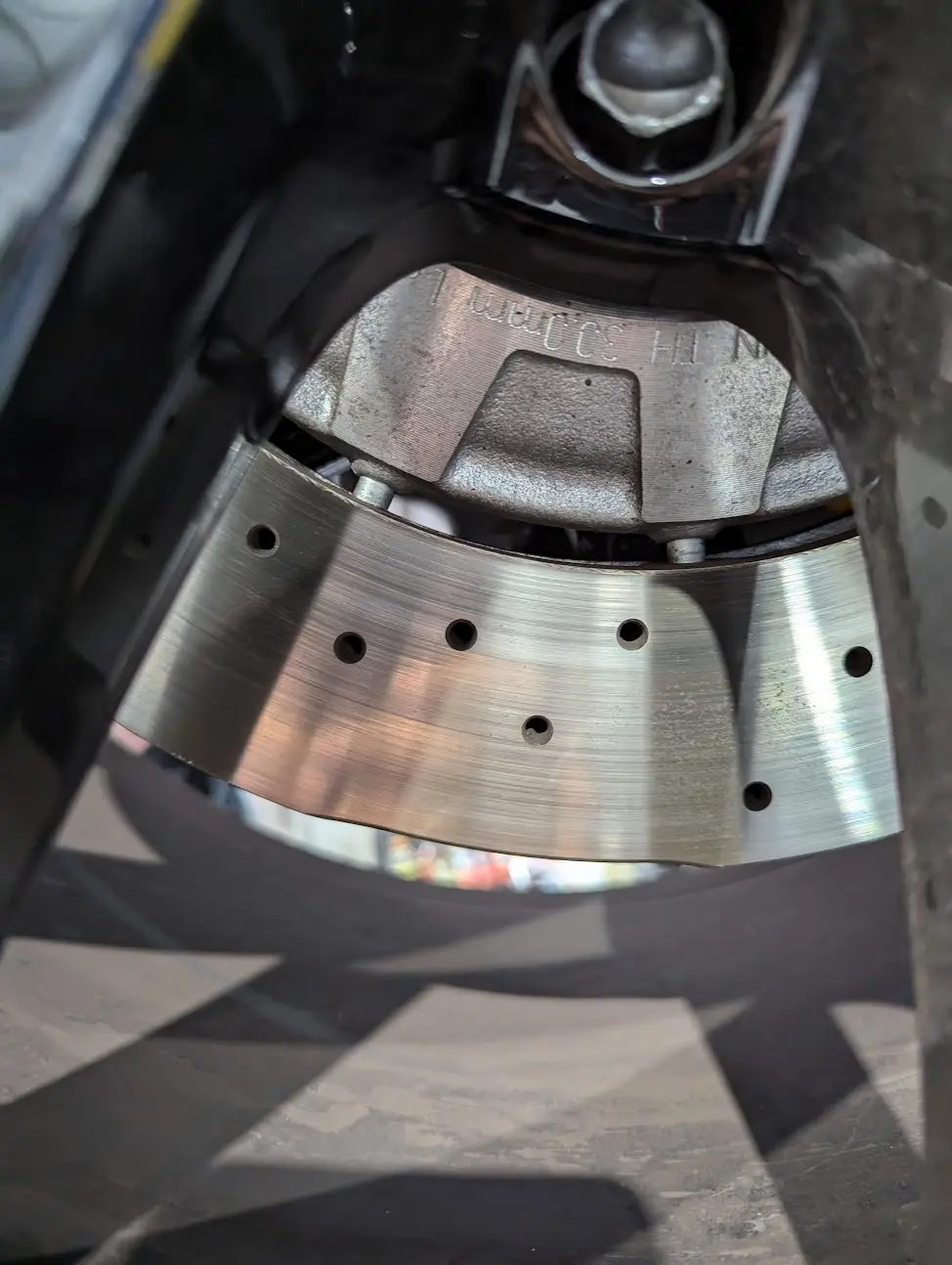

Any one else's rotors aren't perfectly round? This is in multiple places on all my rotors
These are milled off (weight correction) from "Dynamic Balancing". Weight unbalance can happen from the sand core shift during the casting process.
A good tooling/molding can minimize or avoid the weight correction, but if unavoidable the mill off should keep the disc surface intact like so.

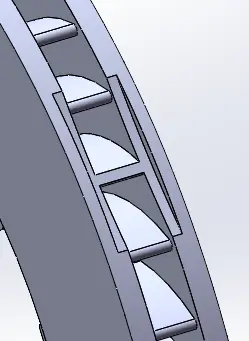

For your consideration is a 380/350 rotor kit (vs. OE 370/350)
This alternative rotor kit has a dual advantages - Replace and upgrade to BBK at the same time, your Emira brake will have the same rotor size as Porsche 997.2 stock.

These are fully floating right? How bad is the rattle at low speeds? Also, have you heard of any progress regarding the rears?
