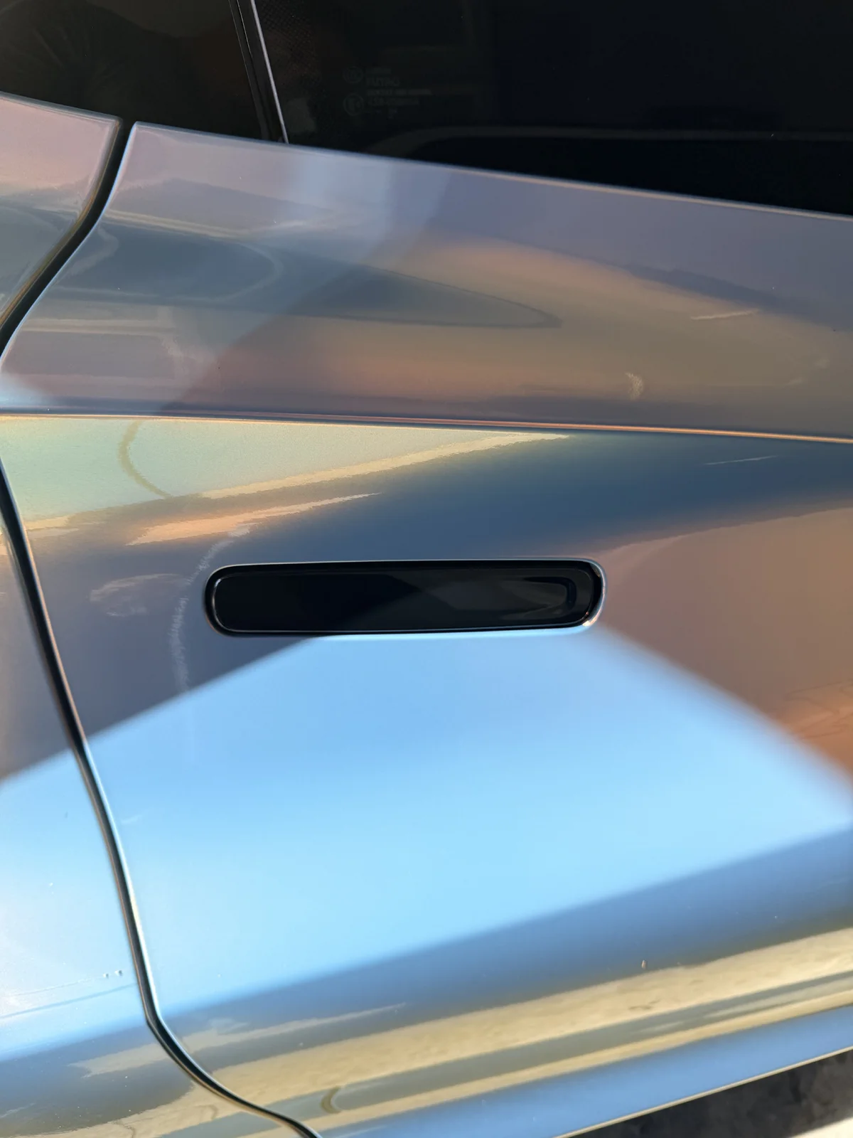

One thing to note for others, if you've landed here because your handle spring broke and not because someone vandalized your car. This video's missing part is how to separate the outer door handle (body color) from the broken inner door handle. You'll need to remove the screw in the back and then you'll need to use a trim tool to wedge between the two halves to get it to unclip -- then you can re-use the outer door handle trim.
Super clear video on removal and reinstall, wish I had this when I did mine.
Good catch. Got them back on today.
