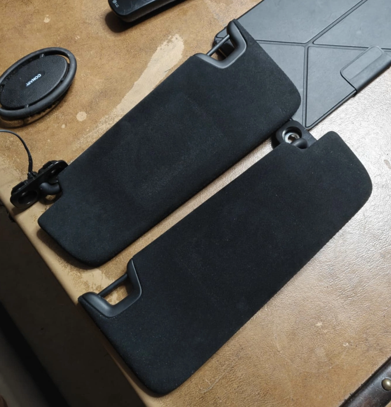

Interesting, I had gotten mine off a while back, but it took me hours and there is still a slight residue. I honestly thought I was going to ruin the Alcantara, but that stuff is tough. The U.S. stickers have been much harder to remove.
Did you receive your car recently? Yous should post some pictures.
Yes just picked it up 2 weeks ago. It did take a little finesse but I was super pleased that there was zero residue.

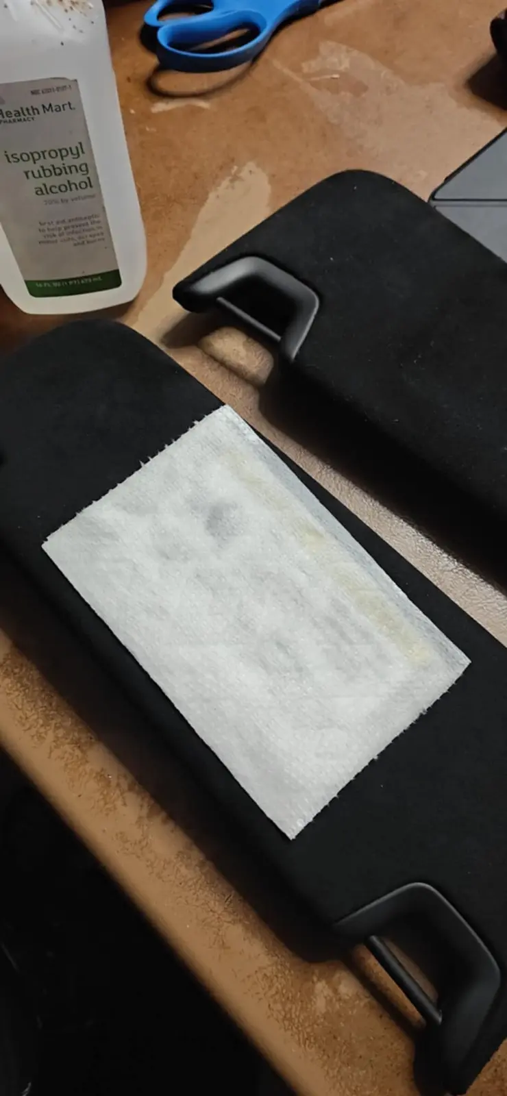

What was the exact method you used with the rubbing alcohol?

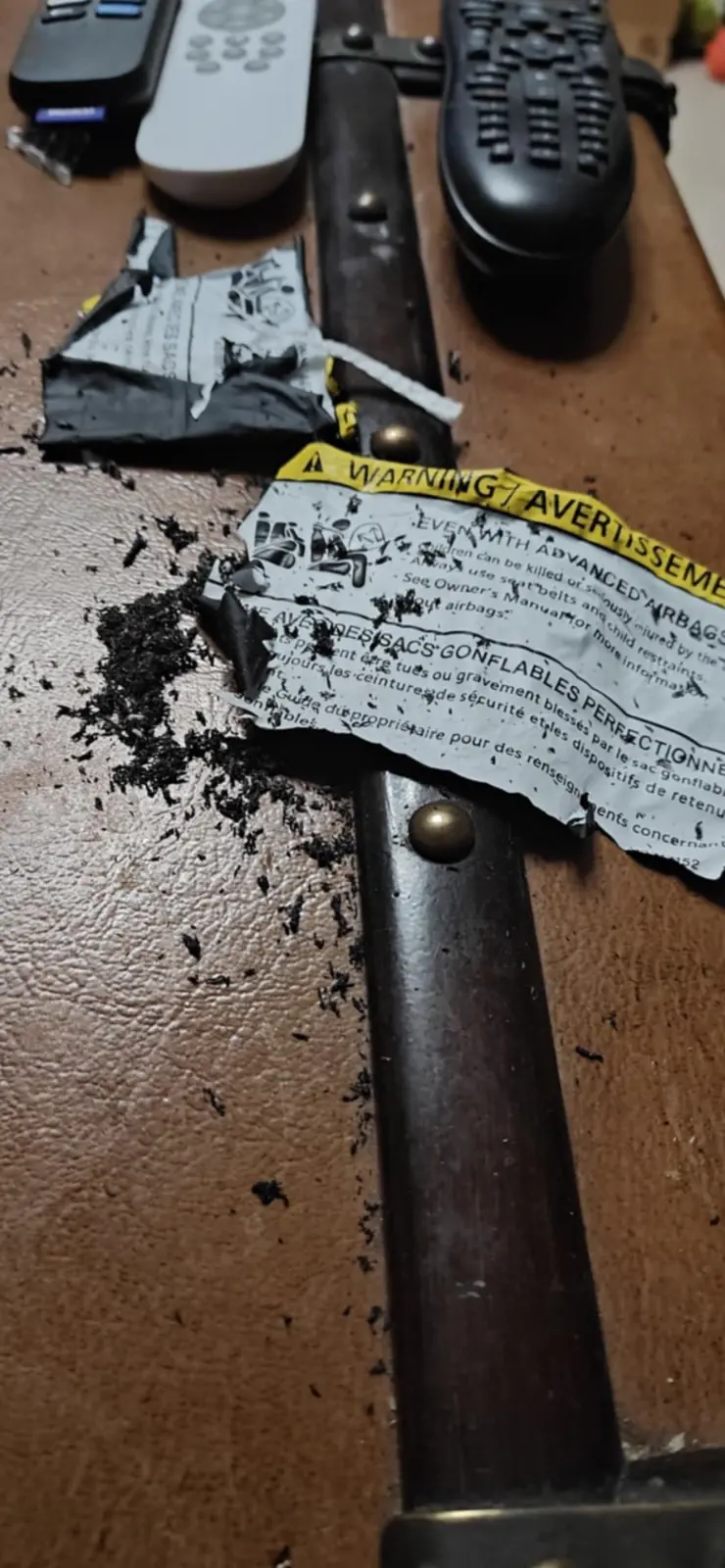

I drenched rubbing alcohol on a 2ply paper towel and held up to the sticker for 3-5 minutes. Then I got a pair of tweezers and started trying to pull up the corner. It took a while but when I was able to pull it up, big chunks came off and it left zero residue. I feel like that if you hold the drenched paper towel too long it will leave residue.
And I just kept repeating till the entire sticker was removed

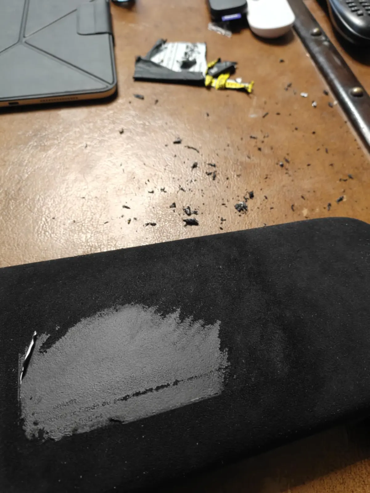

Removal can be done on US visor stickers. I soaked sticker with rubbing alcohol papertowel for about 15-20 minutes. Sticker was relatively easy to remove. Left residual adhesive but using my finger(nail) in alcohol paper towel, i was able to remove adhesive. End result looked good enough as cabin is pretty dark so would be hard to see any residual rectangle. I might try picking up some alcanatara cleaner from Amazon and brush it up but will be good for now. 😊

Yep....pretty much the process I've used on Pcars in the past. Nice job.
View attachment 61851Removal can be done on US visor stickers. I soaked sticker with rubbing alcohol papertowel for about 15-20 minutes. Sticker was relatively easy to remove. Left residual adhesive but using my finger(nail) in alcohol paper towel, i was able to remove adhesive. End result looked good enough as cabin is pretty dark so would be hard to see any residual rectangle. I might try picking up some alcanatara cleaner from Amazon and brush it up but will be good for now. 😊
That does look good and similar to how mine turned out, however mine took hours to remove, and I used to rubbing alcohol, and then tried denatured alcohol. I even bagged mine for a while to let it soak in. The stickers were not affected at all by just soaking them for a while. I have done that with other cars in the past (Porsche) and they did come right off.
If your car is new, or recently acquired, then something has changed on the newer visors here in the U.S. Good thing if so.
