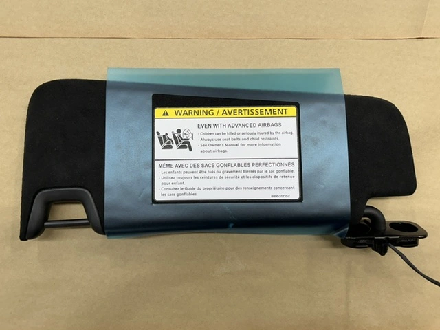

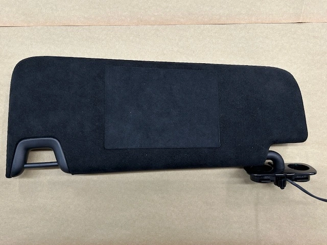

So I finally got around to doing mine.
Had some patches laser cut out of Alcantara, and cut also cut a masking template using a Cricut so I could get a 2-sided bond without any overspray.
Thanks again for all the info in this thread!
Looks much better, can I ask where you had the alcantara patches laser cut? Cost? Did you use the 3M 77 adhesive mentioned previously in the thread?
I had a local sign making shop cut my material from my files drawn with AutoCAD. I wouldn’t recommend them and would look elsewhere unfortunately.
Yes, I used 3M 77 on both sides and it worked great.

Not a bad idea, but actually I’ve been surprised of how the alcantara patch over the stickers makes the visors so unnoticeable.
Given the light level in the cabin and the texture of the Alcantara, they really do just go away… Super nice to not have the distracting patch overhead!
Probably the only real solution here is to have a trim shop recover them, but I didn’t want to drop that much coin.
