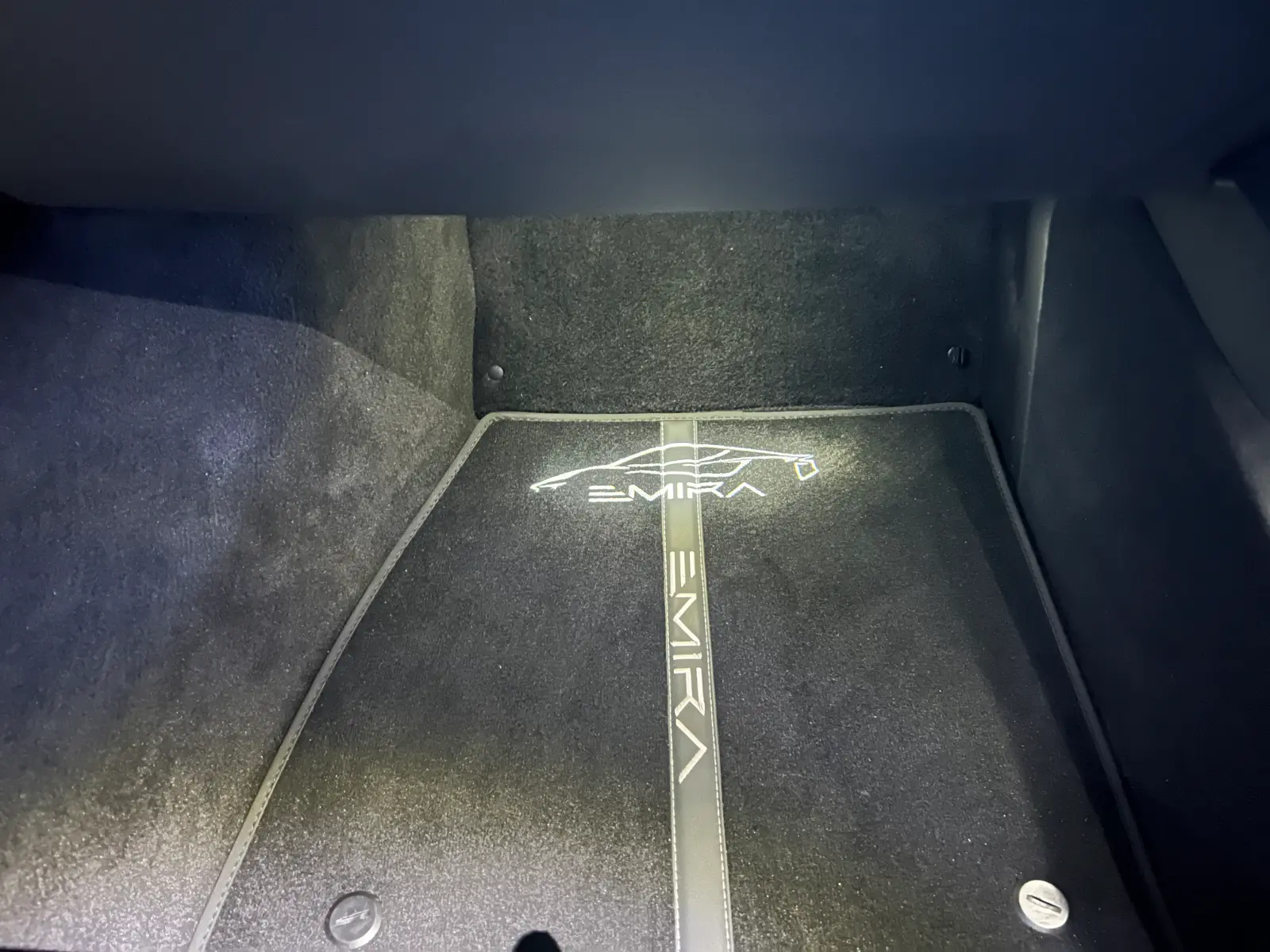

Noticed that the footwell lights are the same fitting as the puddle lights so…
Can’t decide if it’s the best or worst mod I’ve ever done!

The rear headlining, glovebox and boot lights are also the same fitting, so we could have fancy leds to illuminate our gloves too.

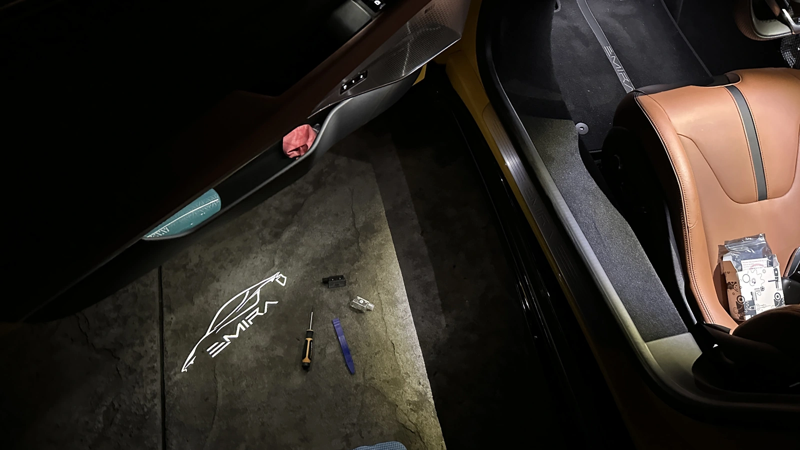

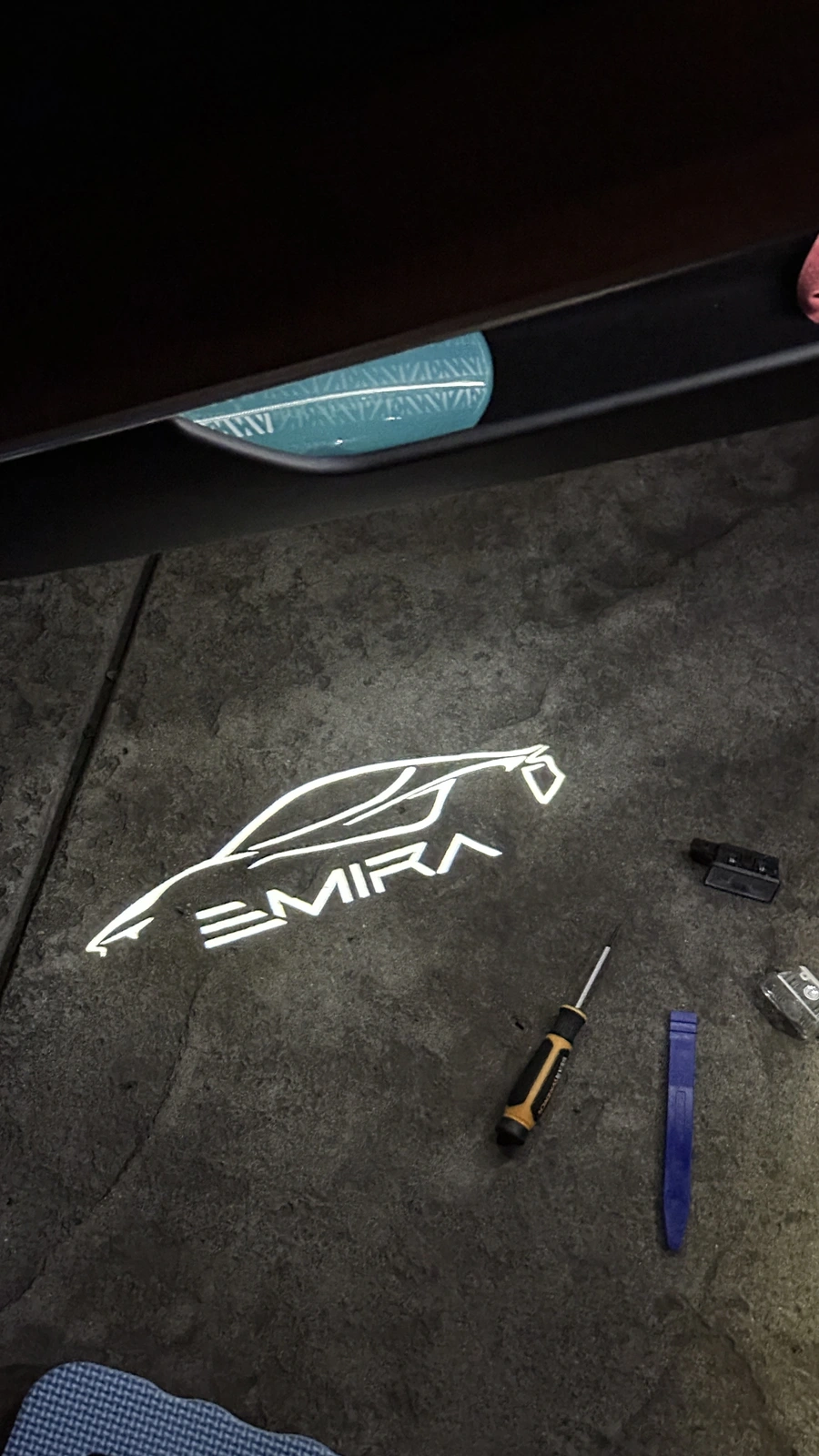

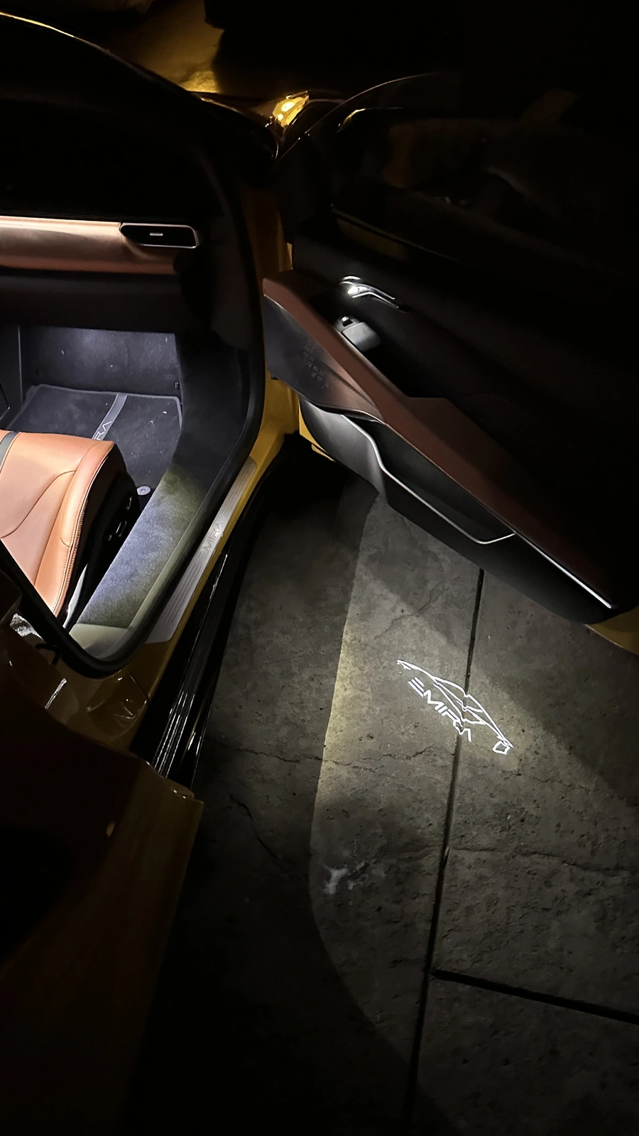

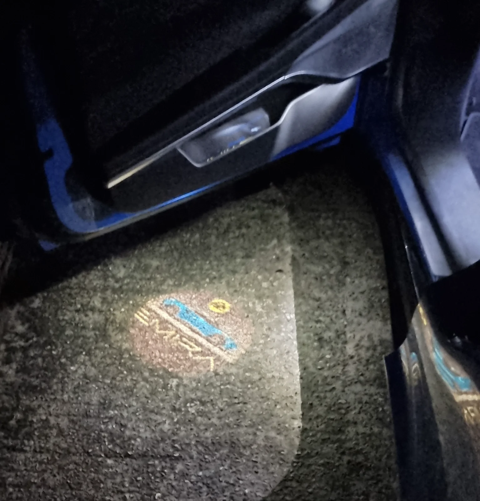

OK sorry for the late reply @RyanGphoto , but these took forever to show up in my mailbox. Here's a fresh link to where I got them (It's variant "Emira Car"):
Despite the long wait, I'm thrilled with the product. Super sharp, bright and clear image (my driveway is textured concreted so no the ideal surface to judge)

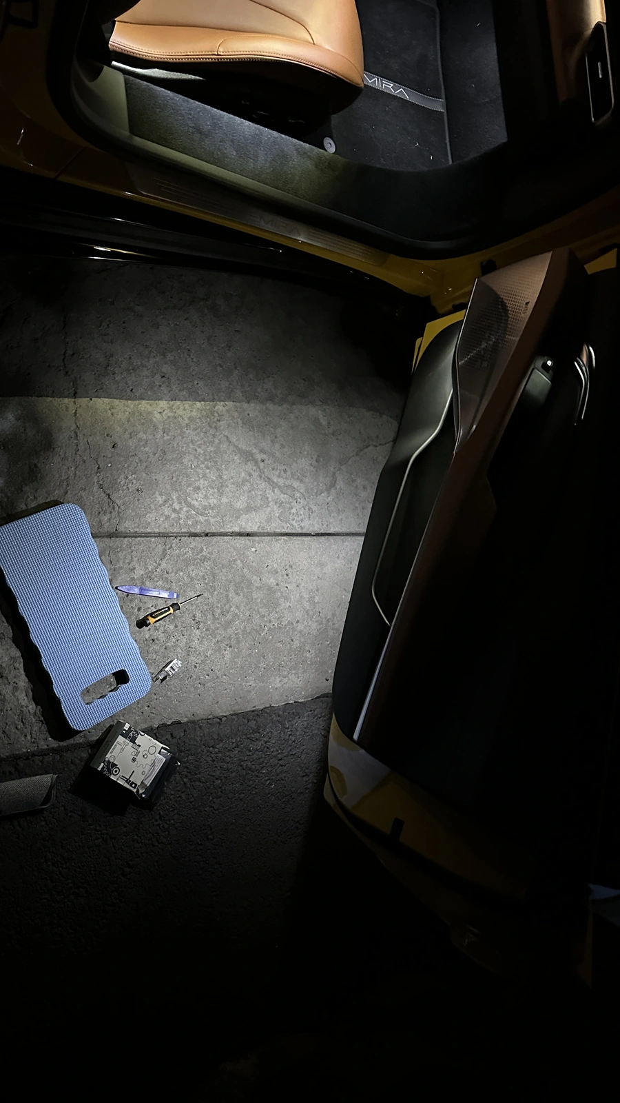

Install is super easy - just pry the original out with a small strong flathead, or two. I used a trim tool plus a screwdriver.
Only tiny issue is the parts have "L" and "R" stickers on them which I quickly found were backwards.
The only instructions on the box were "please do not post pictures in comments/reviews", which is hilarious as it means these are unlicensed and they don't want the manufacturer coming after them.
Before, during & after photos:

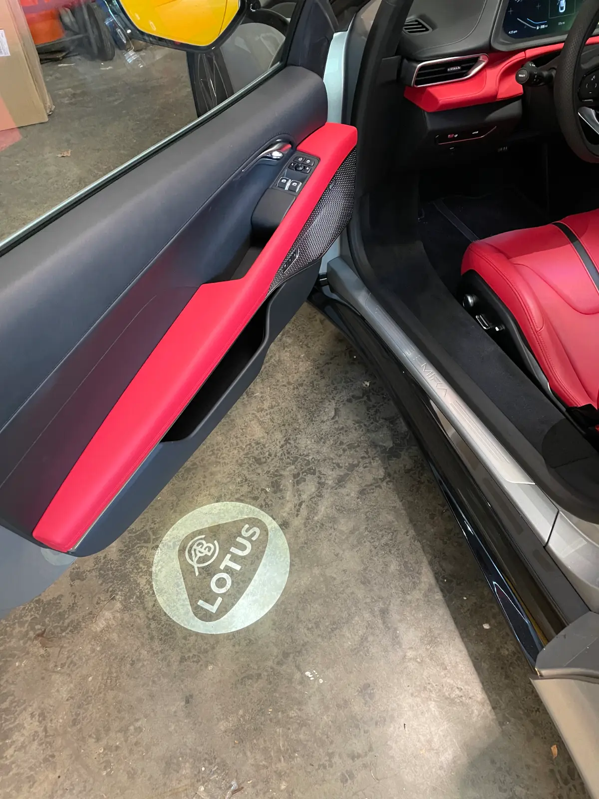

I've just got some made up in full colour
How’d you pull this off?
I put the picture together in Photoshop, for the template, then found someone who could make the lens film. We tried to find a puddle light from another car that was the same size. We ended up with one from a Volvo. This was a perfect size for the outside but the inside was smaller. Made do with some gummy tape for now. I'm hoping to find a light that is the right size, just finding one is the problem, must of been taken of another car knowing Lotus. If anyone else would be interested, and I do find a clone, I can then get the lens film made to order.
