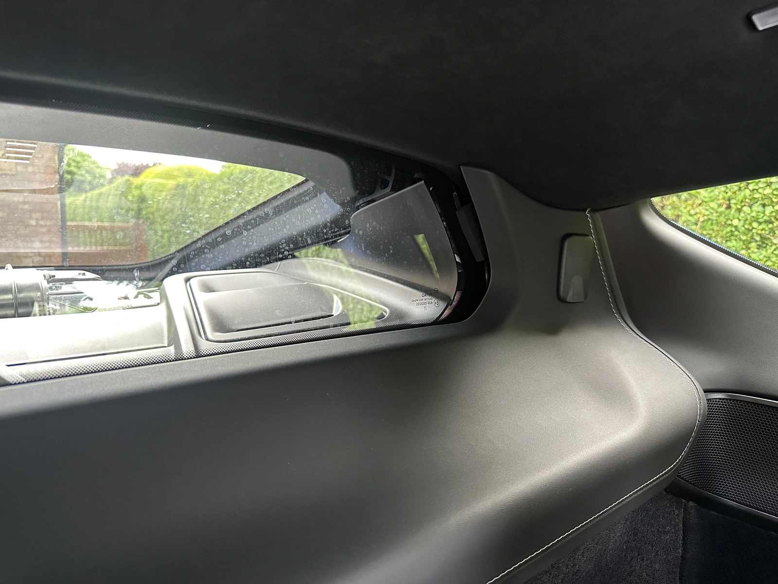

Hi,
I've just noticed that rear trim panel that fits around and under the rear window (as per picture) isn't fixed in properly on one side (the other is fine) and has a large gap, through which you can see the piece of foam that I imagine the trim should press against. I've had a feel behind the panel, but can't work out where / what clips are, or should be there to fix it back. Before I move up the destruction level, can anyone help and shine any light on how the panel should be clipped in and where to apply pressure to do so.
I've had a look though other threads and found similar issues, but didn't find anything specific to how it should be fitted.

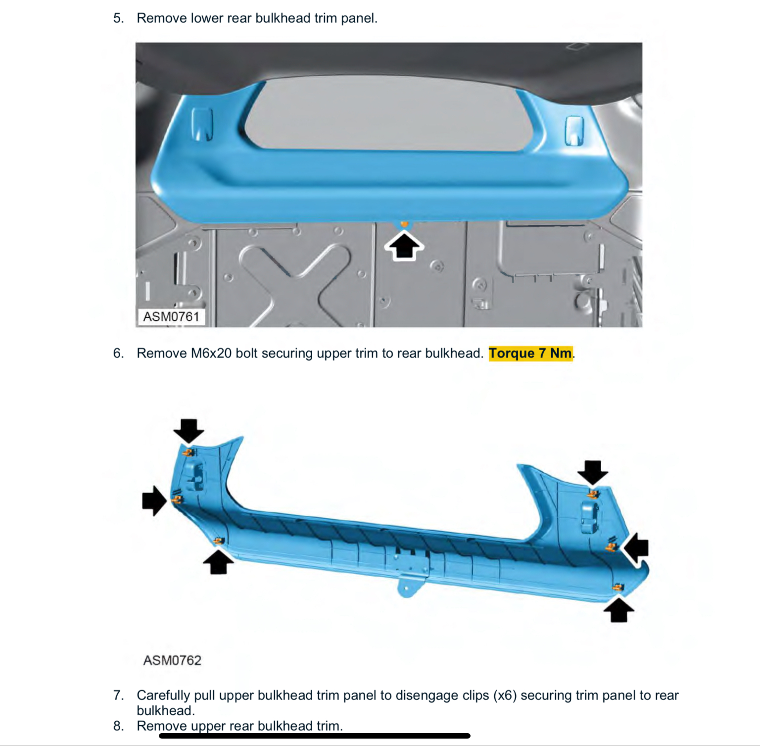

Here you go: page 15-9 from the Emira service manual.
Thanks so much, really helpful and just what i needed (y)(y)
