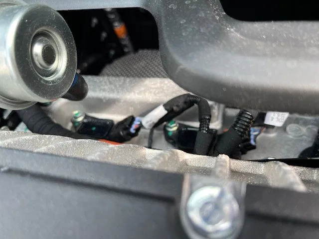

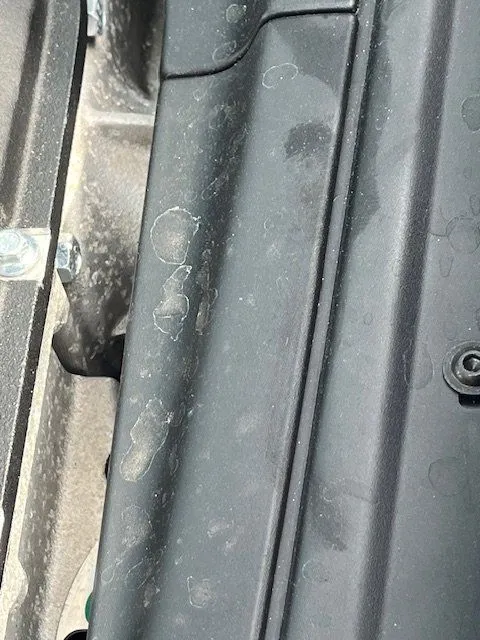

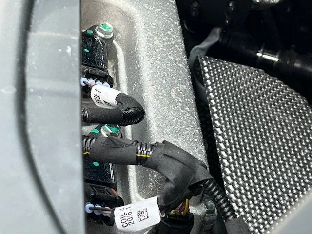

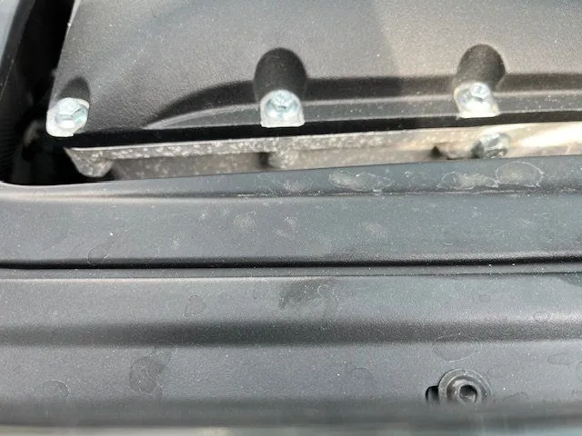

Had my Emira shipped to me. NJ to Maryland yesterday. Question One: Engine block, manifold and other aluminum parts are "Pitted" Do i have a complaint? Should I care?
This is a brand new car.
Also no battery maintainer, should this have been installed by the dealer?
Thanks

Welcome to the salt air effect. They sit a a lot waiting to shipped and once unloaded get another batch of salt air when they arrive. Doubt the area or container they were transported in were airtight. Ours was delivered in the same condition. You can, like we did apply Boesheild T9 to everything. Goes on as a fluid and after a couple of days it turns waxy. Was developed to preserve military aircraft on aircraft carriers have used it for decades in the marine world. It will kill the corrosion pits and stabilize the surface. By the way, my wife’s Jeep was delivered in the middle of winter, the transporter obviously was on salted roads and the frame and aluminum parts were coated much like the Emira. A couple of cans of T9 and the problem was solved

Normal aluminum surface corrosion when exposed to air and water. I neutralized mine with ACF-50.
I have older cars that don’t look like this. I am asking if this is some thing that the dealer should take care of. I am 190 miles away
At this point the “damage” is cosmetic, aluminum is actually a very reactive metal. As the prior poster mentioned ACF-50 is also another good option to neutralize this surface corrosion. I maintain, restore and fly WW II fighters and bombers for a living so I’m familiar with long term preservation of aluminum. I prefer T9 as it eventually dries into a waxy condition, but either will work.
