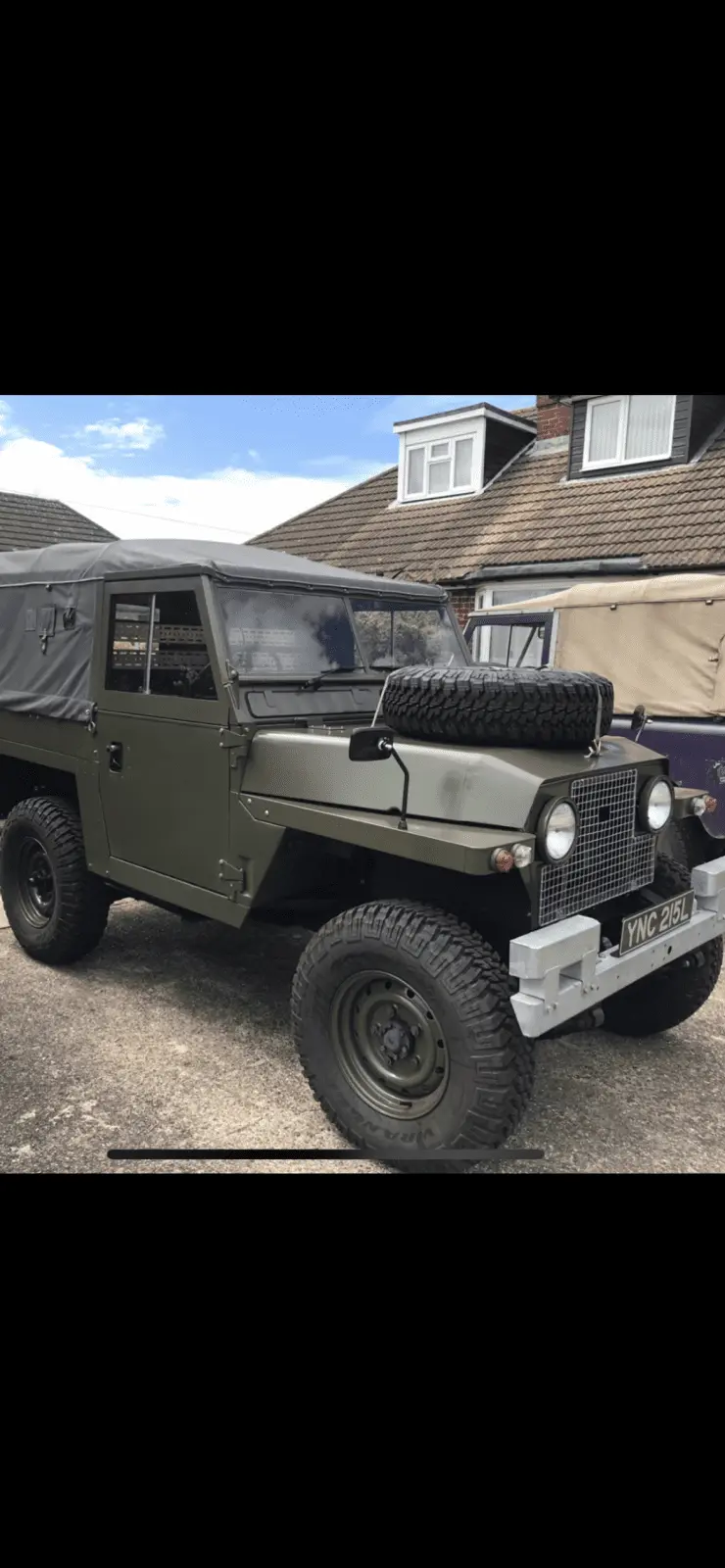

A Leaf sprung Army lightweight LR?
You're clinically insane!
Sorry, but anything you say moving forward, will have to be ignored.
Pretty reliable after a nut and bolt rebuild but slightly less aerodynamic than the Emira. 😁 IMG_5297.png
